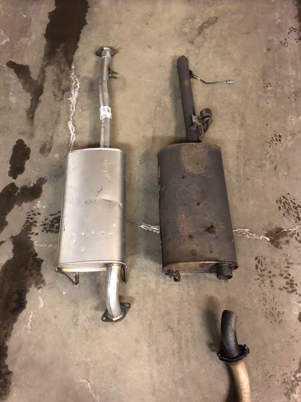

I'm halfway through putting this WALKER USA 18901 in. Will report back once I'm all done. Cost me $140.

It’s just 4 flange bolts and two gaskets. This is the easiest exhaust I’ve ever worked on.
