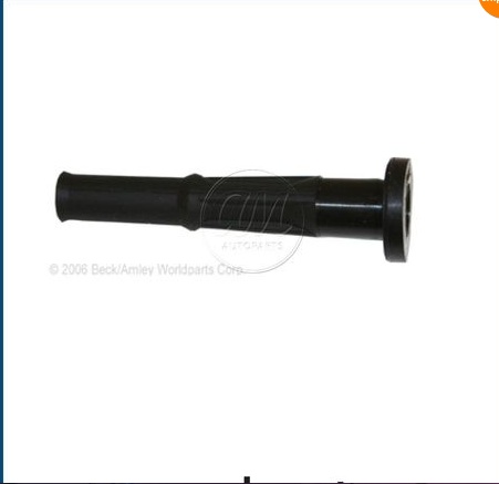

So my question is when replacing the ignition coil do I just get a new spark plug boot only or do I have to buy the whole ignition coil. Do the whole ignition coil is bad or is it just the spark plug boot if I can avoid buying the whole ignition coil that would great since I'm low on cash due to the holiday. I hope someone that has replace ignition coil will shine in.

Spark plug boot and ignition coil image:

I replaced the plug wires on my truck and they came with the boots (the first pic I see)- your second pic is of the coil pack (at least on my phone).
New wires will include new boots. The coil packs will probably not come with the boots as those are usually included with the wires.
