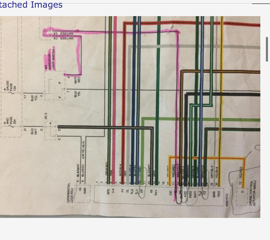

Seems like a relay was used to connect a select few wires from the harness that went into the 4wd computer? Can I just use an Amazon relay? Specific amount of pins/wires?
The wires that were circled seem like the wires I need to tap into: v2(green/red), v4(light green), ADD (black/blue), ind1(green/black), ind2(green/white), can’t read last one (brown/yellow).

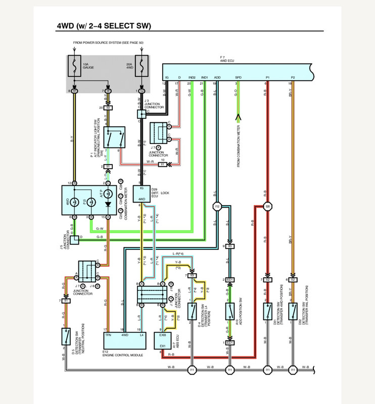

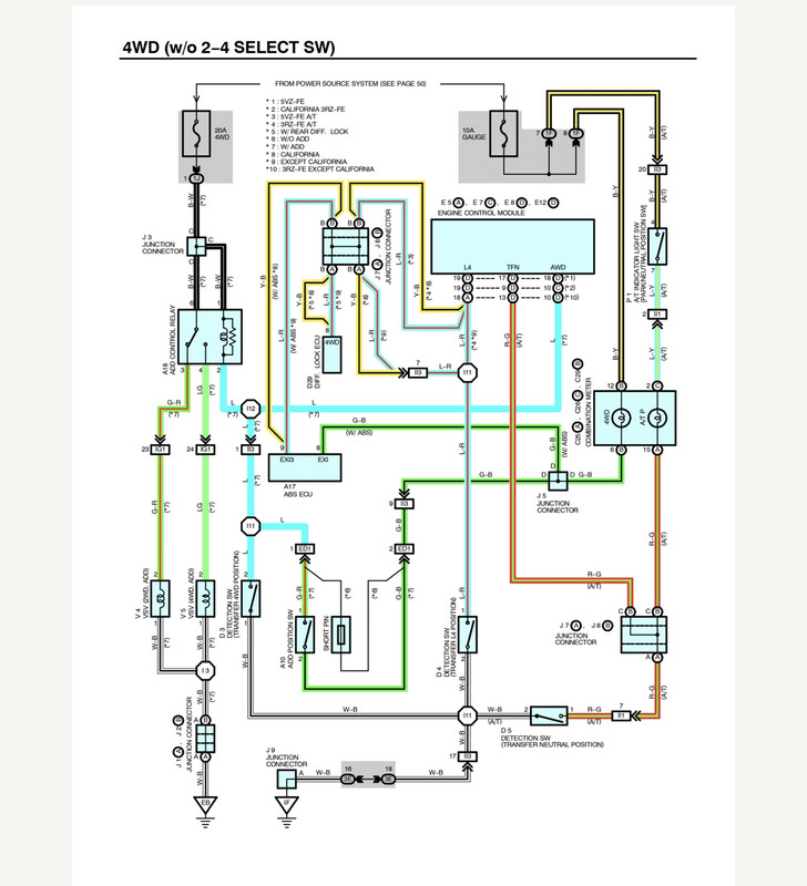

Good to know about the relays, looking at the diagram for the 2000 manual 4wd should show what kind of relay it was maybe? If you get around to it I’d be forever grateful and maybe make a Timmy the toolman video with it and give you a shout out haha. If not no worries I’ll figure it out somehow. 2000, 5vzfe, limited automatic, originally had multi mode push button jshift tcase changed to standard jshift tcase. These are the diagrams I was able to find online without paying for anything.
Edit: now I’m thinking if I want it to work 100% perfectly OEM I should buy the oem relay with a pigtail.
I think this is the jshift tcase diagram
I think this is the multimode tcase diagram

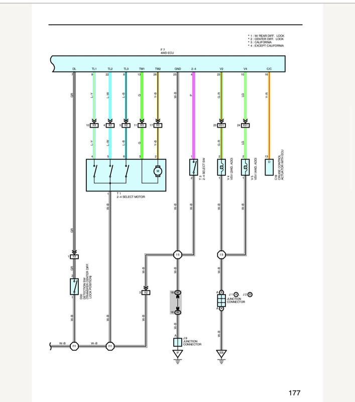

Yes, though you are missing the second page of the multimode setup.

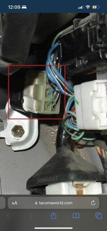

Well I just ordered a used ADD relay off eBay, no pigtail though. Just going to use female spade connectors with heat shrink all the way to the tip until I can get a pigtail. I have a picture of a few of the wires coming out the back of one installed in a vehicle, also have a friend who has one in his truck. So hopefully I can figure out the wiring pretty easily. What wire would need to be ran from the engine bay, I don’t mind running wires.

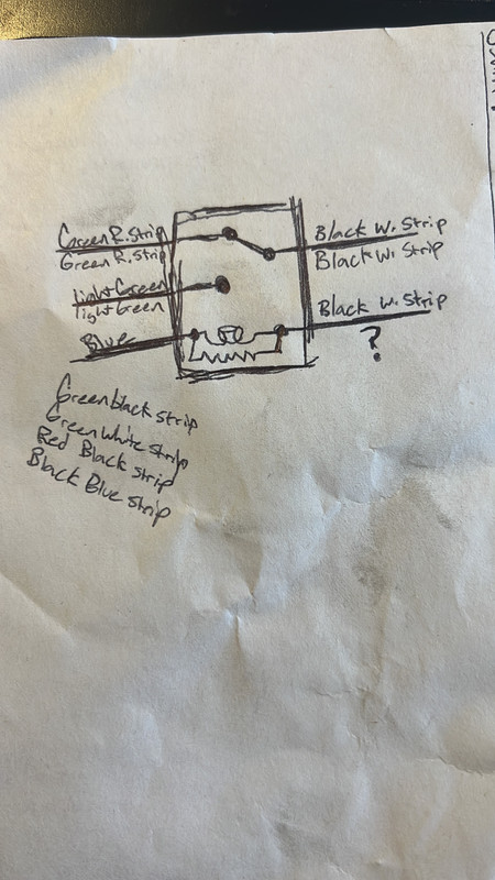

Seems there are 5 wires coming out of this relay. 2x black w/white strip, green w/ red strip, light green, blue.
I have 1x black w/ white strip, green w/red stripe, light green.
Do I split the black w/ white strip into 2x? Seems like maybe use the black w/blue strip in place of the blue?
Don’t make fun of my hand writing haha.. Last 2 questions I have are do I just split the black white strip wire into 2? Do I need to hook up the brown yellow strip wire at all? Seems like it’s the LO indicator switch.
Hopefully this seems correct

Alrighty I think I got it figured out. Had to use a cheapo Amazon relay for now. I also found the missing page which was exactly what I needed lol.
So I’m using these wires: grey, green w/ red strip, light green, green w/black strip, green w/white strip, black w/ white strip, and black w/ blue strip.
