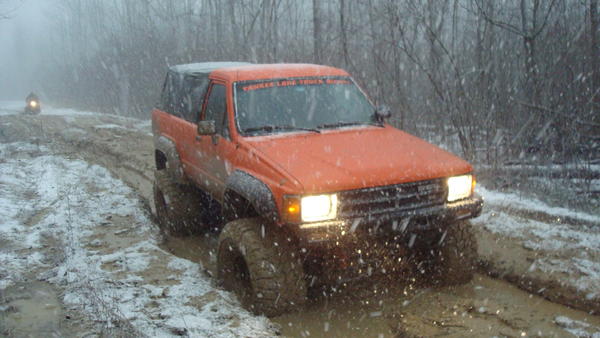

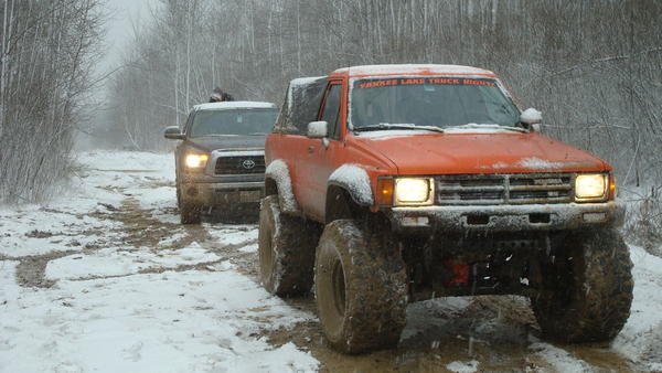

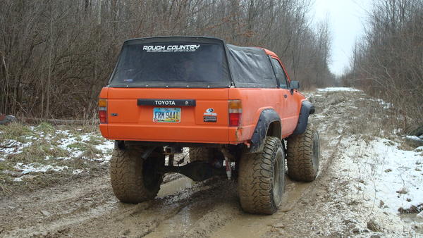

I ended up selling my tires and rims about 6 months later for exactly what I got them for  and got some 33x12.5r15 Pro Comp Xterrain tires on the same rims.

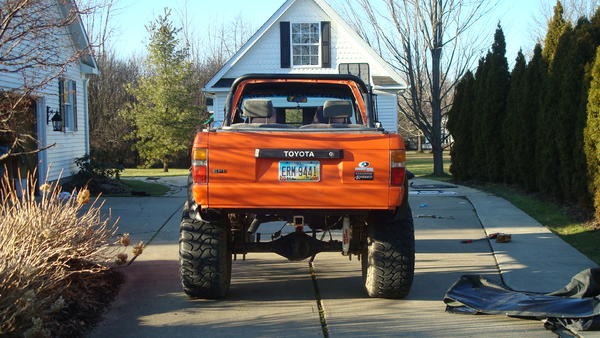

And then came the new lift. Rough Country 5” suspension lift. The rear was easy, the front… well lets just say I spent over 18 hours on the whole thing haha. (no lift or air tools)

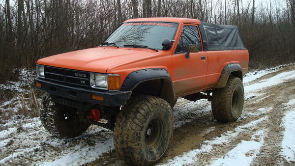

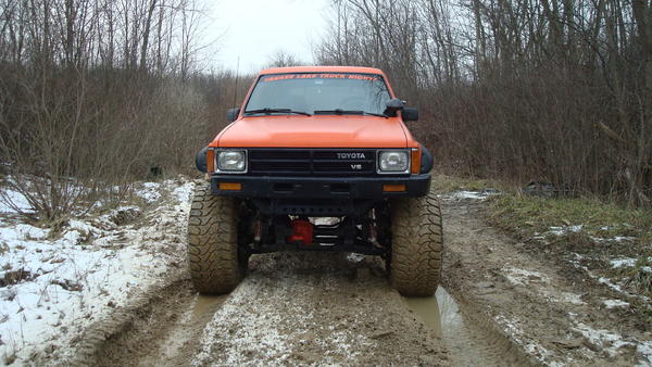

So I had 33" pro comp xterrains on my truck that i got for $213 a piece a year and a half ago. After I put the lift on i needed some new tires. I put my tires and rims on craigslist hoping to get $550 out of them, then buy my own... Then some guy offered a trade, his 36x15.5 Mickey Thompson ATZ's that still had the nipples on them (those are $340 tires)... DONE! Went to his house and swapped them on X-Mas eve! And THE MOST IRONIC THING was he was a toyota fanatic, he had the 36's on his 88 4Runner.

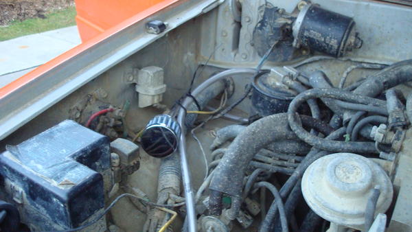

Just did this yesterday. The stock diff breathers are pretty much junk. They sit on the top of of the diff and get clogged super often, especially with mud. If the breathers aren't working correctly, the pressure inside of the axle has nowhere to go when it changes temperatures, so it presses out the seals, resulting in axle seal and pinnion seal leaks. And if submerged in water, it can get sucked into your axle NOT GOOD!
This is the front breather which i used 5 feet of clear vacuum line to re-route up in my engine bay. I put a filter on the end of it as well.

Those wide 36s give it a nice stance :driving:
Edit: Lookin at your pics again.. Hows the ride/ axle wrap with the rear blocks?

When I got the air intake in the mail, it had a little 2" filter inside, on top of the big one. I think it was a filter you could use for one of the vacume lines. Thats what I used for the diff breather. I didn't use a filter for the back one since there's o way for it to get dirty in the bed.

The ride quality is HORRIBLE. Like I've said before, it's like riding in a wood-wheeled buggy from the 18th century haha. And the axle wrap is minor. Should've seen this guy's ford. he had like 8" blocks. :lmao:
