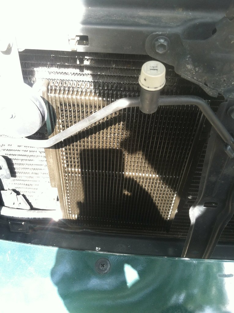

Anyways I did a lot of research before and after the purchase. So I knew the first thing I had to do was get a transmission cooler since I had no idea on when it was previously replaced. So I went ahead and bypassed the radiator transmission cooler completely. So being that I was kind of worried about the transmission overheating in stop and go traffic I got a ScangaugeII so I can monitor the vehicle at all times and keep an eye on the transmission temp. (I have some questions about this a little further down)
I plan to replace the radiator further down the road and run the cooler inline.

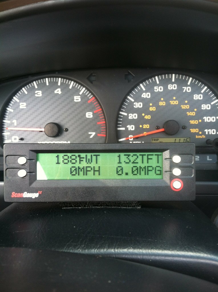

If anyone has any idea what the regular operating temperatures for the transmission oil on a car with a b&m 70268?
Here are some pictures:
For me, if I hop straight on the hwy it stays around 110-120. Stop and go city 160-180, mountain passes or slow offroad over 200
Welcome.
On the trans, as long as its below 180 its fine. Going up to 200 and above can happen in stop and go traffic and wheeling. But as long as normal driving is in the good range you are fine.
Thanks guys! So far it has been reading from 150-170 lately. Noting higher than that. Mostly in decent traffic no stop and go, and no highway yet. How accurate is the scangaugeII measuring mpg?
Those are good temps. The scangauge gets more accurate in MPGs as you log more fillups and it calibrates itself to your truck.
