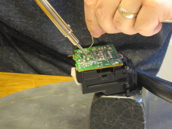

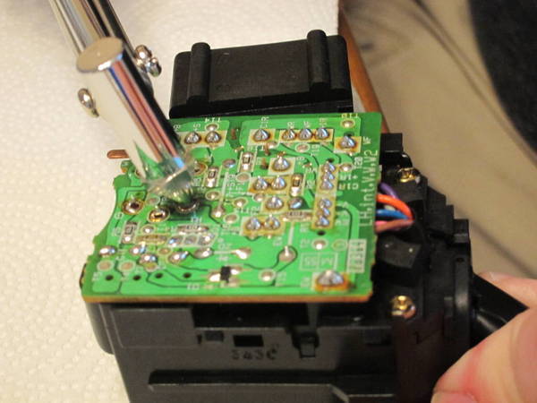

pics...

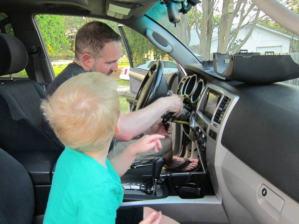

After only 3 screws to remove the steering column cover and 2 screws and a harness to remove the switch mechanism, desoldering and soldering was supposed to be the hard part...
well that part was easy...
Okay. That wasn't bad either.
Even my 3 year old was bossing me around on this one.
Awesome!! Thanks for the additional pics!!
Glad everything worked out for you and hope you had a great Fathers Day!!
