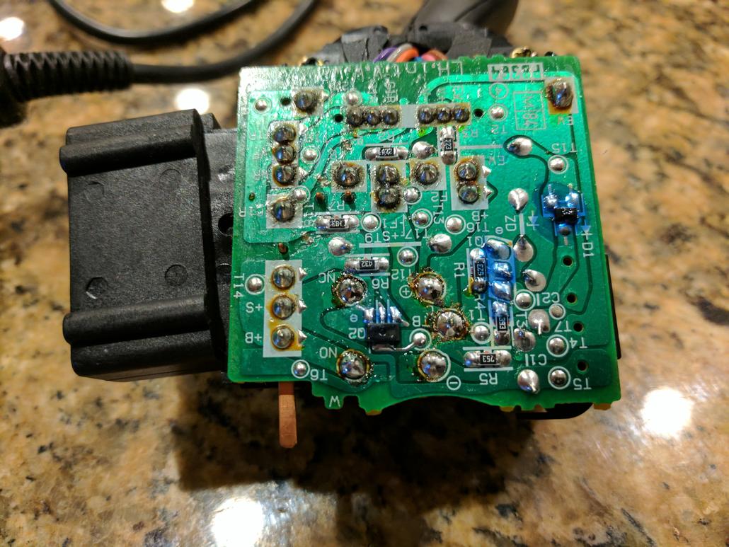

took 15 minutes or so to desolder with my cheap amazon desoldering pump but otherwise no issues at all
i would like to say that the relay has been replaced at digikey with part number JJM1-12V as a replacement, shows up on the page from your link
seems to work perfectly fine - no issues that i can see

Thank you for a great article and instructions. I just did the wiper relay swap on my 2000 4Runner and it worked like a charm. Total investment: $6. $3 for the relay and $3 for some desolder wick. I noted that the new relay is not totally silent but in a wierd way I like to hear the little click as a reminder that I was able to fix it! Thank you very much, you just saved me at least $120 or double that to have my dealer do it.
