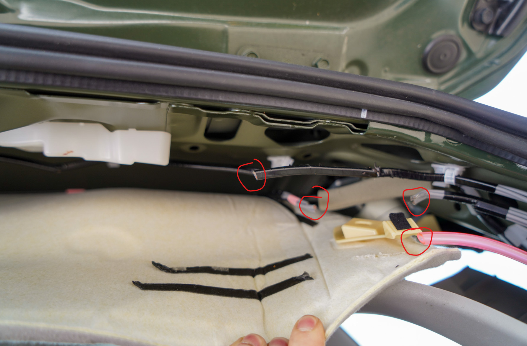

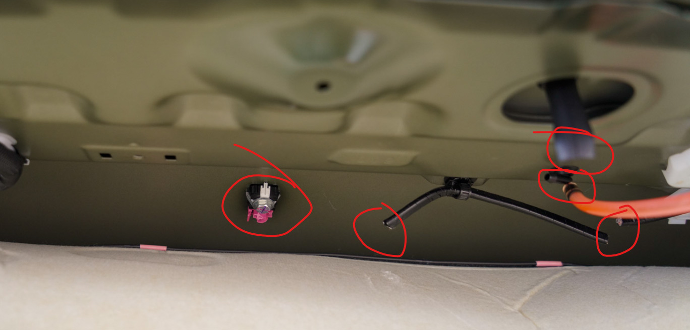

OP here again with an update...
In addition to removing the SHORT PIN, the thieves also removed the H-LP LH-LO and H-LP RH-LO fuses:
And below, as promised, here is the nasty antenna sabotage that was done behind the ceiling panel of the trunk in an attempt to disable Toyota tracking.
It looks like they were just on a panicky cable snipping rampage. Then, either just for fun or perhaps due to ignorance, it looks like they also clipped the rear washer fluid hose which is just. wow.
The dealer is going to have fun with this. I'm going to get insurance to fix it all, including the damaged ceiling fabric.
