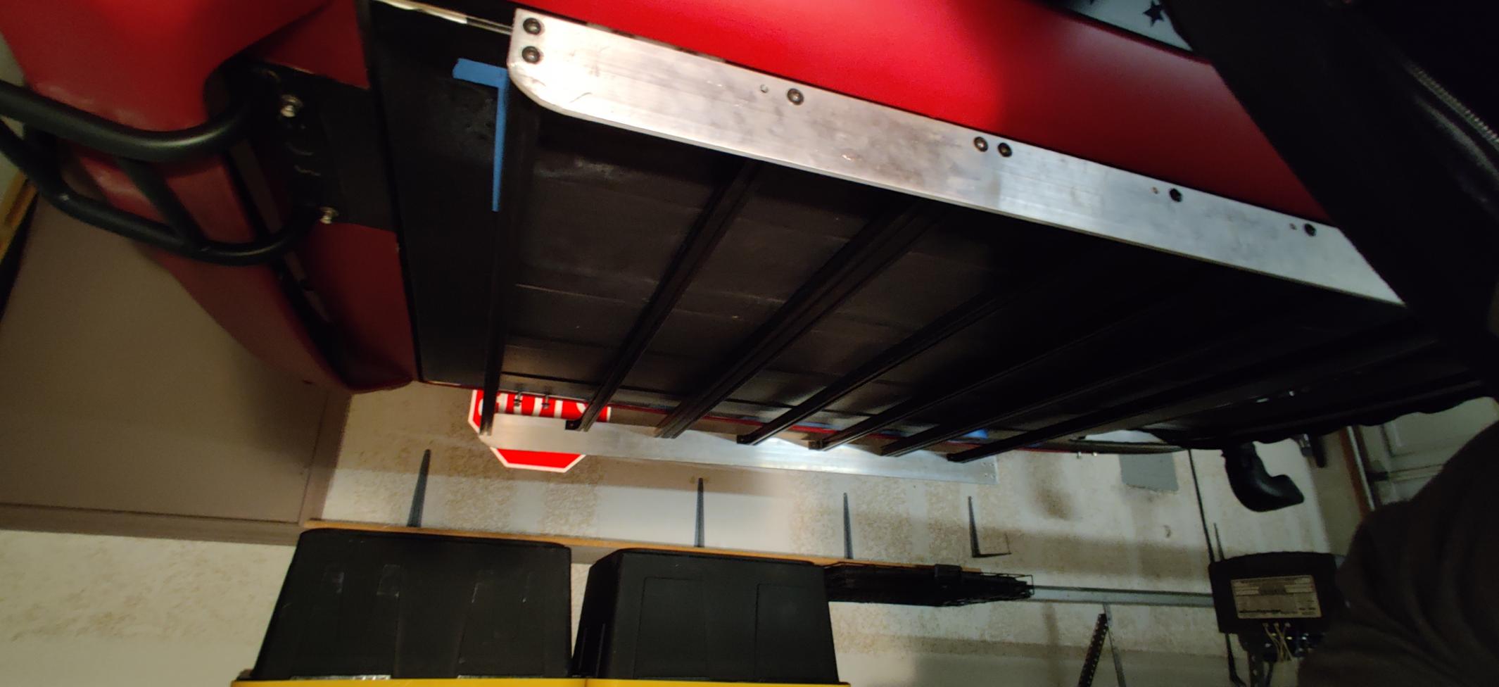

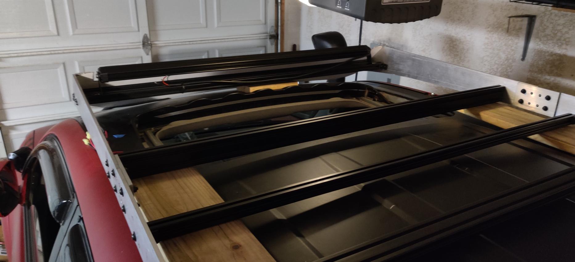

Exactly what i needed. Any reason you chose some 1x1 and 1x2? Do you have a picture from above? Thank you
I switched up the sizes mainly to cut down on weight. The supports are strong enough where I really could have just used the 1x1s for the whole thing probably. I also put a 1x2 vertically right behind the sunroof to try to make more of a "basket" to keep things away from the sunroof. Also the one in the very back is vertical too. These are the best above pics I have while I was making it. Not sure why one is getting flipped. I can take some better ones later if you need me to?
