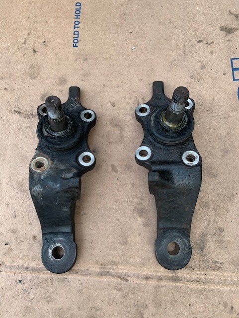

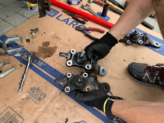

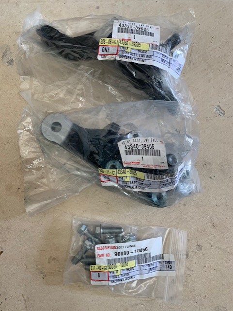

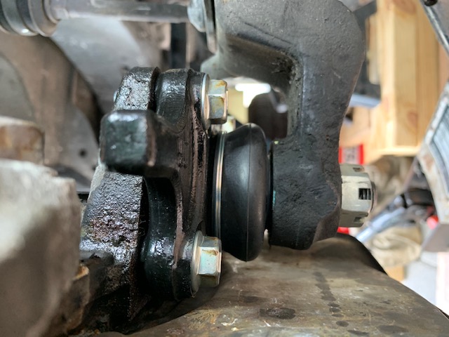

Replaced both LBJs on 5/15/21
Even though supposedly my VIN # was not affected by the LBJs catastrophic failure, I didn't want to take the chance so that's the first thing I did..
The job went pretty well, except I had a hard time pulling out the Right Tie Rod from the LBJ's frame. Left side went a lot better/faster since I knew already what to do.
Had to modify the internal space on of the Pitman Arm pullers with a grinder because it would not fit around the Outer Tie Rod end..

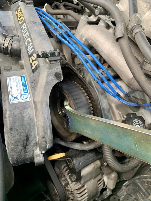

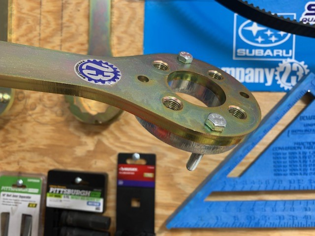

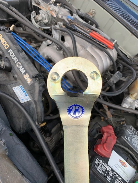

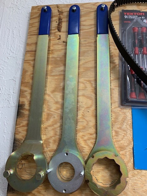

Checking the Timing Belt..
My previous car was a 2001 Forester which I did everything on. Subaru's Left Cam Sprocket is almost identical to the Toyota 4Runner Cam Pulleys! :guitar3:
I was very excited about this because it means I don't have to purchase more tools for the Timing Belt service.. well, at the least the Cam Pulleys anyways..
Company 23 makes some awesome tools. I haven't tested if the Subaru Crank Pulley tool works on this car. For the Forester, the tool used the 4 bigger diameter bolts. But I'm hoping the distance between the two smaller bolts on the tool is the one for the 5VZ-FE Crank Pulley. If I'm not mistaken, I think the distance should be about 2 -15/16", almost 3". We'll se..
