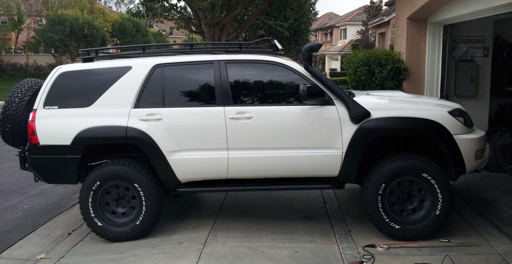

By any chance before mounting it, did you hold the snorkel up to your dads 5th gen to see how it would look? Many of us 5g owners are waiting on a snorkel.
No I didnt. The A Piller is much more straight on the 5th, so it wouldnt have lined up as well. Im sure there is a random snorkel that would fit it. Your going to have to look at different Vehicle A Pillars that the Snorkel IS made for. And compare them to the 5th Gen.

the tyre carrier and the snorkel mods are off the hook!...damn, how much does each cost?
Snorkel is like 400 the tire carrier is about 2,000-2,300 depending on options.

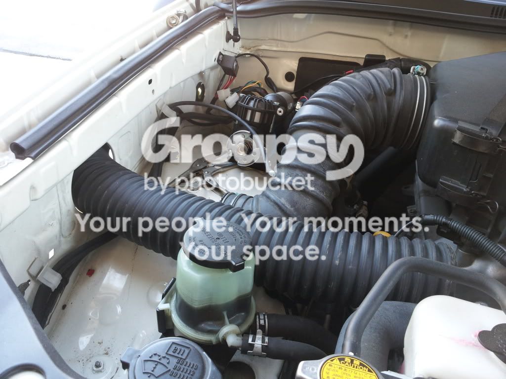

Thanks! The swimming pool will come good time haha. I still need to make the connection to the stock airbox. Theres about 2 feet of hose needed to do so. Im going to the hardware store today to see if they have anything. Ill keep everyone updated!

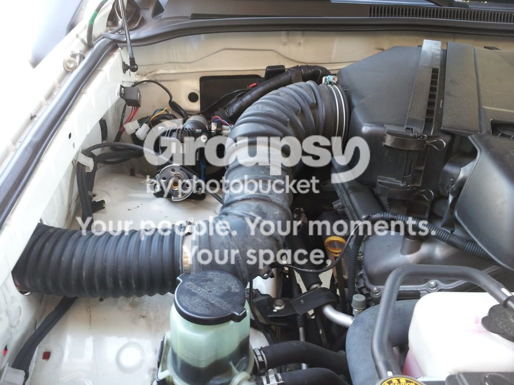

Can we see what it looks like from the inside of the engine compartment? I'm really wanting to order a snorkel now.

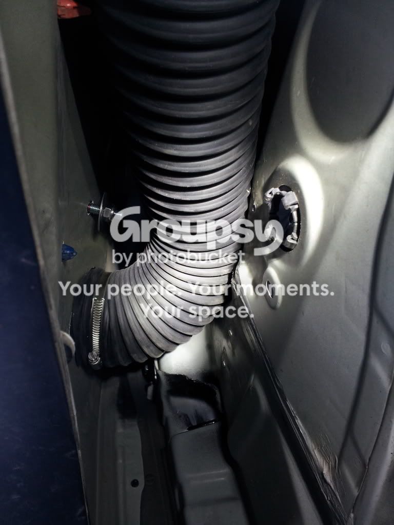

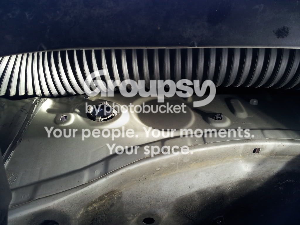

Alright I decided to hook it all up today. The space was Too tight to fit the tubing so I had to grid some of the body away. luckily it was additional thin body metal that was riveted to the engine bay body. No idea what purpose it serves. It got me an extra 2 inches so everything went on great. I was going to keep the stock air connector thing that is attached to the fender, but It turns out that it looks like a scoop on the other side so it wouldn't seal properly. So I just ran the tubing into the engine bay and attached it to the intake hose.

It wasn't easy. Connecting the hose was a bigger PITA than installing the snorkel. All my knuckles are bleeding haha.
At least its done.....:)

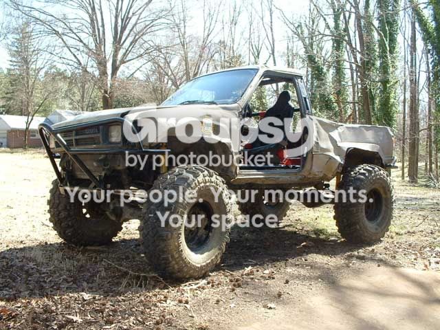

They are a good idea when doing water crossings, but when you rip it off on a tree trying to get there it doesn't seem that good of an idea. The marlin crawler sticker is there for a reason:
