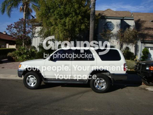

-When I first brought the 4Runner in Aug 5th 2009 265/70/16 (Circumference 96.15)
Avg after 3 fill up 18.166 MPG

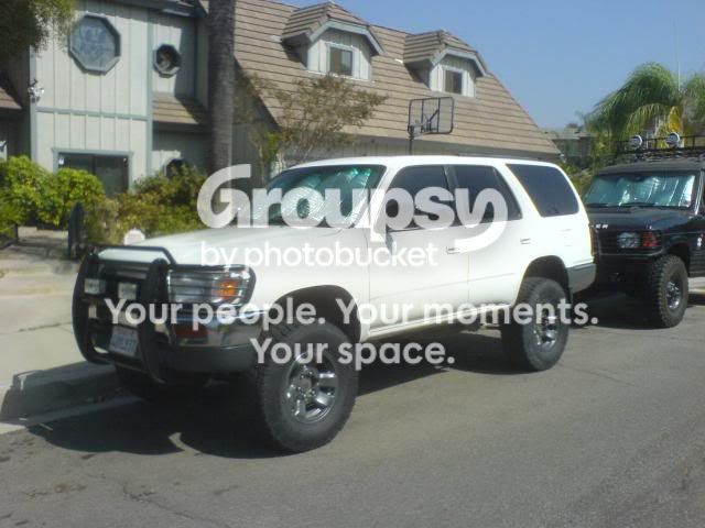

-Tune up (spark plugs, universal joint, Timing belt, brakes, air filter, fluid changes), Gill guard added, 3 inch OME lift added, upgrade tires to 265/75/16 Nitto Terra grappler (Circumference 99.43)
Avg after 27 fill up 19.44 MPG

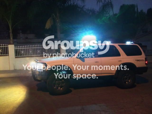

-Rola Roof basket with extention, 4 Hella 500 in front of basket, 8 LED fog lights, and 2 Hella 550 in the back added
Avg after 7 fuel up 18.14 MPG
IMAG42811.jpg~original

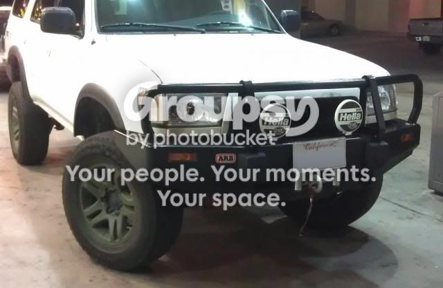

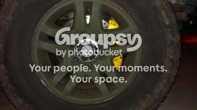

-Roof basket off, LC 9.25 wraps added, ARB front bumper and warn 5000 winch, Tundra brakes, tires and wheel change to 285/70/17 Nitto Terra grappler (Circumference 102.76)
Avg after 12 fill up 20.83 MPG
IMAG5969.jpg~original
