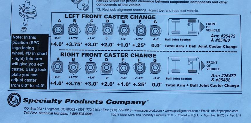

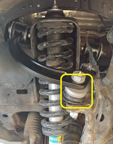

Just noticed... it looks like your UCA ball-joints are installed backwards.
Should have the flat side aimed towards the tire? (SPC logo on that side)
...Unless these new versions are totally different.
Instructions are older...

I took that pic while installing and messing with the adjustments the UCA's allow. It was also taken before alignment. They are currently installed with the SPC logo facing the tire as instructions say.
