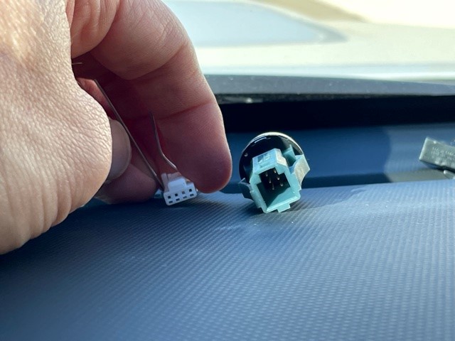

My $5 mod in 5 mins.
Taking out the dummy plug is very easy.
Now, if you need to remove the actual light sensor after installation, *that* will be a royal PIA.
The locking tabs are different and need to be depressed from under the dash to push out the sensor. Be sure to test your sensor before snapping it into place.

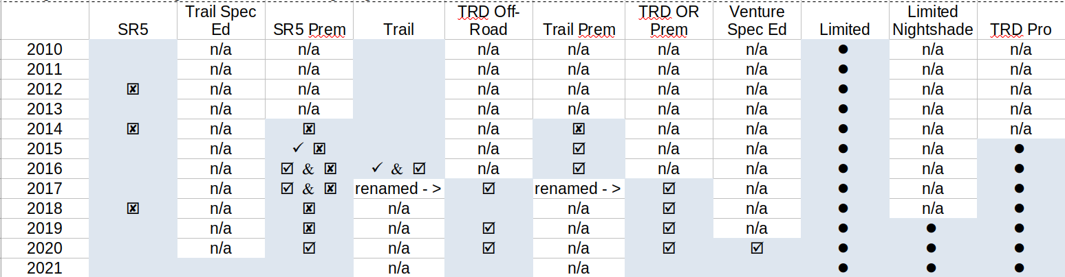

TL;DR Summary data table and key thus far from this thread.
Note:
  • Many who responded that the simple sensor replacement worked did not offer what vehicle it worked in and that is not shown
  • Some clarified CA spec or US spec and that is shown
  • there were conflicting responses regarding SR5Ps
  • I am not marking the SR5Ps as plug-and-play working if they need the harness wiring to make this mod work.
You must turn your brightness dial (the dial to the left of the steering wheel) off of the clicked (highest) setting for this to work and your headlights must be on to experience this mod working.
You may need to adjust your Day mode and Night mode settings, visit https://www.toyota-4runner.org/3315203-post55.html for instructions.

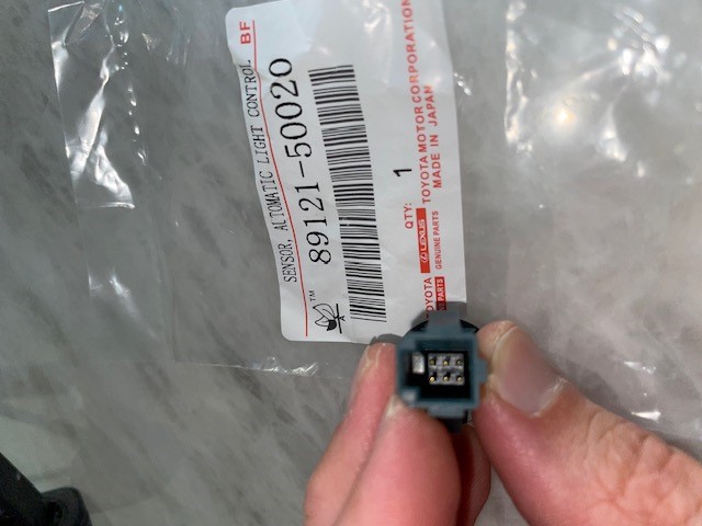

p/n 89121-50020 6-pin sensor for 2016 - 2019 models
p/n 89121-0E060 4-pin sensor for 2020 - ???? models (old p/n 89121-30020 also reported to work)
If you need to fabricate a harness visit https://www.toyota-4runner.org/3435385-post267.html and https://www.toyota-4runner.org/3435546-post270.html for details.
Obviously YMMV.

This is good but adding the correct part number for each would be a help.
What verified plug-and-play part numbers need correcting?
Send me a PM with the verified working thread link and I'll make the edit.
I certainly may have missed something in the nearly 400 posts to this thread.
Post 382 clearly shows there are at least 3 different part numbers for the modification. I believe there are more p/n’s that cross reference to the before 2019 and after 2019.

I can confirm that the 6 pin 89121-50020 works on my Canadian 2018 TRD Off Road.

**runs out to driveway to pull mysterious plug in dash. I'LL BE DAMNED. 6 pins going into a BLANK plug. Okay tOyToA...
I do a lot of driving at night so I am pretty excited about this $5 $8.99 mod. (found a seller in San Diego, CA)
Hey folks! I received my light sensor last week and promptly installed it. I've been driving around with it and it is fantastic!
