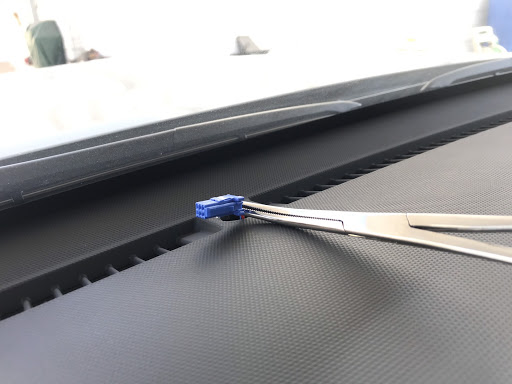

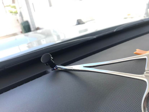

My $5 mod in 5 mins.
Kind of confused, if you turn the lights on and the gauges go dim and the GPS goes dark like it should, (making sure the dial isn’t set all the way up) what does this do? Seems it has all been done already?
when it’s bright outside, say a light rain is in the forecast, and you live in a state where you have to have your headlights on with the wipers, it’s annoying to have everything dim in the middle of the day...this little mod fixes that problem.
Took 5 minutes (and $6)...
Works great in my ‘16 Trail Premium.
Thanks, OP!

This already has been, or is being attempted by a member here. There is a thread about it somewhere. Might actually be in the auto headlight thread. Basically, it requires all the limited trim and a different bcm. But do t quote me on that.
I normally drive with my DRLs on, if I go under a bridge where it's darker, my nav will switch to dark mode until I go under normal sunlight and switch back to normal.
I'd looked at this thread a few times and almost ordered one, but thought it was pretty easy just to spin the wheel for brightness. Then, my wife drove the 4R after dark this weekend and picked me up. Her dash lights were full on bright (since I'd last left the brightness wheel on bright override), and she'd been driving that way over the Santiam Pass for 2 hours! I said something like "how can you stand the dash lights so bright" (I'll never learn) and she complained that the car should do that feature itself. So, here I am back at this thread, and just ordered the one from Illinois (paypal receipt in Chinese) hoping my 2018 TRDORP will be as plug and play as the OP!
rookie mistake. lol
I think i'm the only person with a (2014) trail premium who doesn't have the harness under the dummy cap lol I will check my ECU harness for the wires tho.. maybe it just fell out or something
Works like a charm on a 2019 TRD Off-Road.
