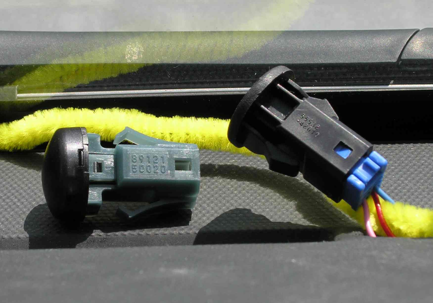

PRO Tip: Put a pipe cleaner or a string in-between the wires of the connector BEFORE you take the dummy sensor off. Then if you drop the connector, it won't fall down the hole.
I ordered the $6.83 (free shipping) light sensor from China on July 5 and received it in the US mail on July 17, that's 12 days. I'm still testing to see if it works as expected.
I'll leave the light sensor out of the hole until I see it working properly. Likely, I'll put some electrical tape on the clips of the light sensor before I put it back in.

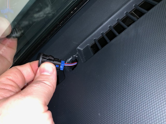

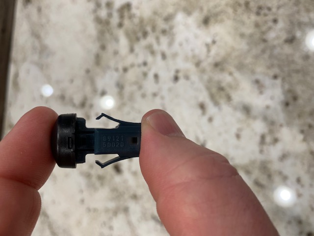

Light Sensor Install With Pics
Here are step by step directions on the install. Pics below.

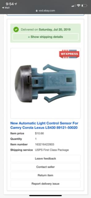

Step 1: Search Ebay and order: 89121-50020

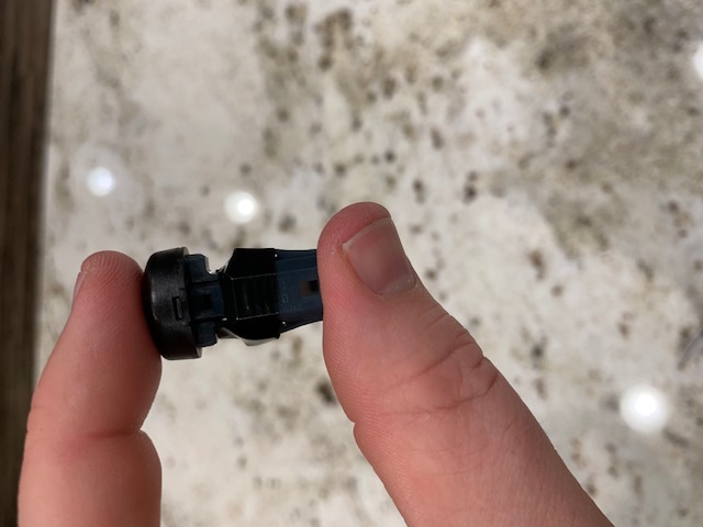

Step 2: Unpack your new sensor and wrap electrical tape around the tabs so you'll be able to get the sensor out of the dash in the future (Thanks for the idea MC1986). I found that cutting a 3-4 inch long piece in half LENGTHWISE was strong enough to hold the tabs. I originally did not cut in half and it was too thick to fit back into the dash.

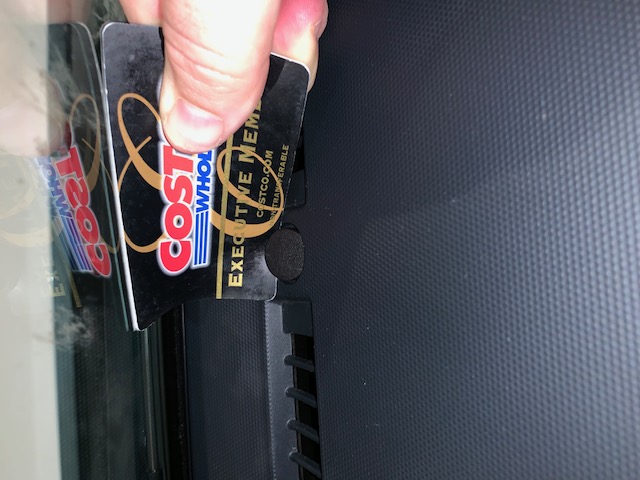

Step 3: Select credit or other card for sensor removal (I prefer the Costco card myself).
  • Note - I tried my smallest trim panel removal tool first but there is just no good angle.

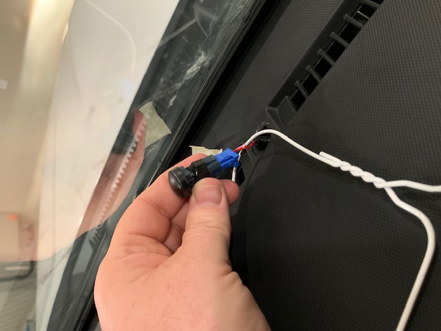

Step 4: Work the card under the existing sensor head on the WINDSHIELD side and pull upward.
Step 5: With the sensor removed from the dash but STILL CONNECTED, put a hanger, pipe cleaner, or other item through the wires so it doesn't fall back in the hole.
Step 6: Remove factory sensor. Plug in aftermarket sensor.
Step 7: Test sensor by turning the ignition on, turn on your headlights, turn off the lights in the garage, the instrument panel should be lit dimly. Put a flashlight over the sensor - the instrument panel should get lighter.
Step 8: Remove hanger/pipe cleaner from the wires and insert sensor back into dash

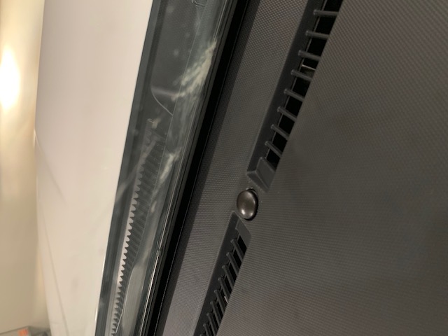

Just installed mine after it finally got here on the slow boat from Taiwan. Wiring in place as expected for 2016 Canadian "Trail Edition" .:canada:
I have 2017 SR5P and it does have the wires under the plug. Took a 1 inch drywall nail upside down, and pulled the plug up from the windshield side with the head of the nail.
