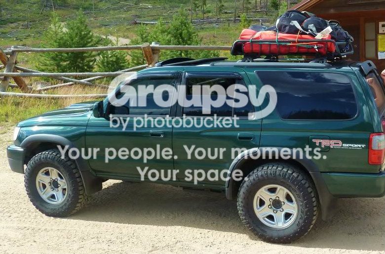

My '99 4Runner
Thanks for the suggestions everyone.
Got my tune up done a couple weeks ago and did the following:
- Replaced fuel filter
- Replaced air filter
- Replaced spark plugs
- Replaced PCV valve
- Replaced ignition wires
- Fuel induction injection
Was not cheap. Hard to see much of a difference on the mileage yet which is a bit disappointing.
Also replaced the battery yesterday. Only got a Maxx EverStart from WalMart. I'll get a nicer one when I graduate and have the money!

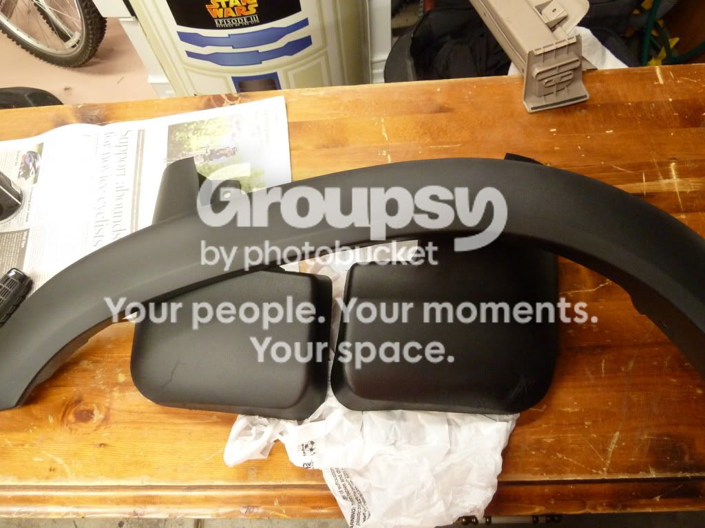

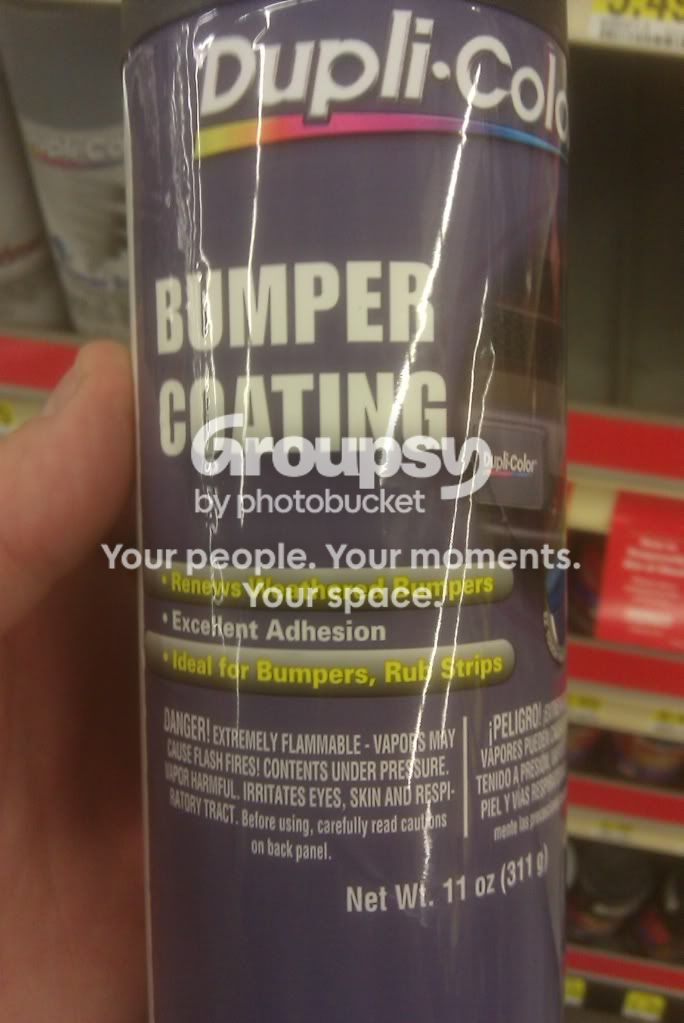

Paint your fender flares since they look pretty badly weathered. Worry about getting the exterior up to par also since looks go along ways.
After cleaning the plastic and then using an adhesion promoter I sprayed a couple coats of this.
IMAG0188.jpg~original
P1010234.jpg~original
If I did it again I might go with something with a little more semi gloss look but the flat black hides and deals with scratches on the trails better. They a little dusty in this pic but they look better than they did.

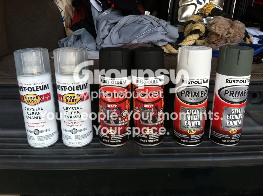

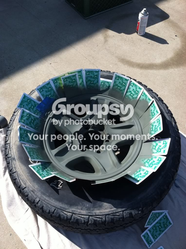

I started to paint my wheels today based of the write up listed on the forum.
Here are the products I used:
44e37aff.jpg~original
I ended up actually not using the Clean White Primer.

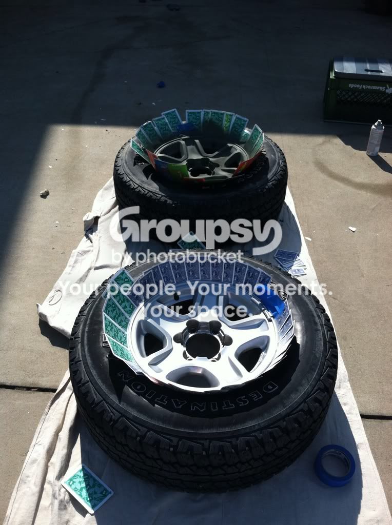

I cleaned the wheels using 409 degreaser, a steel wool pad, 400 grit sandpaper, a rag, and a scotch brite pad.
c2487118.jpg~original
579bd92a.jpg~original
I applied two coats of the Self Etched Primer, then used a steel wool pad and cleaned it off. I applied another coat of SEP.
Three coats of black base coat were next.
I'm about to go start putting on the clear coat, but it looks pretty good so far.

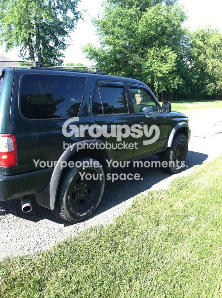

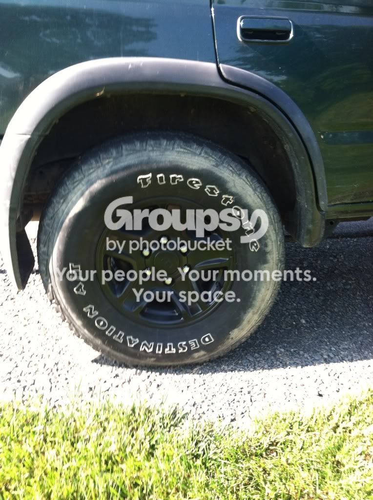

Final product. I plan on painting the Toyota logo on the center caps a different color. Maybe silver or gold. Might paint the lugnuts too.
