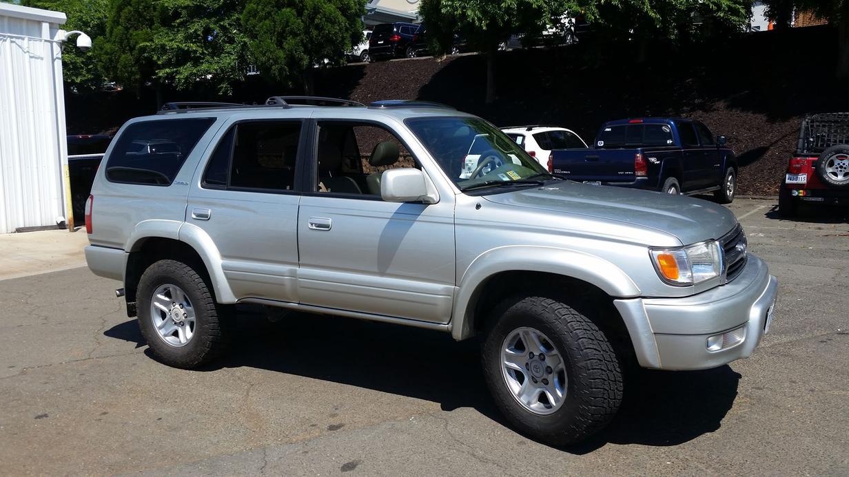

On the tires I kept stock size and went with Nitto Terra Grapplers (1st Gen) Ill update with some pics eventually
Well removed my running boards and replaced my left rear shock
