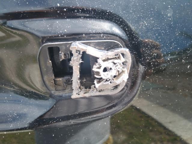

Daughter had broken the forward (hinged Part) part of the outside handle of the driver's side rear door. It still operated if you pulled the rear part of it out straight. I accidentally pulled on it in an angled manor and the handle broke off completely. I then went inside, tried the inside handle and it would not open either.
So now I'm left with trying to get it open destroying anything.
Any info I have found with an open door.
So without any other input I took a chance.
This is what I started with.

I tried to break the rear portion off with a set of large channel locks to no availe.
The plastic is pretty tough.

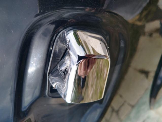

https://www.toyota-4runner.org/attachment.php?attachmentid=399091&stc=1&d=1661223160

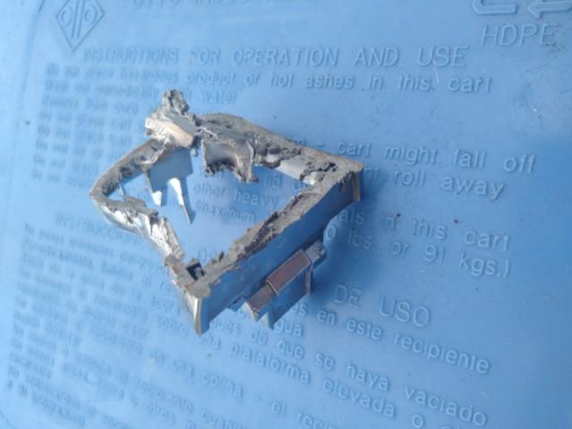

Next came the multitool and even it took a long time, the chrome is very high quality and very thick.
https://www.toyota-4runner.org/attachment.php?attachmentid=399093&stc=1&d=1661223454

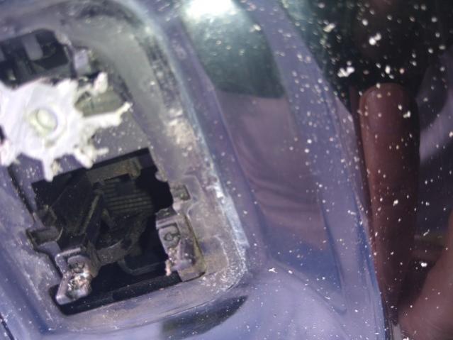

Here is the rest of that piece with the protruding part that keeps the handle in place.
https://www.toyota-4runner.org/attachment.php?attachmentid=399094&stc=1&d=1661223581

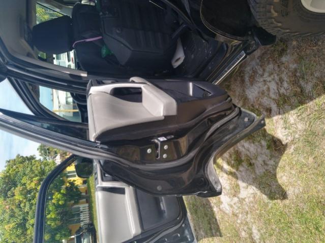

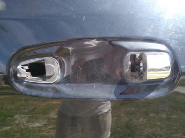

With all the broken pieces of plastic removed I then was able to open the door from the inside.
https://www.toyota-4runner.org/attachment.php?attachmentid=399088&stc=1&d=1661223581
Now to replace the outer handle.
