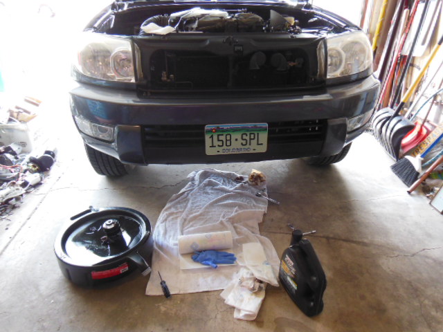

Thank you all for your help and answering my questions! Got it done today, it took 2 hours. My only mistake and I think someone said it on here was catching the excess when taking the filter off.
