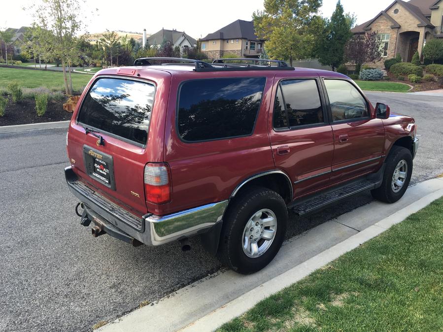

Just did a drain and fill today, man was that fluid nasty! Drove her about 75 miles today, up the canyon and on a trail. No issues whatsoever. Then on the highway. She shifted smooth as butter every mile.
The light did come back on though, at this point it doesn't make sense to change the solenoids, how could they be bad if the trans is performing perfectly? (But I'm no mechanic) Maybe an electrical/CPU issue?
I will for sure get a new radiator on her. I've read the horrors of the milkshake, would be best to avoid that...
Also, I gave her a free lift today and removed the running boards! Boy was that a fun one....those rusty bolts had me cussing like a sailor. :frusty:
So much better! I really enjoy the Runner without the boards.
