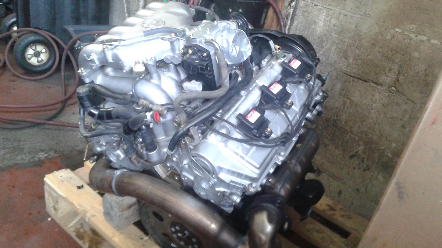

First I bought a JDM engine in Dallas and specifically asked if it was ready for a 4Runner. I did not one that was for a T100 set up. Did not know this is he only way they came, at least from this folks..paid 866 plus 75.00 delivery. I called and worked out a discount for not disclosing the amount of work going into this. So here is my run down.
Switch oil pan
Oil filter, oil cooler
Oil dip stick
Water pump and timing belt(most expensive)
Crank shaft pulley
Water pump pulley
Fan clutch and pulleys
Exhaust manifolds
Ps Pump mount
Alternator mount
Both Motor mounts
AC mount
Fuel lines
Engine Harness
Upper and lower air intake
All in all took about 4 hours of work which is why I was a little ticked off on not disclosing the amount of work converting this JDM engine.
So once I drop this in the 4x4 98 I'm working on I'll get back to you on running condition. Heads look extremely clean on the plus side.

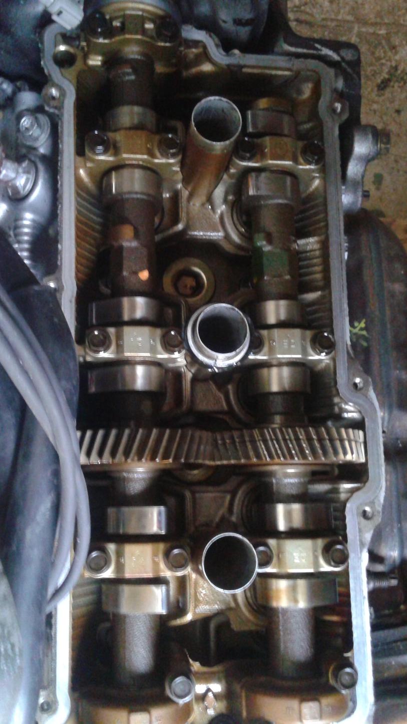

I've gotten two 3.4's from a salvage yard in AZ. They specialize in low mile wrecks. Just received this 3.4 out of a wrecked 2002 4runner for my 1996 project 4runner today. 109k miles on it, cost me $700+$275 shipping. I considered buying a JDM but this salvage yard treated me so good on my tacoma motor i called them for this one too. I've read good things about JDM, i may have to use one on a future project.

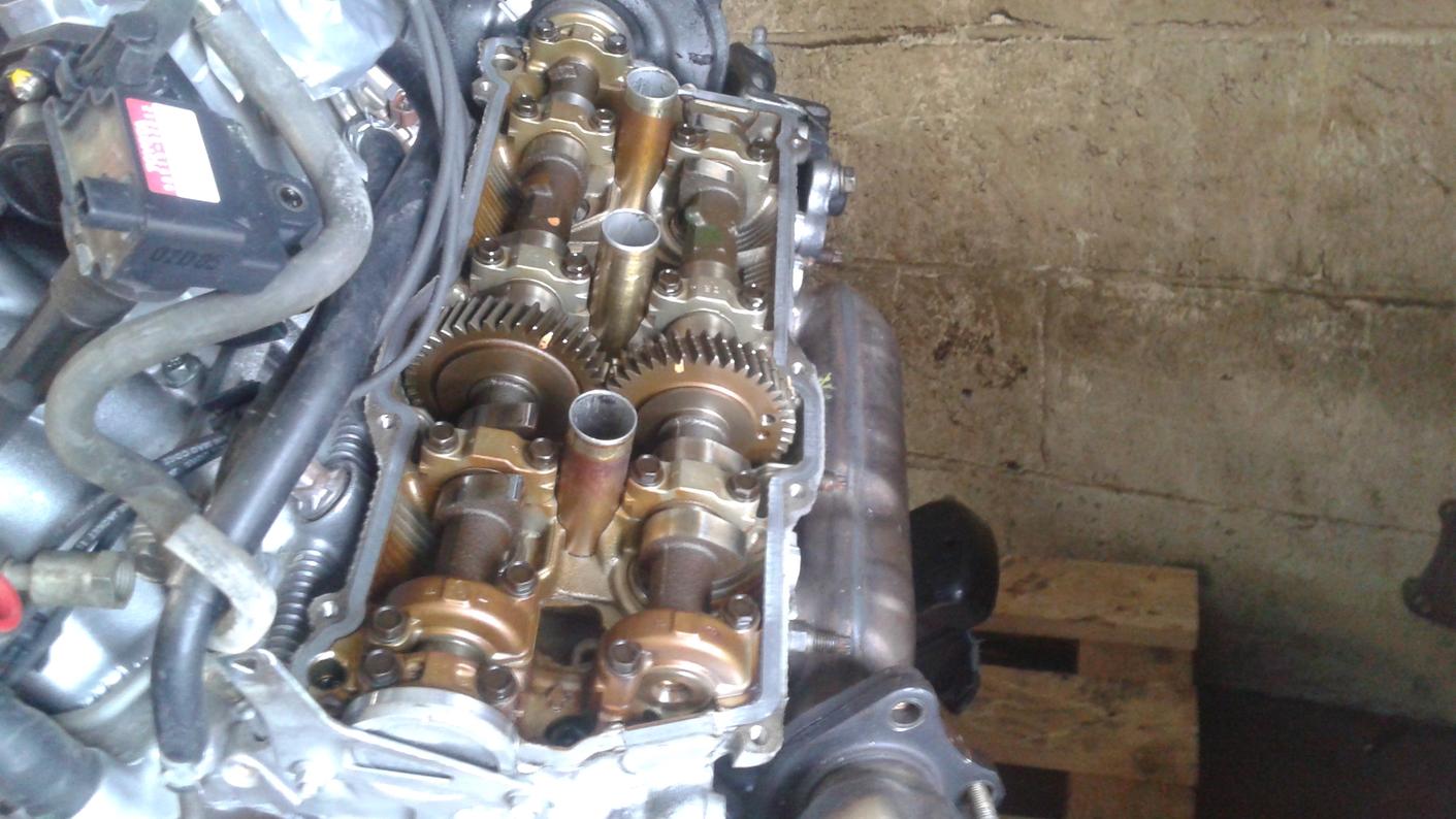

Mine pictured above still has the factory paint marks on the cams. My pics were taken with my cell phone, color of mine is similar to yours in person.
QUOTE=68dave;2269298]Mine pictured above still has the factory paint marks on the cams. My pics were taken with my cell phone, color of mine is similar to yours in person.[/QUOTE]
Man I hate to tell you this. But this aren't factory cam marks. That head has had work done to it. when you you do the heads its good to mark the Cams for TDC.
You might want to fire that engine up quick. cause if it wasn't done right you have the warranty. Ive done plenty of factory engine heads and never seen the cams internally marked. Ive seen the other external timing marks.
