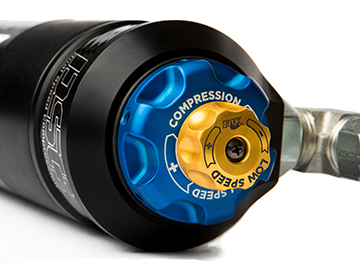

Now that I learned about the Fox 2.5 with DSC, it comes with two independent adjustments for low speed and high speed compression. Cost is also higher, but it addresses some of these concerns.

Really liking this low speed and high speed compression tuning capability.
