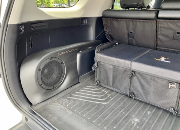

Yeah, I couldn't agree more. I had considered doing ad hoc upgrades to fix the flat / muddy stock stereo in my 2019 4Runner. I just couldn't figure out which pieces needed replacing most, if I needed an audio processor / eq more than anything or what. I was afraid of investing money in a piece here and a piece there and either not fixing the audio fully or causing some other issue with the truck. The OEM Audio kit sorted all my audio quality issues right out, the stock deck's minimal EQ is now more than sufficient to make all my music sound great, it doesn't matter if it's hip hop or metal, it just sounds 10X better than it did stock, and you can't argue with the sleek look of that subwoofer on the wheel well in the back.
Agreed, looks good. :)
