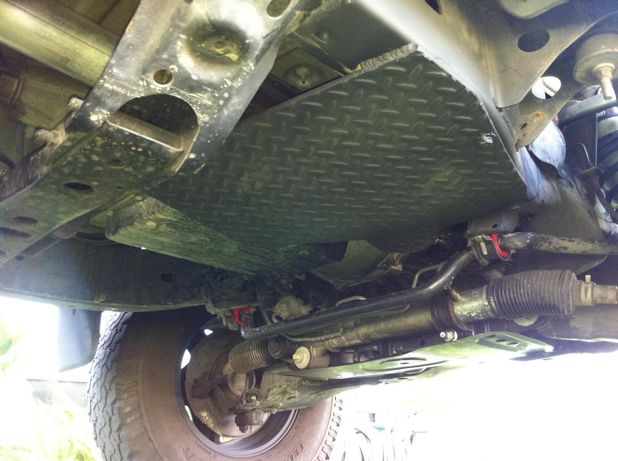

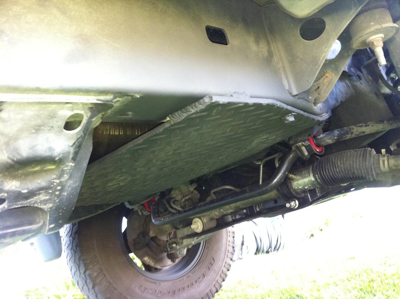

seeing people now know my dads serious about things haha this is what we came up with.
diamond plate bolted and tacked/ welded to the frame and curved up with the pipe (not just flat if you can tell)
it is impossible to cut the front side of the cat pipe without having this off first, thats the idea
