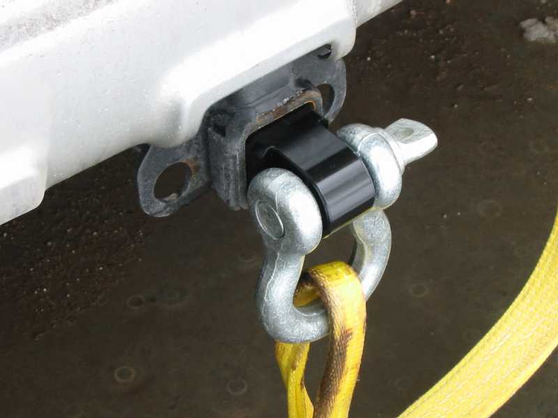

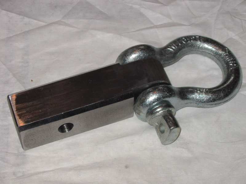

Custom machined a shackle bracket to fit the hitch receiver. Finally made a small pc. of insurance out of tool steel to make it easier to use my recovery strap "just in case". You never know who you might have to help out of the ditch in the middle of winter (even I wouldn't leave a Heep driver stranded.)
Pre-paint:

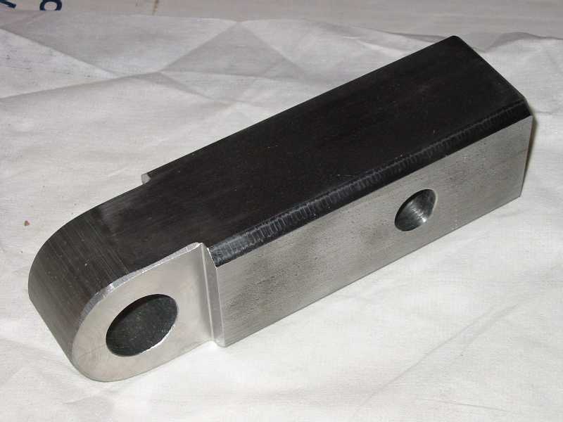

I worked on it from scratch. Started with a 2x2x7" block. Put a 5/8+" hole 2" in from one end for the hitch pin. A 1+" hole 1-1/2" in from the other end. Carved down the width to 1-3/8" at that end for about 2-1/2" length to fit the shackle (depends on actual shackle) and created a rounded (radius) end. Had to go back and add the 4 chamfers down the length in order to fit into the receiver.
