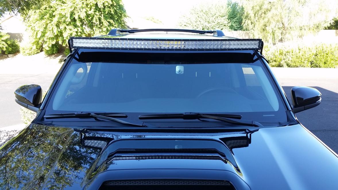

Was this issue ever solved? I hate all the noise the lightbar makes. Whistling, and some vibration noise that sounds like your tire is running low ... i have a 50" curved lightbar and it is sooo stinking loud. Cant talk on the phone with someone past 70mph. I tried using doorstripping on the bottom four fins and it quieted down between 20-60mph in whistling but still does it at low speeds under 20mph, parking lot speeds.

I put caulking in the fins like requested and it helped. I also tilted the bar down more so the face isn't fully hitting the wind. That seemed to help a lot and now it's only loud when I'm pushing 90 but it's not to much concern because my exhaust is much louder at that speed.

From what it seems, the air hitting it head on is what makes the noise so if I move it further back I would have no choice but to point it straight forward and I believe the noise would be there. When I've tilted it all the way down so it's shining at the bottom of the windshield I have virtually no noise at all

So I read up on this (God knows why - I have no need for one) and it looks like air running through the fins on the back is what makes a lot of the noise.
As an experiment, why not try running a length of duct tape on the underside of the fins and take it for a drive? Might not fix anything but it's a cheap test.
