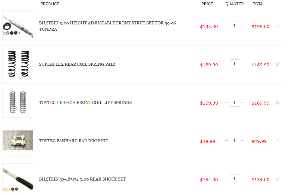

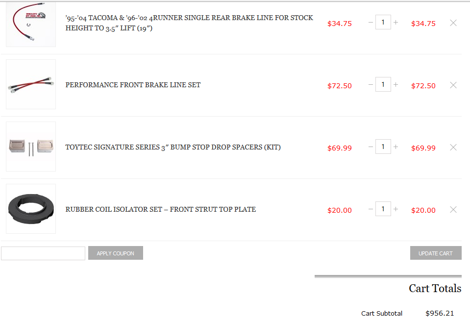

Hello, this is my piece-it-together build. I wanted something that would be suitable for my daily driver but also be nice off-road. I don't mind rake so I plan on running the front bilsteins on the lowest perch. The only added weight I have now is a tool box and box of fluids behind my rear seat and I am debating getting rock sliders. I do plan on running 265/75s or 285/75s but I will be stuck with my 265/65s for awhile
Front:
Bilstein 5100 Adjustable Tundra 99-06 struts
Toytech/Eibach 3" lift springs
Wheeler's Offroad rubber coil isolator set
Toytech front diff drop kit (added)
Back:
Bilstein 33-187174 5100 Rear Shock Set (recommended by Toytech and used in SS 1.2)
Toytech Superflex rear springs (3.75+ lift)
Toytech Panhard drop kit (will gusset)
Toytech signature series 3" bumpstop drop spacers (kind that mount to frame?)
Brakes:
Wheeler's Offroad extended back brake line
Wheeler's Offroad front brake line

I would add a diff drop kit and remove the rear bump stop spacers. You can get new extended bump stops for less than those spacer brackets.
Thanks for your response. I had a toytech diff drop kit in there but I must have removed it at some point. Where can I get an extended bump stop for less? I've heard good things about Sonoran steel bump stops but don't want to spend $160 on something I'll use very rarely.
You'll use them every time your wheel stuffs past the point that the stock axle location would allow it. If you do any sort of crawling, you'll want them.
You can make them for about $5 and a case of beer. Find some 4" long tubing (square or round) cut in half, and befriend someone with a welder to weld them on for you.

I guess I should have asked if it was going to work. Would that bump stop spacer be enough? Will there be any clunks or bottom outs or breaks? I'm not too keen on bigger shocks but I don't rock crawl and think just about anything would be better than the worn out stock shocks. I was originally looking at the SS 1.2 kit but I was hoping to save some money to put towards some duratracs. I am also just about 50/50 on TRD vs Toytechs with the determining factor being price and availability. If I could get TRDs for around the same price, relatively easily, I would probably do that.
