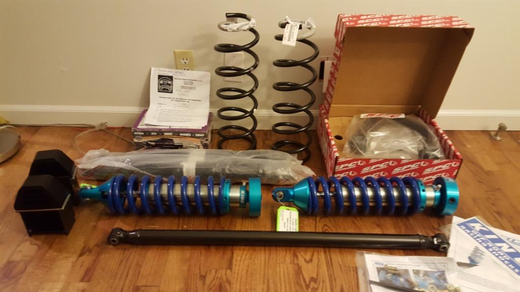

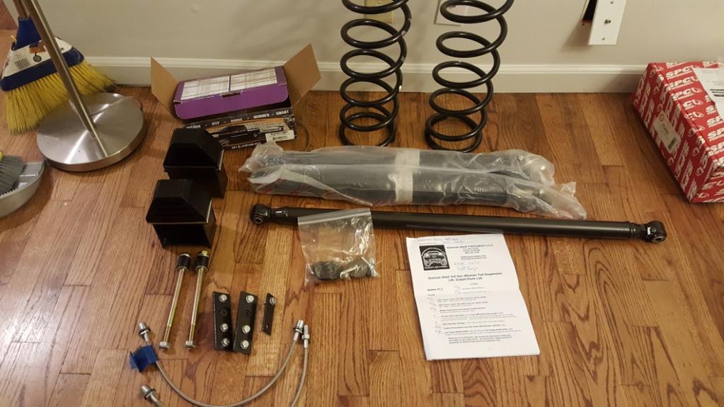

So this box from Sanoran Steel showed up today. I am pretty stoked.
Here's what I got:
Sanoran Steel 1.2 rear only lift.
Sanoran Steel different drop spacer kit.
King 2.5 Extended Travel Coilovers.
SPC Light Racing UCAs.
I also ordered front and rear MStudt's extended sway bar end links that should be here shortly.
Steve's SS directions look pretty straight forward. And the King coilover install looks pretty straight forward as well. I even watched a few SPC Light Racing install videos on YouTube. I have not done a vehicle lift, but none of it looks like rocket surgery. I just want it to do it right the first time.
I have a couple of questions:
In general, how did your SS 1.2, King coilover, and or SPC Light Racing UCA install go?
Is there anything that you would have done differently, or made it easier?
"King coilover specific": Do you know what initial height Kings come set at?
As far as getting an alignment goes, If I take this to my lifetime alignment from Firestone shop, are they going to know what the hell to do to align using the SPC Light Racing UCAs?
It looks like the SS kit, and King kit comes with new mounting hardware. Is there any other "reusable hardware" that would be easy or smart to replace to make life easier?
Thanks for reading!
