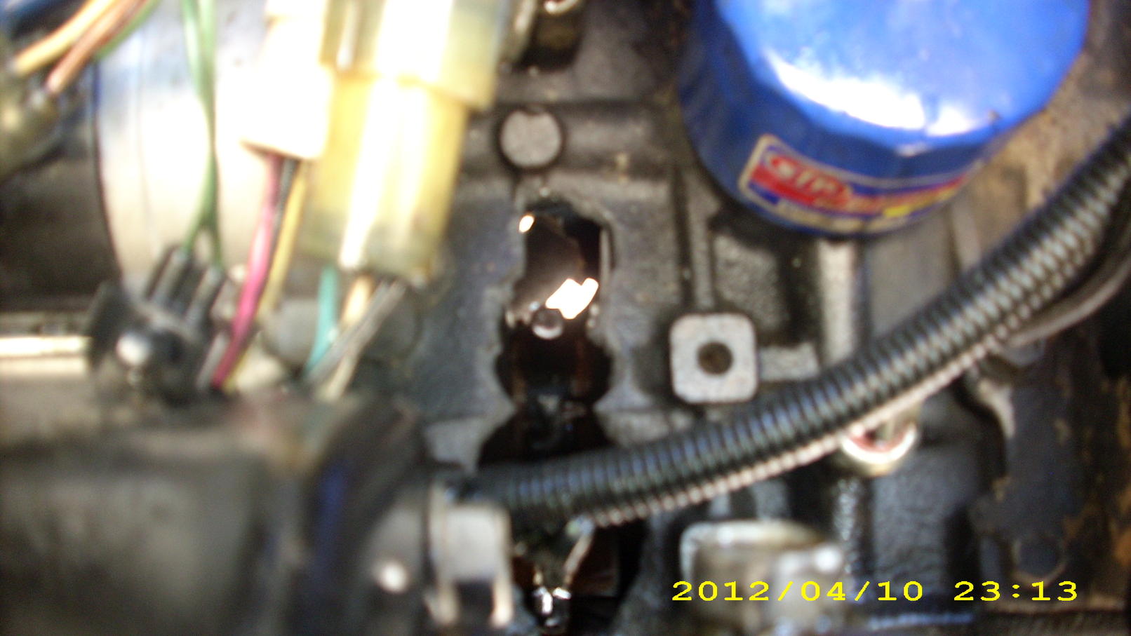

nice, great price too. I paid 500 for mine similar deal it was missing and had low comp on 2 cyls. so I took it for a ride after installing lift kit and it threw a rod out the side of the block but kept running .you can see the crank spinning when I start it
That is crazy right there.
Holy crap
