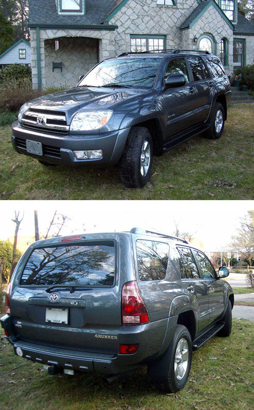

I traded my '97 Grand Cherokee for a new '05 SR5 in January and am very happy with it. So far I've added a front license plate holder, ultrasonic reverse sensors, aux. backup lights, and an Omnifi 20GB MP3 player.

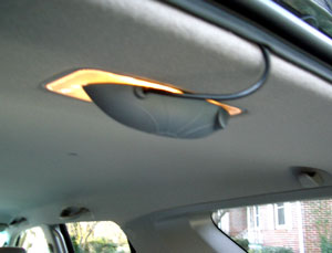

The display is attached to the rear cargo area light. The numbers display upside-down, but the distance bars and beeper are more useful than knowing the actual distance.

The nice thing about this one is that the display is pretty small, and the gray plastic matched my interior fairly well. It reads the distance in meters, but I pay attention to the sound - it beeps faster as you approach an object, then a solid tone within 6-12 inches.
The kit I bought included a hole saw. I didn't have a problem installing the sensors, but drilling that first hole in the bumper made me a little nervous. They are black and don't look out of place on the grey bumper.
I ran the wires through a grommet on the drivers side and routed them into the jack storage compartment where I installed the control box. It was easy to tap power off the backup lights. Instead of mounting the display up front, I decided to put it in the rear, reasoning that that's where I would be looking as I back up. Total install time was about 3 hours, most of that spent figuring out where/how to run wires.

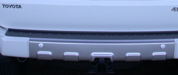

wkparker said:
I've seen them in different colors, including a silver that might match your titanium much better.
My reverse sensor system uses two sensors, so they are silver to match the silver bumper trim.
I find it handy too -- maybe a little conservative (I have solid beeping within two feet of an object), but still helpful when backing into a dark driveway.
One tip for anyone who installs a reverse sensor - place masking tape (the blue "painters" tape works best) in the approximate location for each sensor, then use a Sharpie to mark the spot for the drill. This lets you adjust the measurments a bit without ending up with dots all over the bumper. I left the tape in place as I drilled to help protect the area around the hole.
