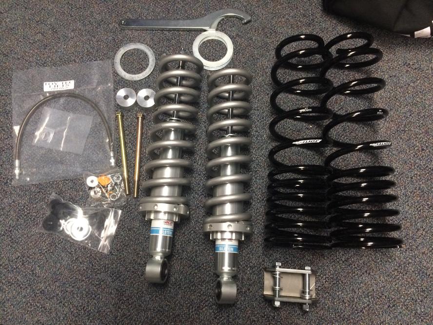

The pieces are coming in! All I am missing now are my Long Travels. Am I missing anything here? The top plate for the front suspension? When I actually do get to the lift, I plan on knocking everything out at once, since I have to "rent time" at the base hobby shop. I'll have professional guidance, so it shouldn't take too long.
Can anyone see if I am missing anything? In the picture, there are:
-Extended rear brake lines
-Toytec bilstein coilover kit
-front diff drop kit
-replacement bushing/washer kit
-panhard drop kit
-toytec superflex
Can I use the stock top plate/stock bolts to attach my front coilovers? When I bought the coilover kit, I'd assume it would have everything I need to perform a clean install using stock bolts/parts. Did I assume wrong?

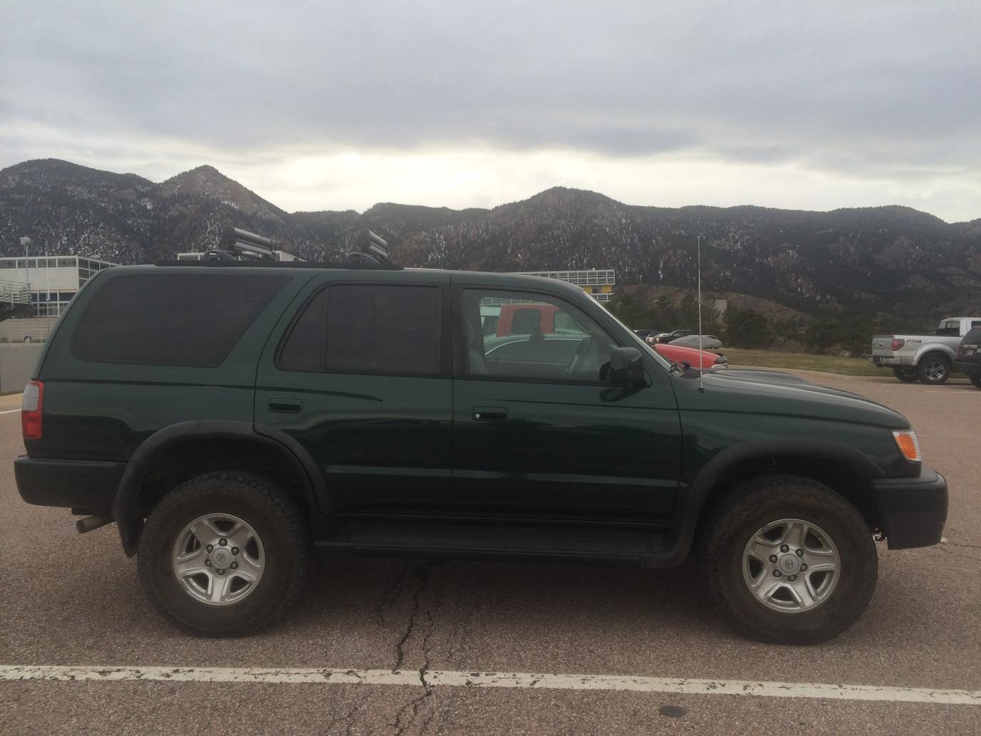

I will get pictures up later, once I actually have them:p But so far, my car has a 3" lift in the back and stock height in the front. MASSIVE rake, and I love the look. What do I do with the old parts now? It looks like Tokico shocks in the back, and the coils still look good. Like I said before, passenger side shocks are destroyed, but the coil is still good. Once I can remove the driver side, those should be good as well.
TL;DR I don't know how to car and I r dumb
Some pictures as she stands right now
Massive rake

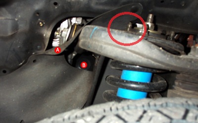

As I stated before, I've been having trouble with a nut on the strut of the top hat, as highlighted below. I've tried just about everything. No shop is willing to cut it or heat it up, so I will have to take it into the dealer on Thursday and let them work their magic. Any thoughts?

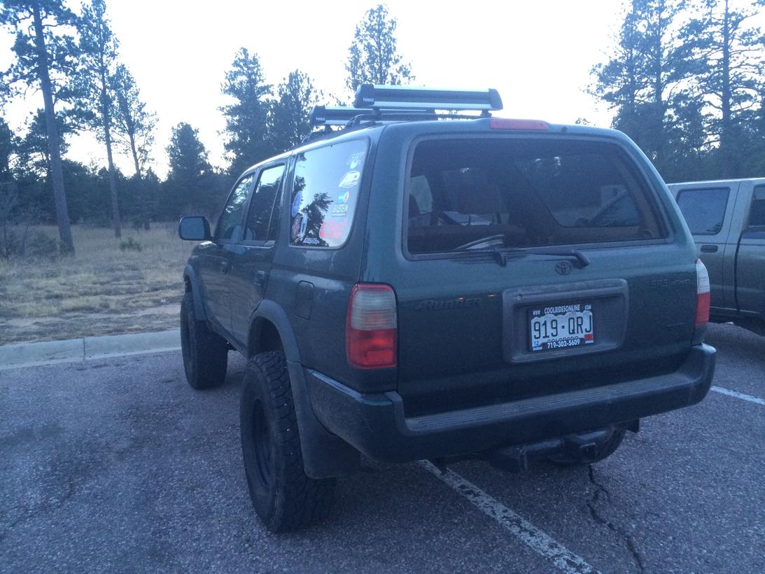

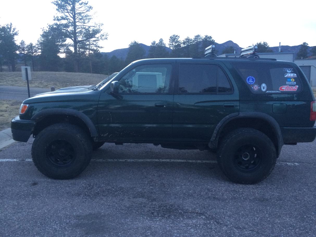

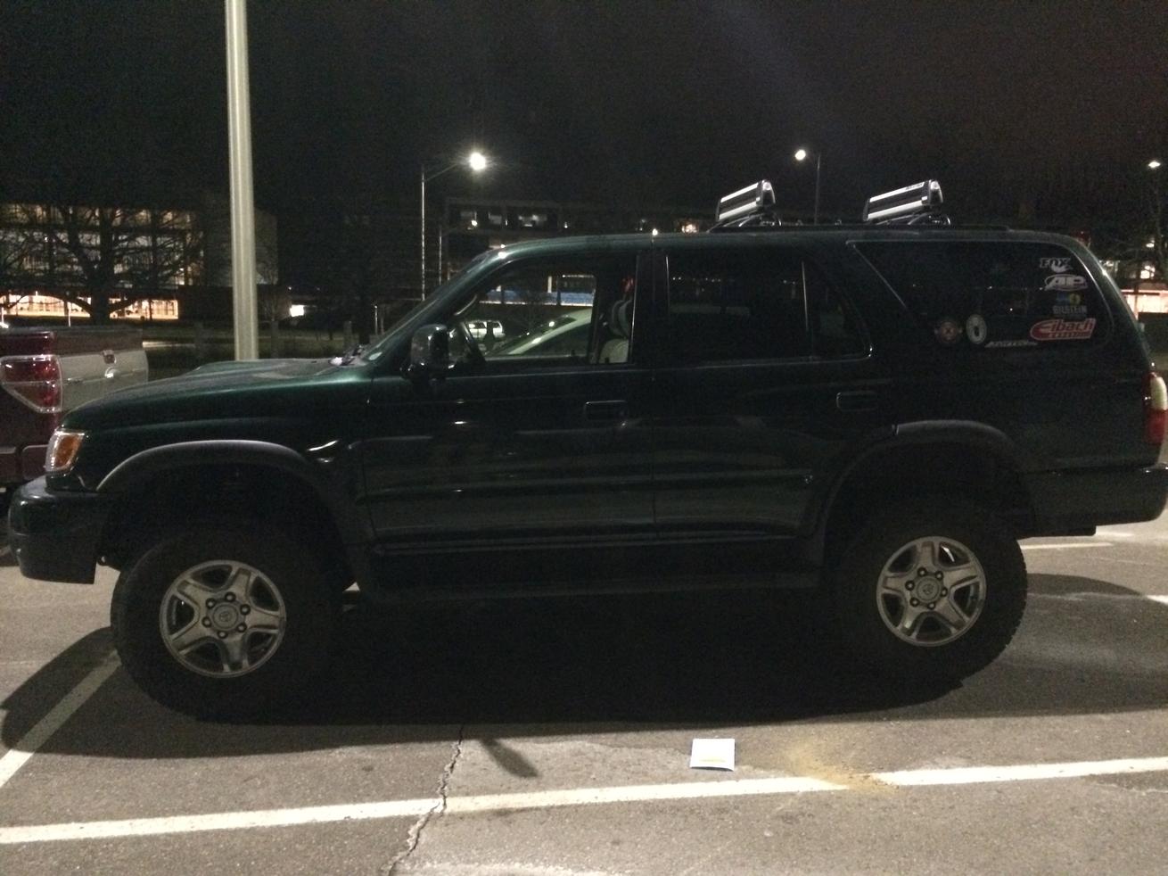

Finally done!!
Front measurement:
Before: 20" fender to hub
After: 22.5" fender to hub
Rear Measurement:
After: 23"+ fender to hub (could be 24", can't remember)
As she sits right now
Things left to do:
Putting on Cooper ATP 285/70/16s today
1.25" AllPro wheel spacers in front, and 1.5" in back
Lose the running boards
Diff drop kit
extended rear brake lines
Future mods (probably in this order):
Energy suspension extended sway bar links in the rear
Remove front sway bar OR DIY disconnectable sway bar links
Change out lower and upper ball joints
4xI rocksliders (after I learn how to weld)

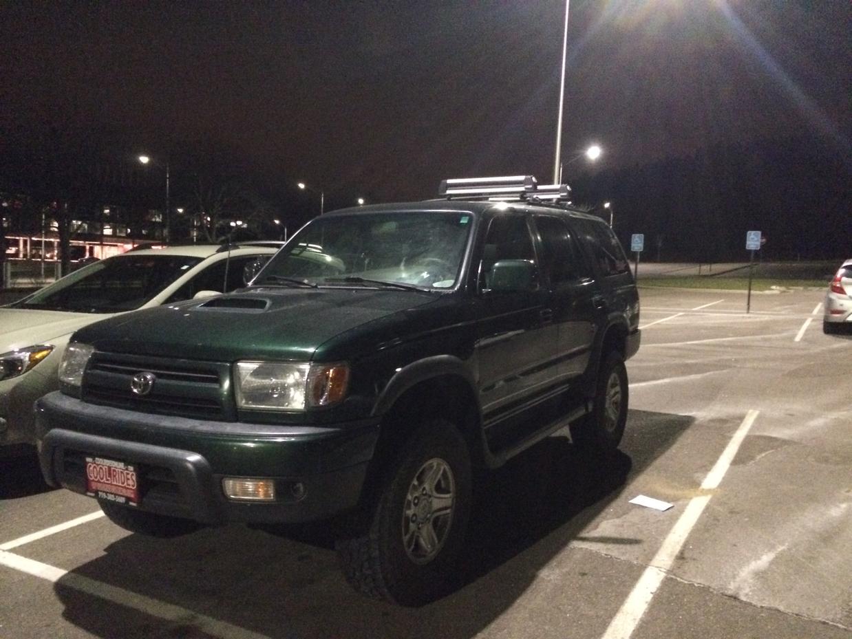

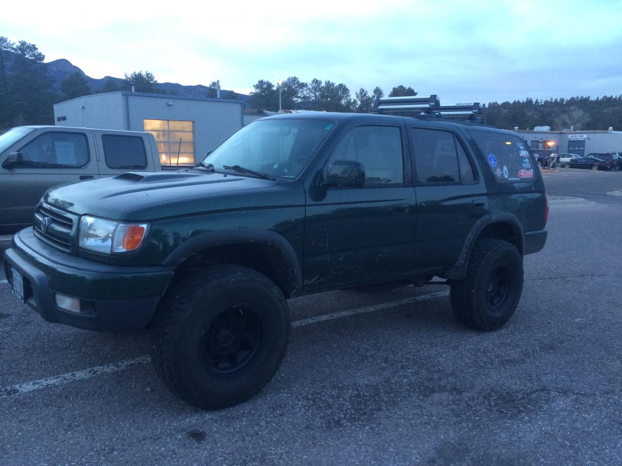

Bae as she stands today:
Next up:
Custom sliders
LBJs replacement
CV Boot replacement (leaky)
Diff drop (still need to install)
Rear Brake line extenders
Light bars along the top
Custom bumpers
