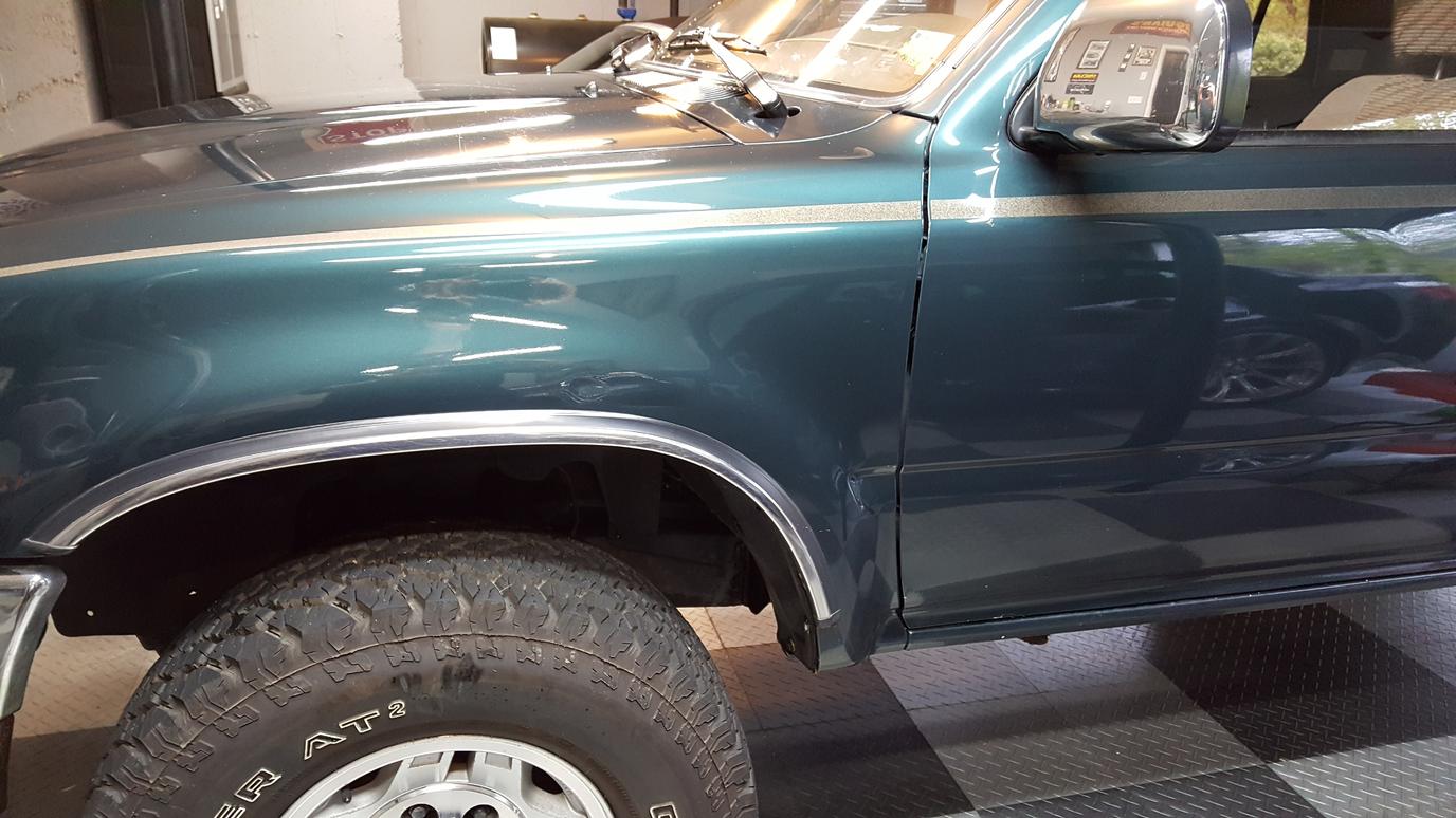

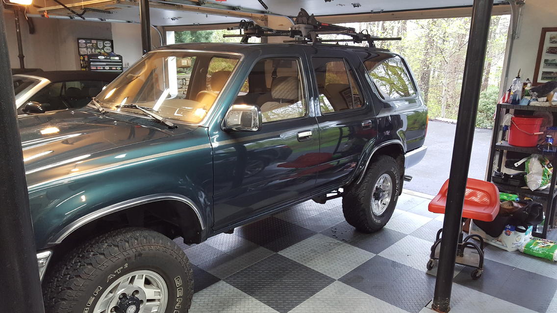

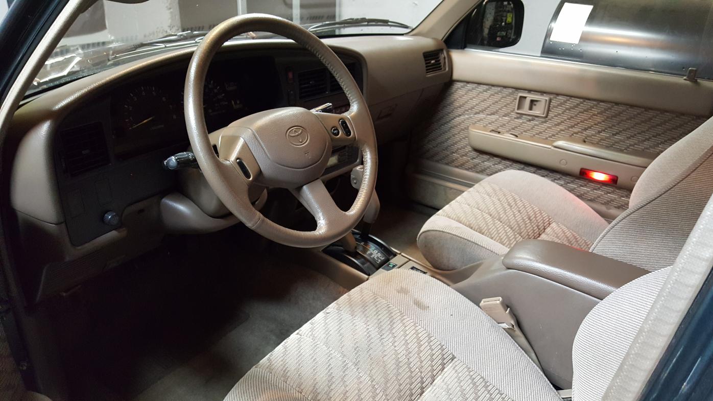

Quick intro, this is my '94 Evergreen Pearl 4runner...amazingly complete and practically rust free which is pretty rare in this area. Its an auto but not a big deal, this isn't a DD, just a run around rig. Got it for a steal and it only has 112k on it and runs great. New 31" General Grabbers and new brakes all around, also has a Yakima bike rack which I won't use but looks cool. I did an air filter change, oil/filter change and went to town with the Porter Cable to bring back the pearl paint effect.
I may create another build thread but for now this is how she stands. I do have a saggy rear and the question I had is can I just add the 1.25" daystar spacers to the rear to bring it up? Its got new rear shocks so the ride is pretty decent and I don't want to do any panhard bar drop brackets or new coils to then have to replace the new KYB's in back so I'm hoping I can just stuff these spacers in there to level her out...thoughts?
