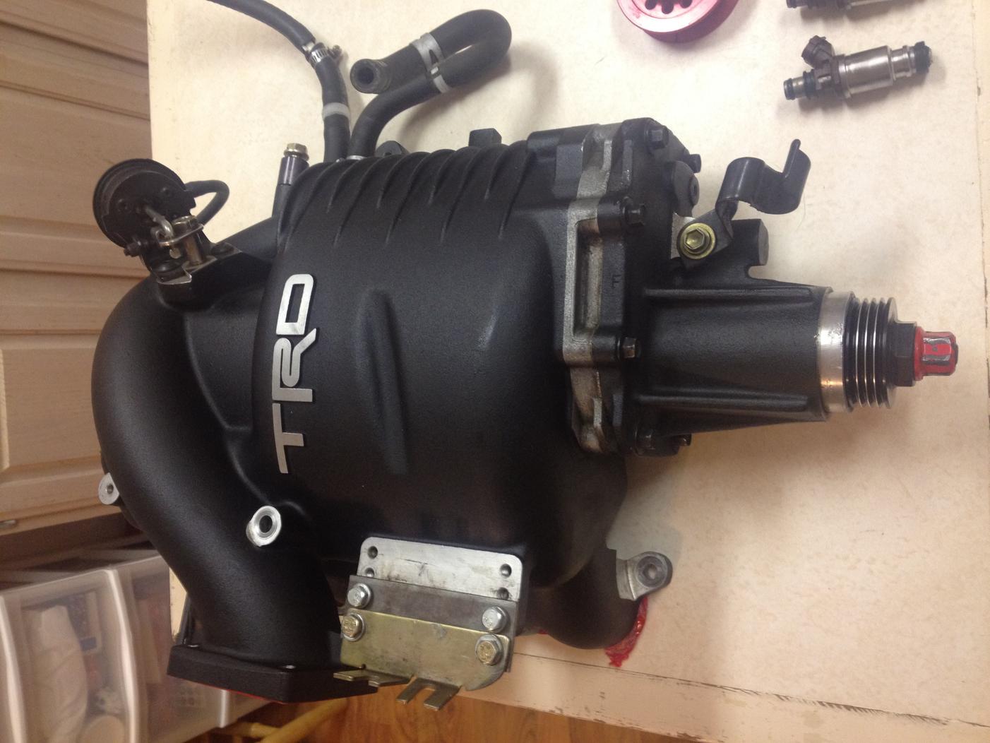

my new SUPERCHARGER :) from ebay

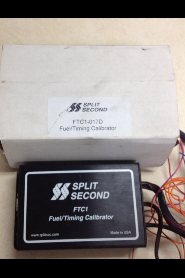

this is my used supercharger off ebay they said it only has 10,000 miles on it and it seems to be in good condition. it also came with 6 larger injectors smaller pulley and spilt second fuel timing calibrator with 4 different tunes on it my original plan was to run the URD seventh injector kit i was wondering if i could run this fuel controller with the urd seventh injector kit?

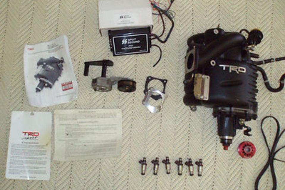

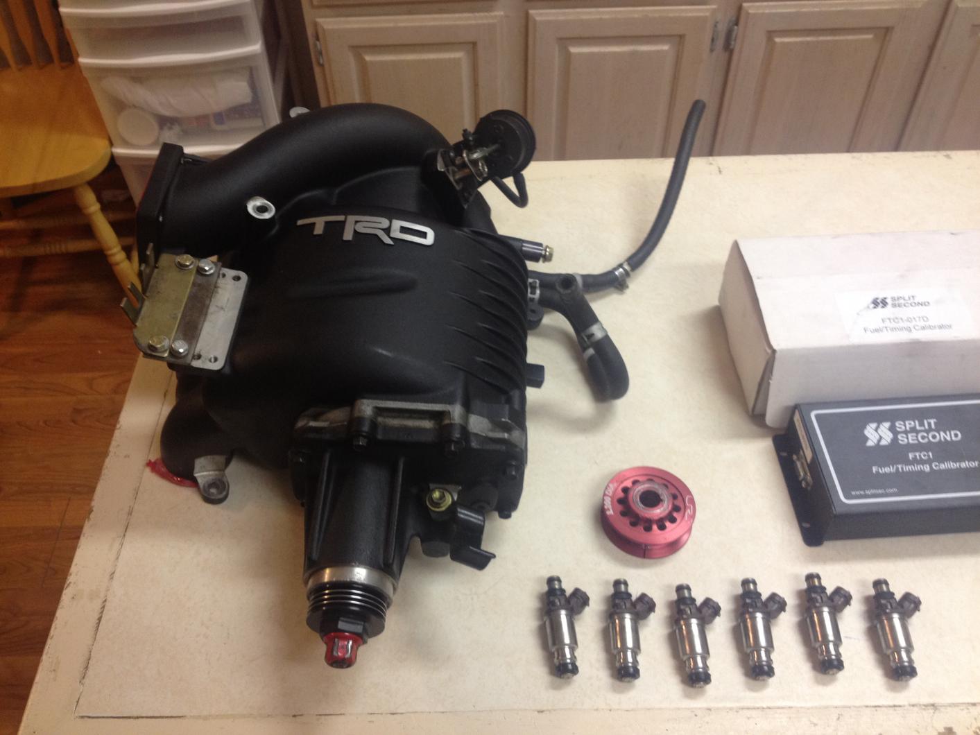

Yeah that's what I was thinking it looked super small il measure them tomorrow. Is the seventh injector allot better then this setup? Il probably just go with this on since it's here and I don't have cash for the senevth injector kit. And also should I rebuild it ?

@ 13.5 PSI, you're running the supercharger @ about 60% efficiency. It will be producing a TON of heat to go along w/that increased boost. The TRD S/C is an Eaton M-62 and the max boost that it is designed to put out is right around 13 PSI, so it CAN be run like that, but it will take alot of tuning to get it running w/o detonation.
Not to mention, the rotational speed of the S/C is about 15% higher w/the 2.0 pulley VS stock, so there's some added wear/tear on the bearings too.
The 7th injector is easier to tune, because you're only adding fuel where the stock system can't keep up, but w/the 6 injector setup, you've got to tune the entire power band. The 6 injector setup can supply more fuel overall, and with that tiny pulley I can see why the previous owner was running that versus the 7th. There's also a reason why they needed FOUR tunes. When you've got things running @ the limits, if even a small variable changes it can throw off the tune enough to make the truck unsafe to drive. He probably had four tunes for the various driving situations he'd encounter... (elevation, fuel quality, winter/summer, etc.) Those tunes may or may not work for you.

So now I need to tell you that from personal experience, tuning with 6 Injectors is a HUGE pain in the rear. I paid a very well known professional here in the Seattle/Bellevue (Tuned my cousins 750+ HP Turbo M3 and my Dads 916/512) area hundreds and hundreds of dollars and even he told me he was having trouble, and couldn't get it right after probably 50 pulls on the Dyno. Granted, I was not running the FTC1 (I have records that my vehicle had it at one time, but was removed because it was doing something crazy and keeping the fuel pump running when the vehicle was off).
When I got the 7th injector kit the driveability of my 4Runner was FAR superior than the 6 injector setup and the guy who was tuning said he felt bad charging me for tuning, and only charged me for the 2 dyno runs (that's all it took) and said it was 100x easier to tune. Street tuning myself, I can say the same.
If you're dead set on running those 6 injectors I have my old maps from when I was running them as well if you want them. I highly recommend that URD pulley though... I think I remember you lving near sea level, and I feel that's far too much boost without much more expensive modificiations...
I also have a copy of the spit second R4 software I could send you, if needed.
