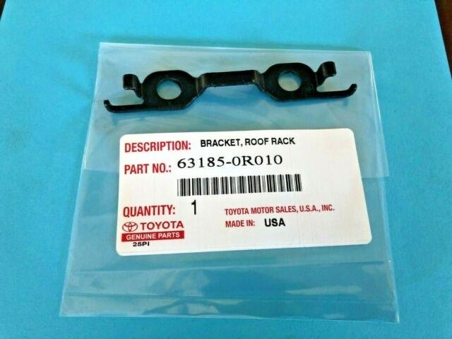

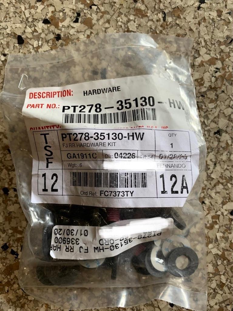

Why didn’t you just use the TRD Pro rack install kit ? Comes with bolts and washers. But you still need to add the support brackets.

Yea but if you would of used this kit in the first place, you won’t need butyl and rubber washers.
Toyota engineers designed the roof rack to be used with these components, why contest them ?

The factory washers are very thin, and compress when you bolt on the rack. Thus, they should always be replaced with new washers or sealant when removing/replacing any of the fasteners. Some people say not to use silicone sealant, but that is what I used when I put on my new TRD Pro rack. Just be sure to get a quality product.
To prevent the threads from getting rusty, you could put an oil on the threads or use an anti-seize on them. Remember, that even if you replace the screws with stainless, the threaded holes in the roof are still mild steel and will rust if moisture gets to them, that is why you must use good/new washers or sealant.
One other suggestion: go to your dealer and get the installation instructions for the Pro rack. Toyota has all installation instructions in their document library and the dealer can find it using the part number. Sometimes you can find instructions on line, but I was not able to find them.
With the instructions, you can see all the parts and assembly steps needed to insure no moisture gets into the headliner.
