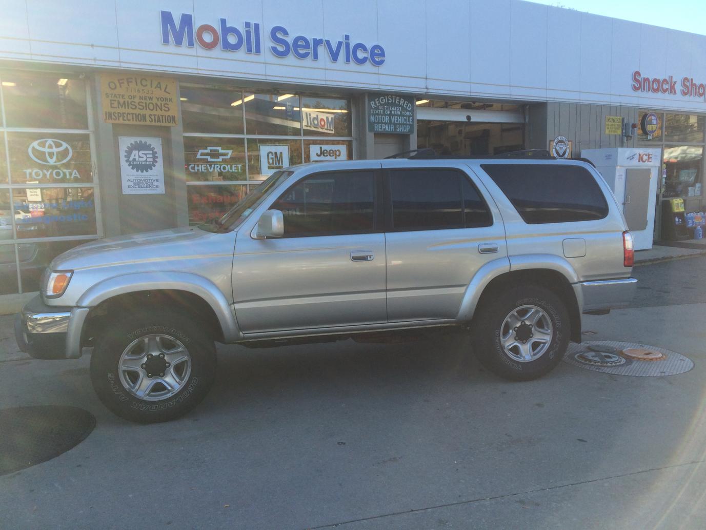

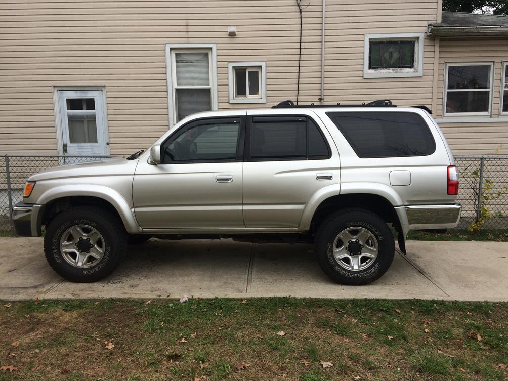

I install the ome 906s with Bily HDs last weekend, pretty easy job.. Much improved ride quality love it... looking forward to do the 880s this weekend :rockon:
Before and after pics below

Just put mine in today. Ride is definitely improved and no more nose in the air. Went from 20 7/8" (on original '99 talls) hub to fender to an even 22" on both sides, dead level. This is with a full tank and my usual ~100lbs.+ of tools and recovery gear in the back.
The front, still with factory '99 talls, is also at an even 22" both sides. So I hope they don't sink much with time. (Before anyone asks, bumper is being painted and chrome fender trim is coming off. Metal looks fine, underneath, after a little work.)
