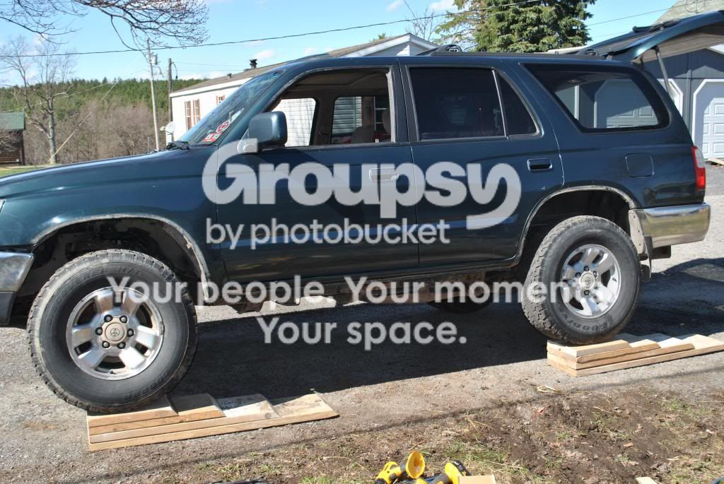

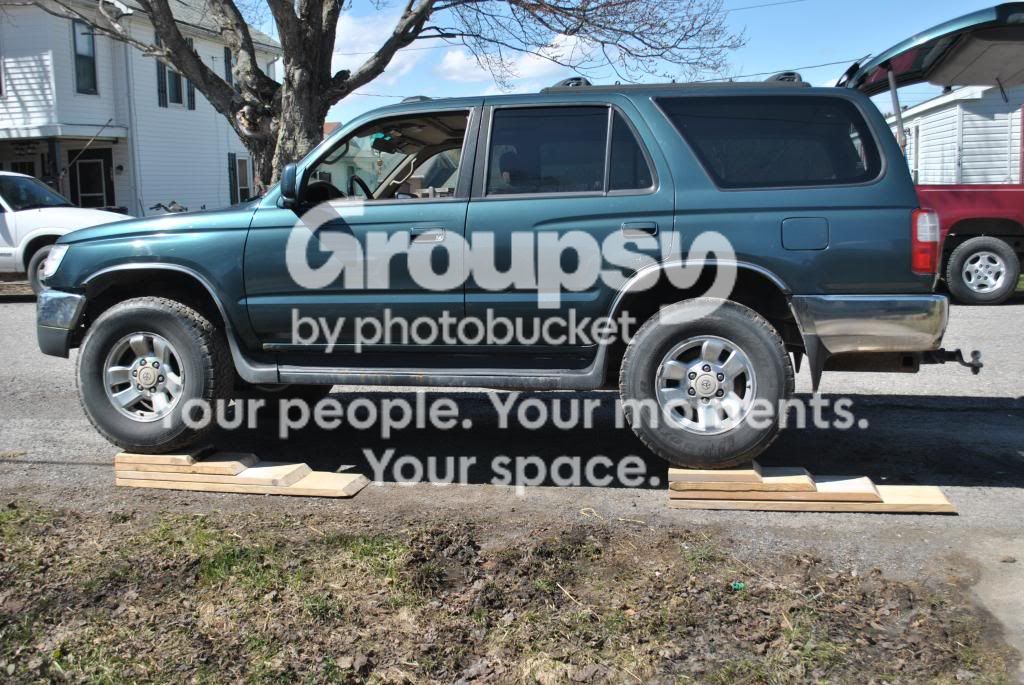

today, i put the truck up on the trusty homemade ramps with the intention of 86'ing the rusty OEM running boards. here's a pic or two:
before:
after:

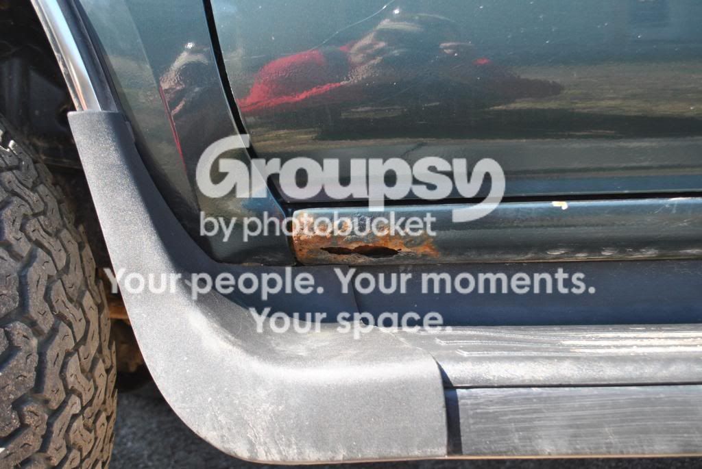

and i'd love any suggestions or advice on my best plan of action to repair this spot. cursed rusted rockers. :( do i cut this out and tack in some new steel, use fiberglass, bondo? if there's a comprehensive thread on body repair, i'd love a link. this makes me sad:

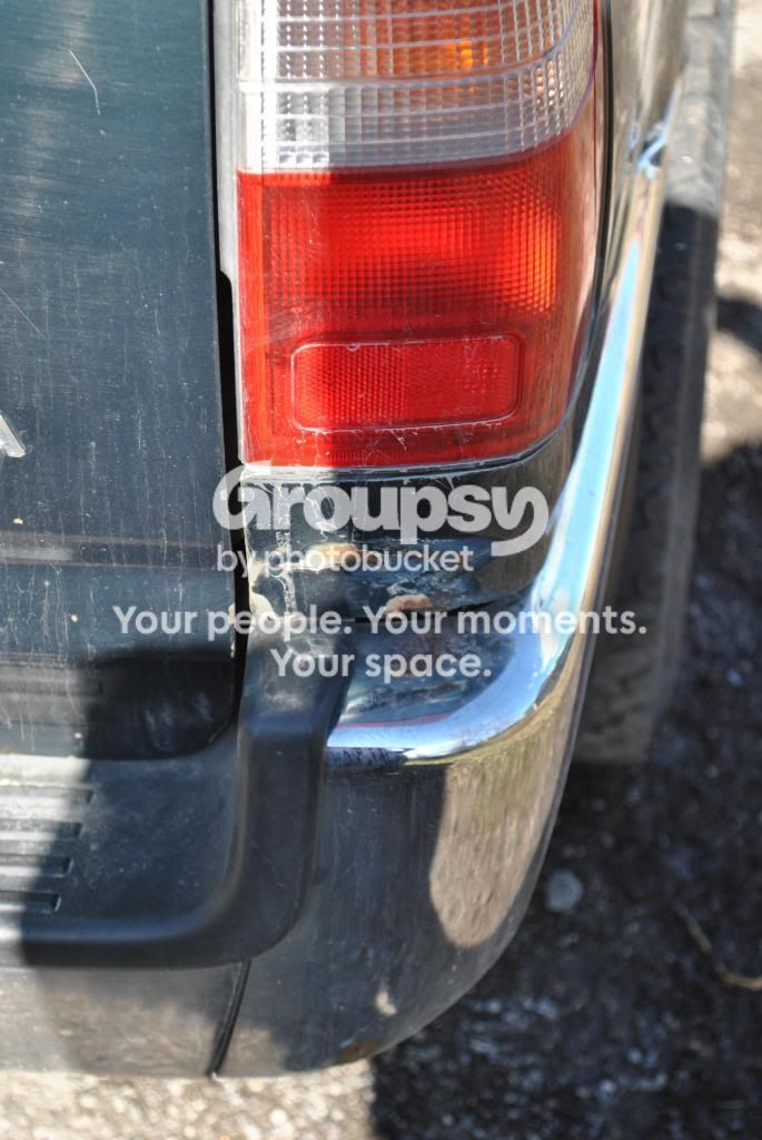

i also have a spot i'd like to fix under the passenger tail light, suggestions are welcomed:

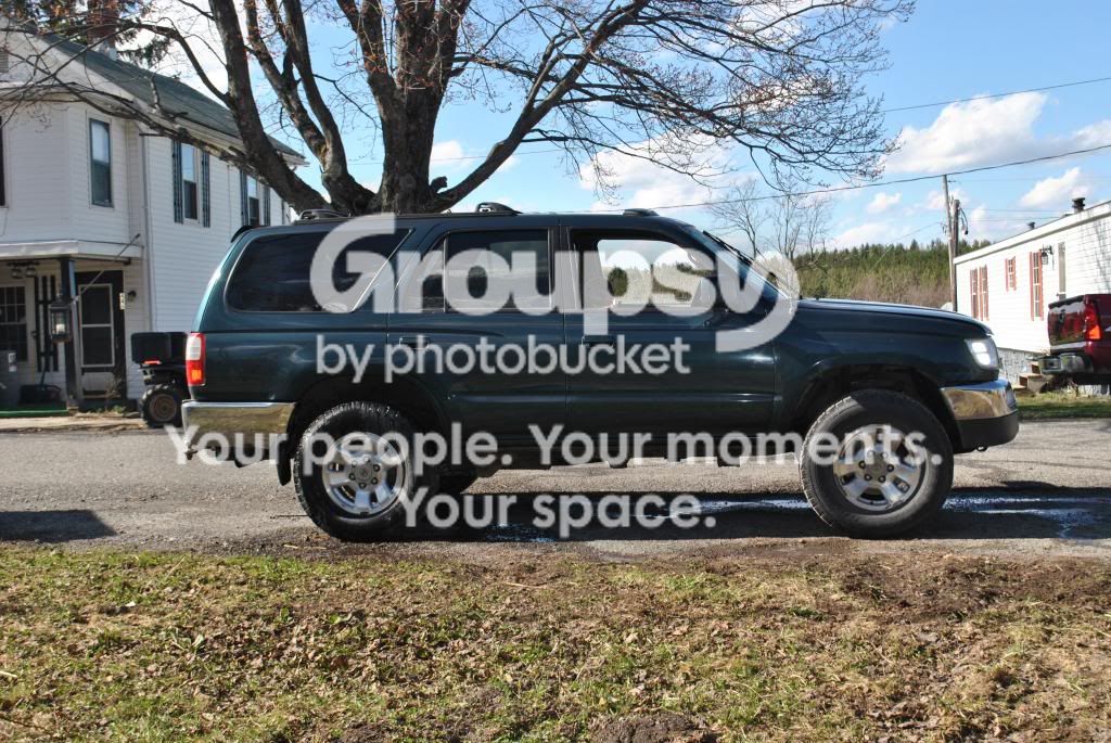

running boards and etc. gone and i like the look, but want to invest in some kind of nerf bars in the future, simply because i like having a step.

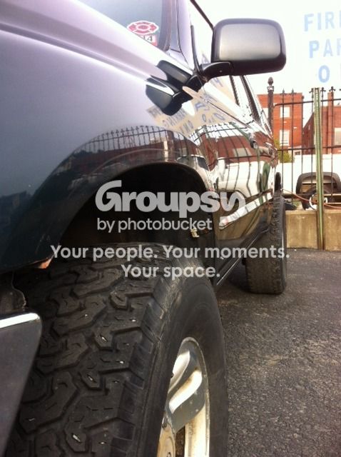

i most certainly prefer the look without the fender trims:

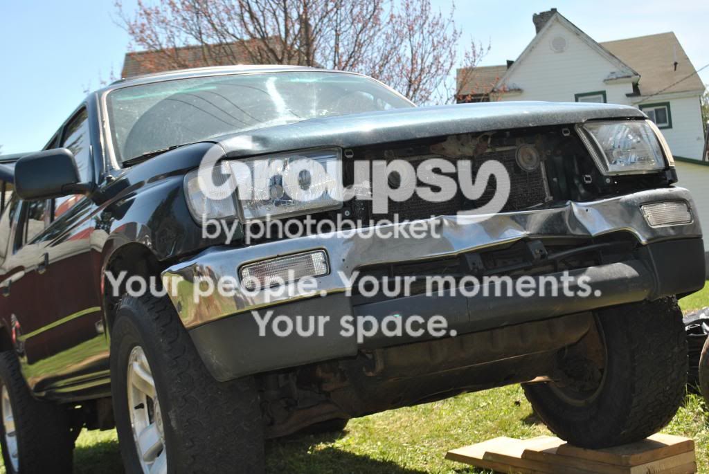

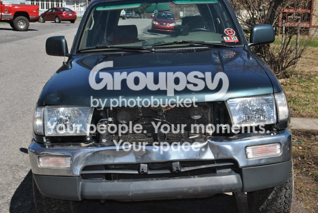

here's what can happen when a big fat whitetail deer steps out in front of you at about 60mph:
no worries though, it was an excuse to get some '99 headlights, corners, and turns. and parts to do nose surgery should all arrive this week.

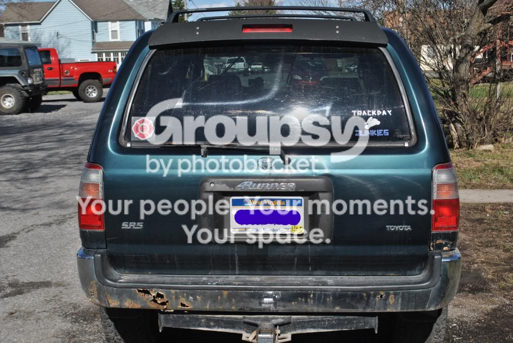

and a shot of my lovely rear bumper, also on the soon to be replaced list.

I think for the rear dent by the right tail lamp, you have to remove the tail lamp and then you can access the dent from that opening. Remember to give a small push outwards (not to the rear but to the side) to pull the tail lamps.

Tinker Away at er and you'll have it looking like new in no time. Im just in the home streach of repairing my rocker panels which were wayyyyyy worse then then yours. I got new ones bent to fit and welded them on, body filled the cracks. If you plan to body fill your cancer holes just remember to grind off alll the rust, get it down to good bare metal or 4 months down the road your gonna see rust forming through your paint!

roger that! i figure i will just cut out the bad spot on the rocker and under the pass tail light and weld in some new steel. then finish and paint. plus i love to tinker.

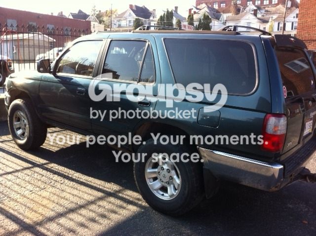

a few more pics.
buffed out with rubbing compound but still needs work. i was doing it during downtime at work yesterday:
with some more elbow greese, i think i can still bring the 16 year old paint back out to nice shine:

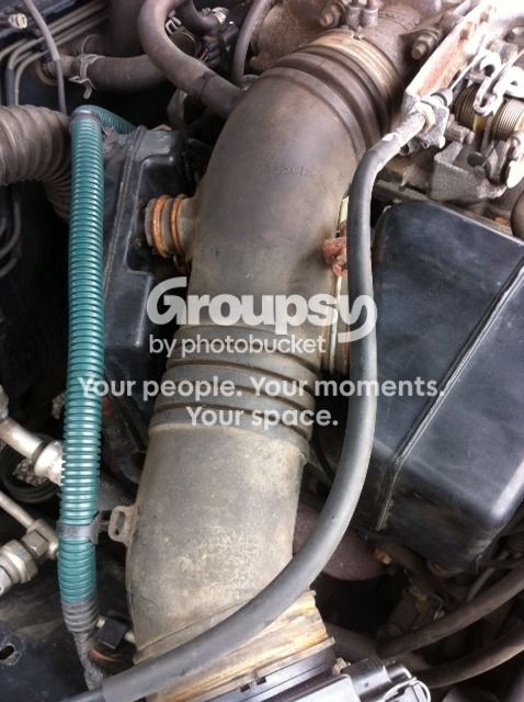

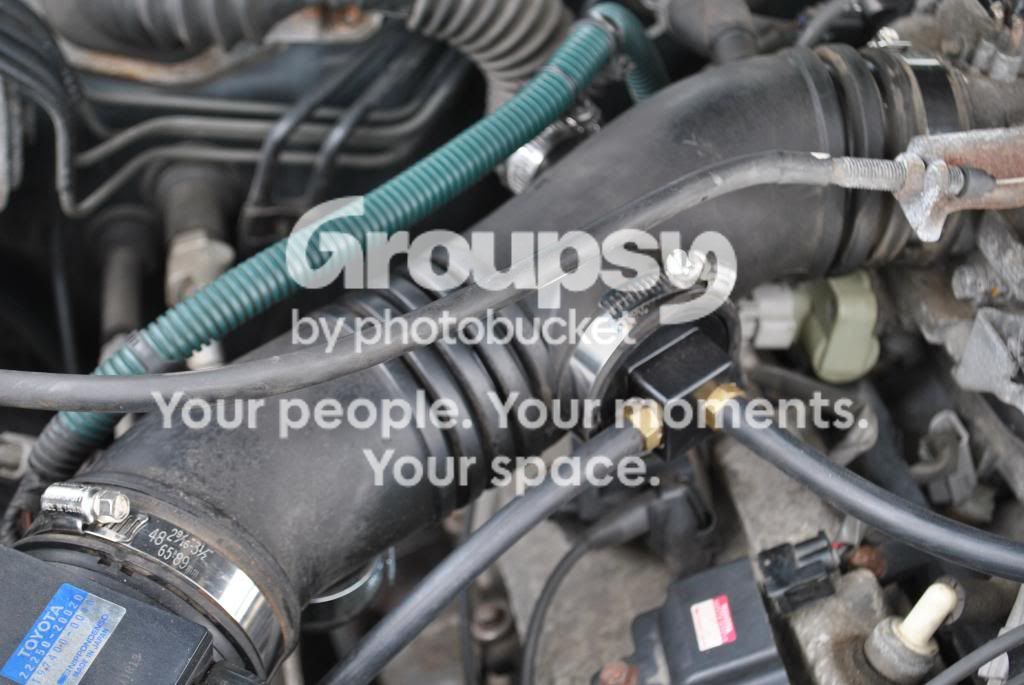

did the ISR mod today, too easy, and cleaned it up nicely.
nasty clamps
much cleaner:

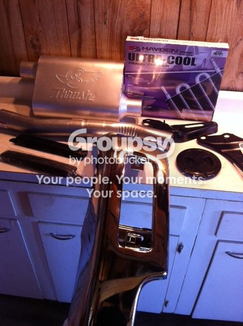

some of my parts that i ordered last week came in today.:banana::banana: deck plate, chrome bumper, bumper brackets, tranny cooler, and head light filler panels all came today. i'm just waiting till a new grinder gets here to do the muffler so i can clean the frame and paint near the muffler when the old one is out. figured i'd try that thrush muffler because it was inexpensive and seemed heavy duty. i'll just weld it in.

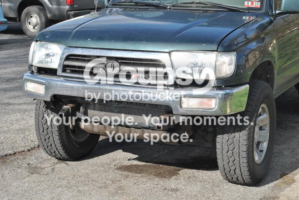

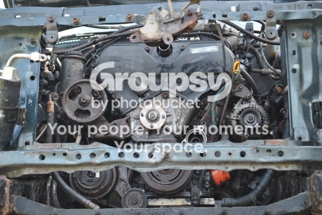

once i rip the front end off, i'll hit all the rust i can reach with the grinder/wire wheel, and paint as i go. i'll be replacing engine belts, and rad/tranny hoses with new also. i recently burnt up my old grinder, so i'm waiting on a new dewalt to arrive. once i have all the stuff i need, i'll tear into it. really looking forward to having a straight front end.
i just did the deck plate mod today since it was fast and easy. just used a hole cutter on the cordless drill and some sensor safe sealant. i need to get a small piece of cable to attach the cover so i can leave it in the engine bay when not in use. you guys all know what that looks like so i didn't bother with pics. it's black. lol

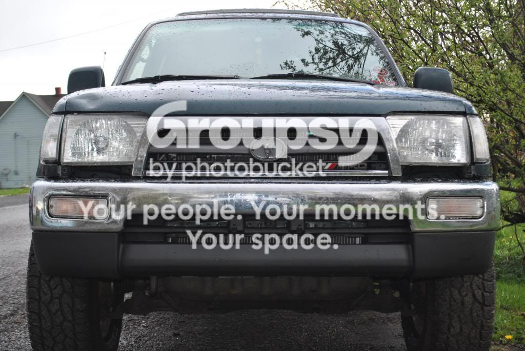

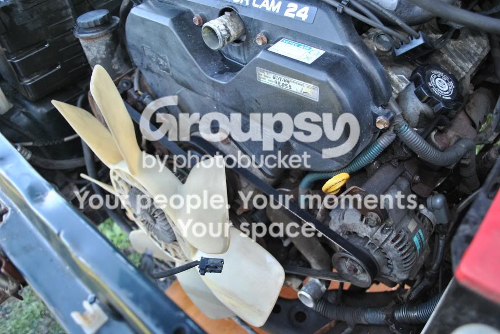

i've been a busy man the last couple weeks. most of my parts came in for the ole runner. i got a lot done to it. new stat, belts, rad and hoses, tranny cooler, bumper and grill. they sent me the wrong valance so the proper one should arrive wednesday. i still need to get to the wiring upgrade and i decided to leave the AC condensor off for now. our two weeks of summer here when we get up to about 80*F, isn't really enough to justify spending more $ on AC parts at the moment. i may get around to it, but i just bought another toyota that blows really cold AC so we shall see. enough talk, moar pics:
some tunes, a little PB blaster, and some T4R.org for reference and i'm ready to tear into the project
one last pic of the catfish mouth grubbing for chicken livers :fishing:
out with the old
in with the new
as it sits now
i need whatever brackets hold the headlight filler panels on. must've lost those when i hit the deer

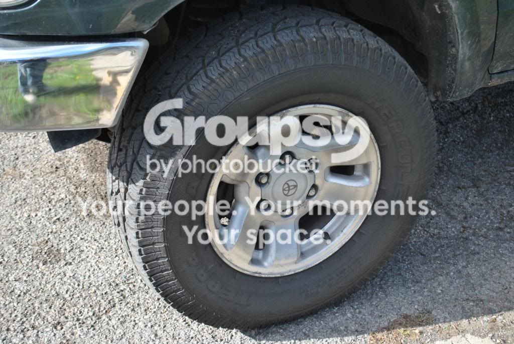

i also got two of these mounted, i'll get the other two next month
i still have some tweaking to do to get the lights lined up properly without the angled gaps, but this is a huge improvement IMO. i also plan on doing some kind of grill mod, i just haven't decided yet.

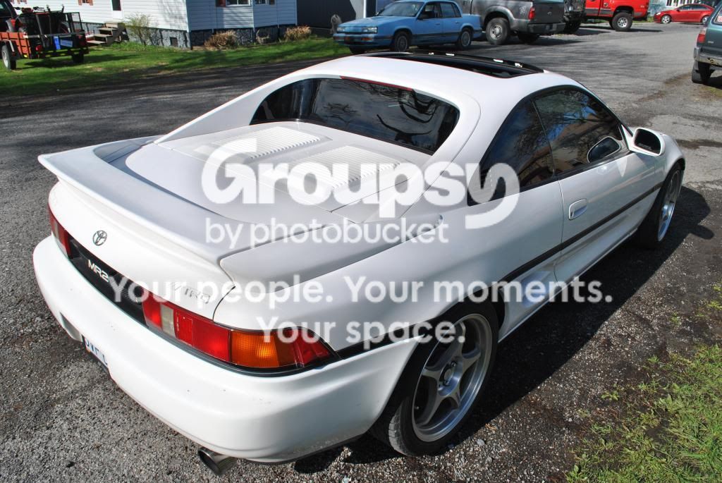

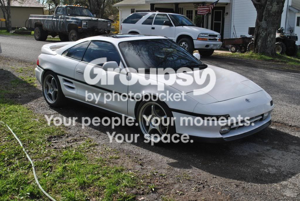

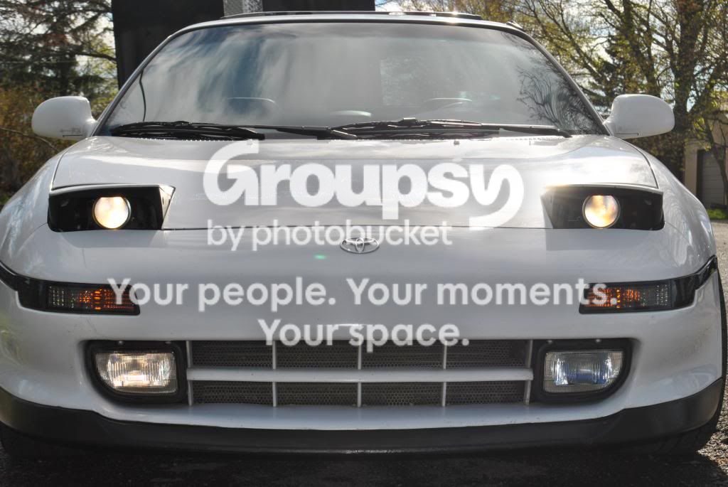

dang near forgot to post a pic of the new-to-me toyota. it needs a little work, but it's pretty solid for it's age. i've wanted one of these since they came out and was in a position to get one, so i did. any of you guys have one of these?
1991 Toyota MR2 N/A 5-speed manual, 136,xxx on the clock
already replaced fog bulbs but failed to get a pic :der:
it's got TRD suspension with coilovers, TRD strut bars front and rear, 17x8 5Zigen in front, 17x9 in the rear, white gauge faces, cold air intake, NGK plugs and wires, blue leather interior, full stainless magnaflow exhaust.

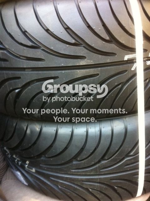

it has a bad axle seal, and a leaky distributor. those parts are already ordered, and i just rec'd these to strap onto the front. then i'll take it for an alignment.
bumpin it up for a new valance! the right valance. :woot: still need to order the filler panel brackets. i was waiting to make a bigger order since i'd have to pay shipping on such an inexpensive part. the fitment isn't perfect on any of it yet, but not too bad for cheap crash parts IMO:
still debating what i want to do with the grill mod, but something will happen there soon. doing a few things to the MR2 as well, so there's a lot going on.
ETA - just wanted to say that i'm really pleased with the way it runs with the ISR, deckplate, and new muffler. sounds great, plenty of power, and seems to be pretty decent mpg, although i haven't really taken an accurate account yet. i learned all that stuff right on this site so thanks to all here.
