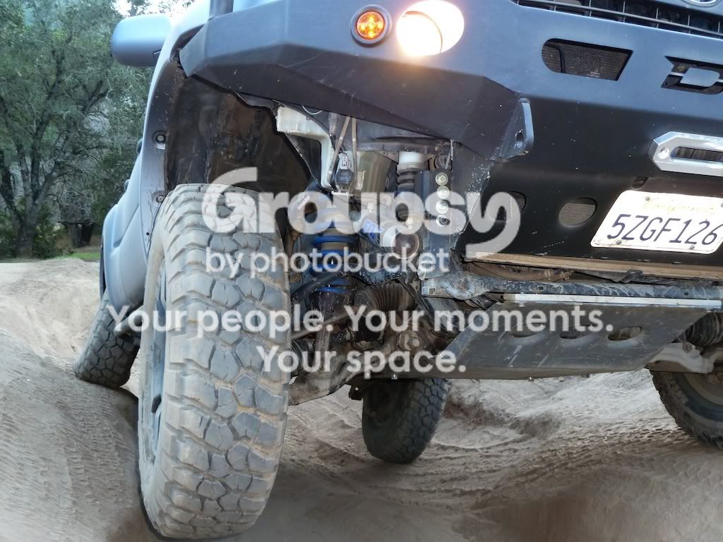

Sounds like a solid plan. BlairB is running Fox suspension. The diff drop is probably unecessary though.
P1030249.jpg~original
