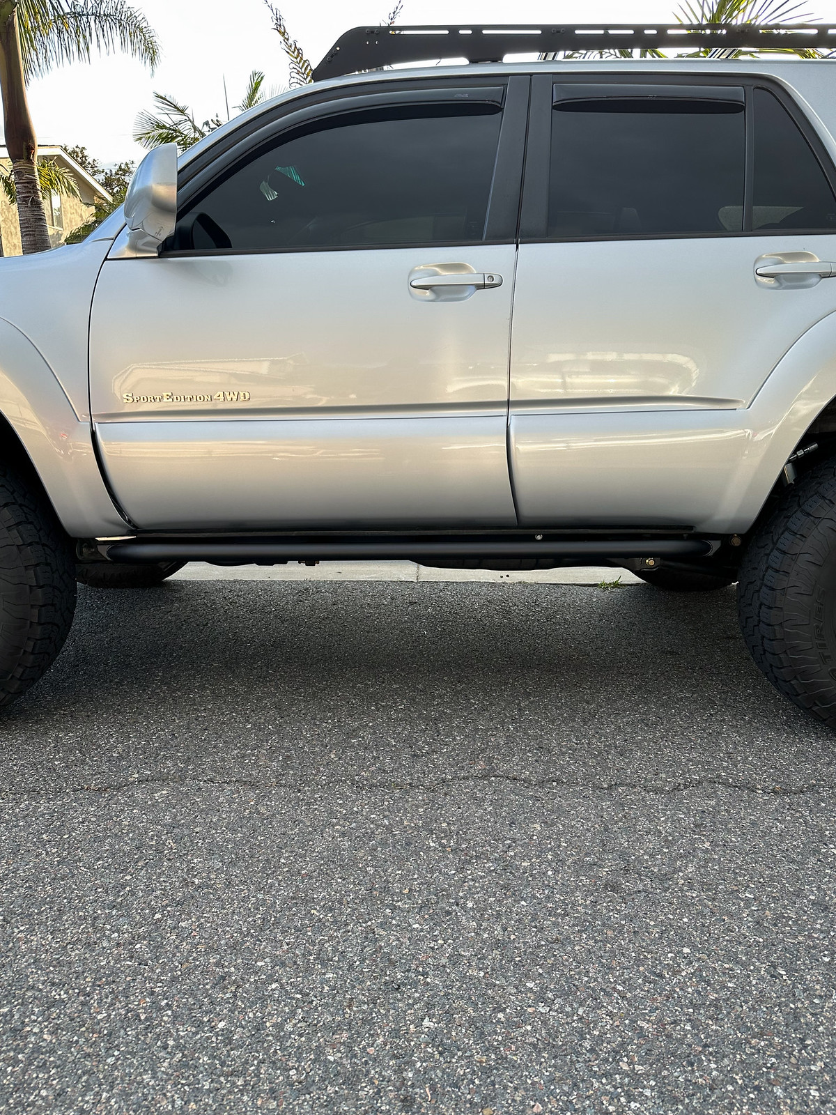

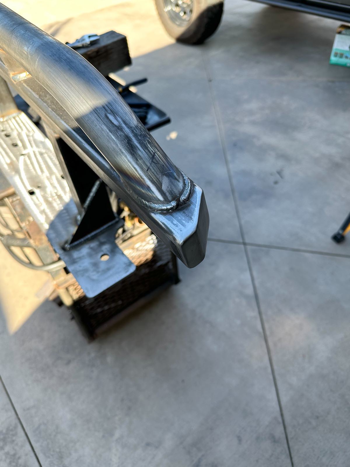

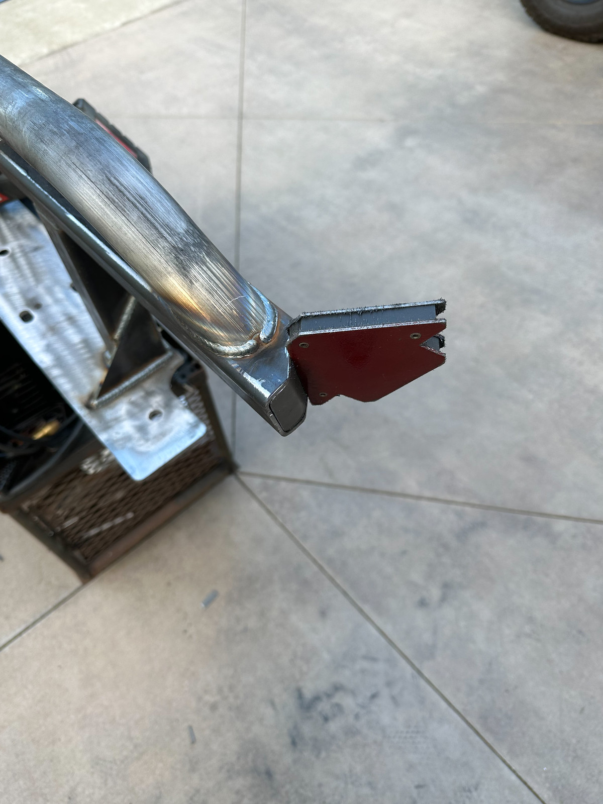

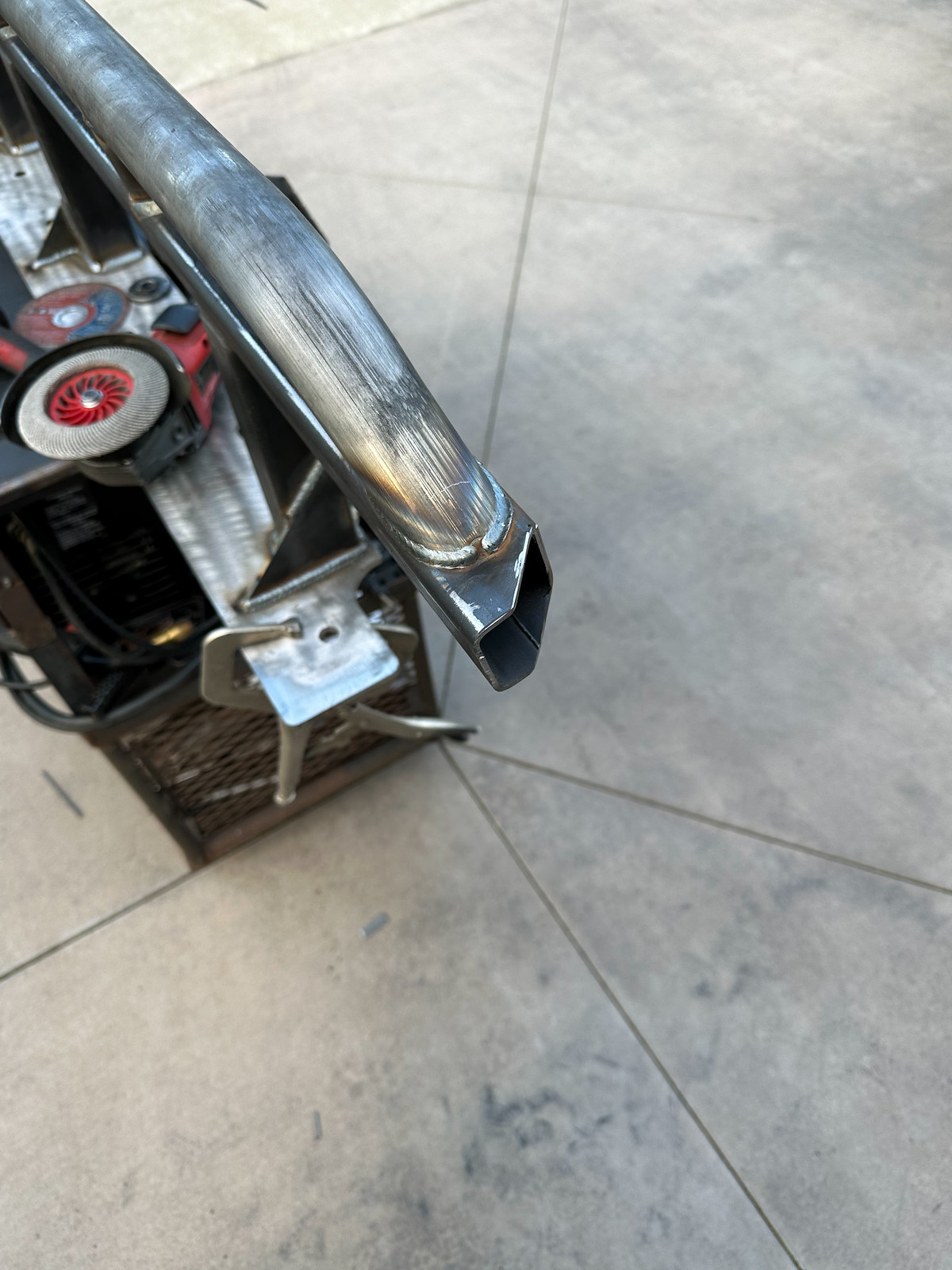

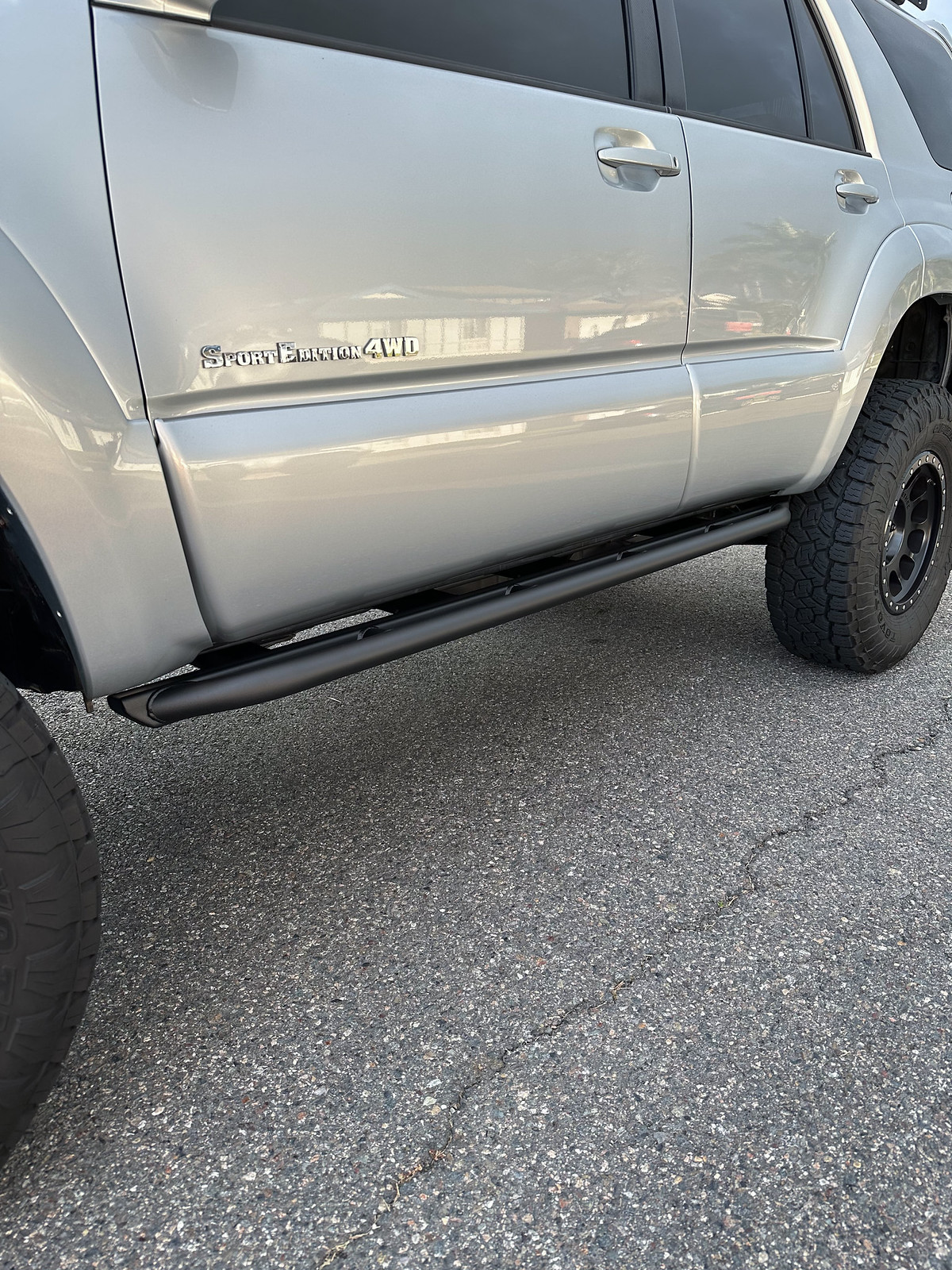

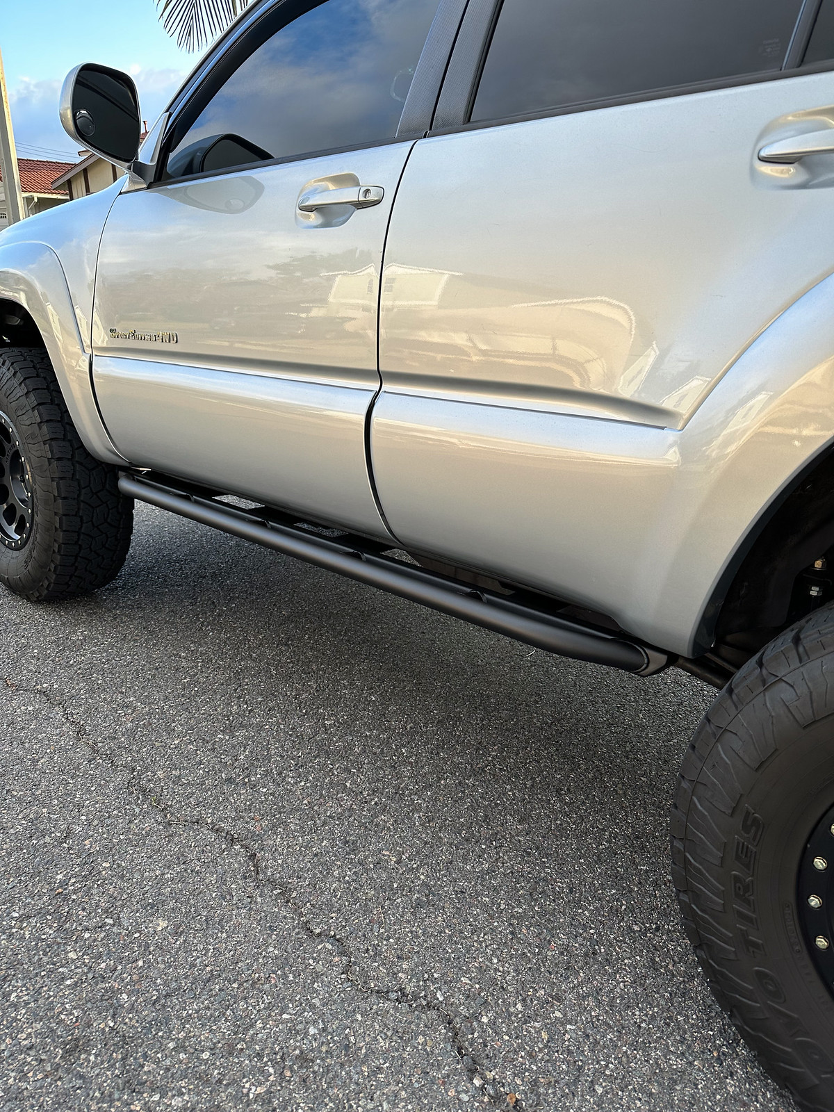

Put my sliders on over the weekend. They're the Demello "Hybrid" sliders, but I changed up the ends of the main 2x2 square tubes. Demello does a straight cut and cap which I didn't like the look of, so I cut them at an angle I liked and had my friend weld in a cap. Kind of ridiculous haha, but I think it gave them a much cleaner look.

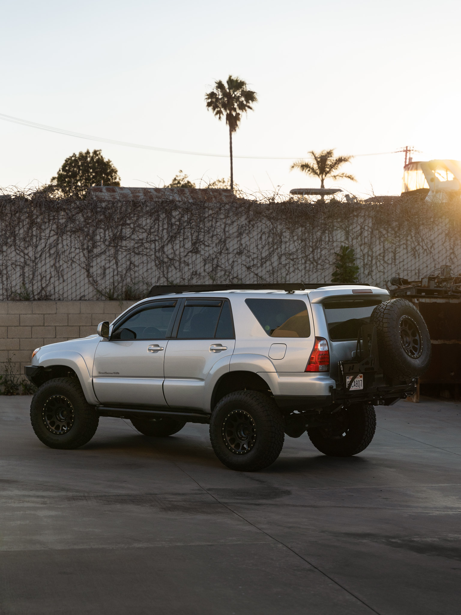

I want to run a similar wheel/tire setup as yours without BMC if possible. Did you do have to do BMC?
Are your tire loads C rated or D Rated? How much did it affect MPG/acceleration with your v8?
Nice rig.
Thank you! Yes I did a BMC along with flattened pinch weld and some plastic trimming. You'll have to do a BMC with basically any tire 33" or bigger from what I've seen, but wheel offset is a big factor as well.
Hard to say on the MPG because I never really tracked it before and after the tires. I seem to average 16 MPG on the freeway and 13 around town, but I can obviously get more or less if I adjust my driving style. Keep in mind I have front & rear bumpers, sliders, and roof rack so those all contribute to the fuel efficiency also.
My tires are E rated. I'll probably try and find something D rated next time, but I got a deal on these I couldn't refuse.

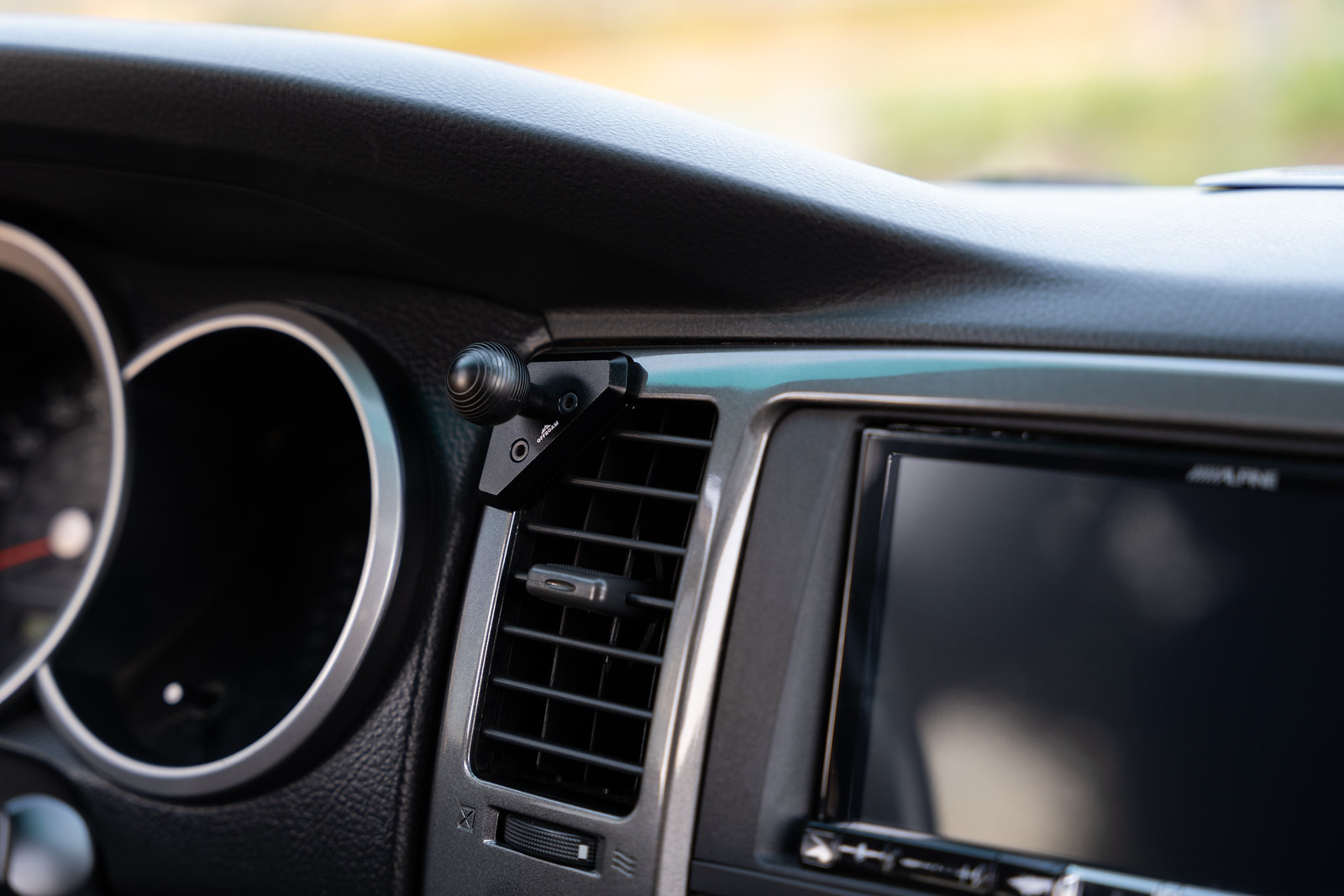

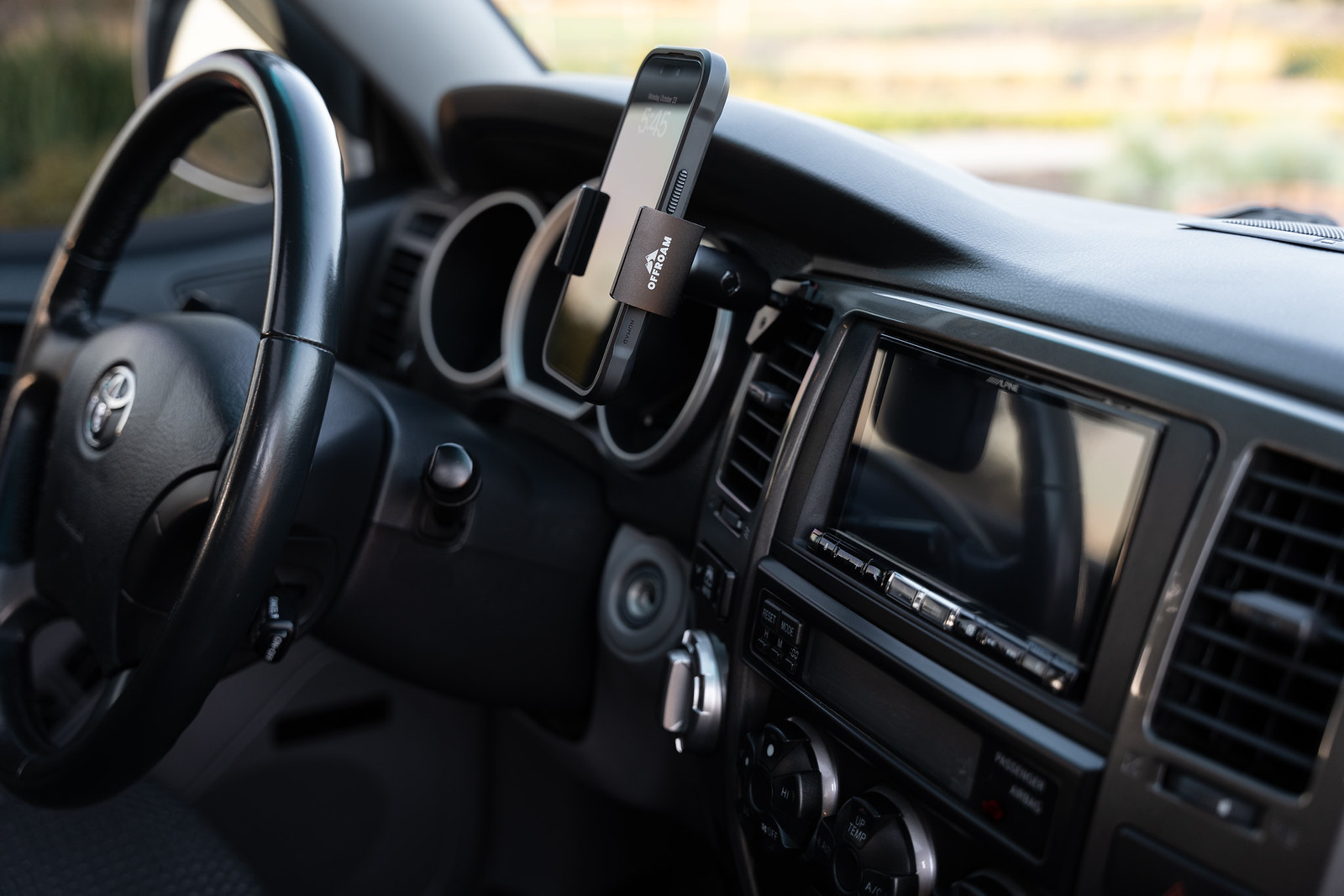

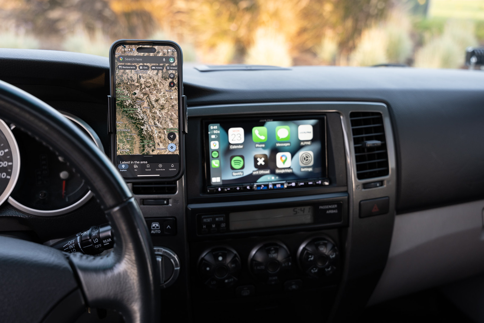

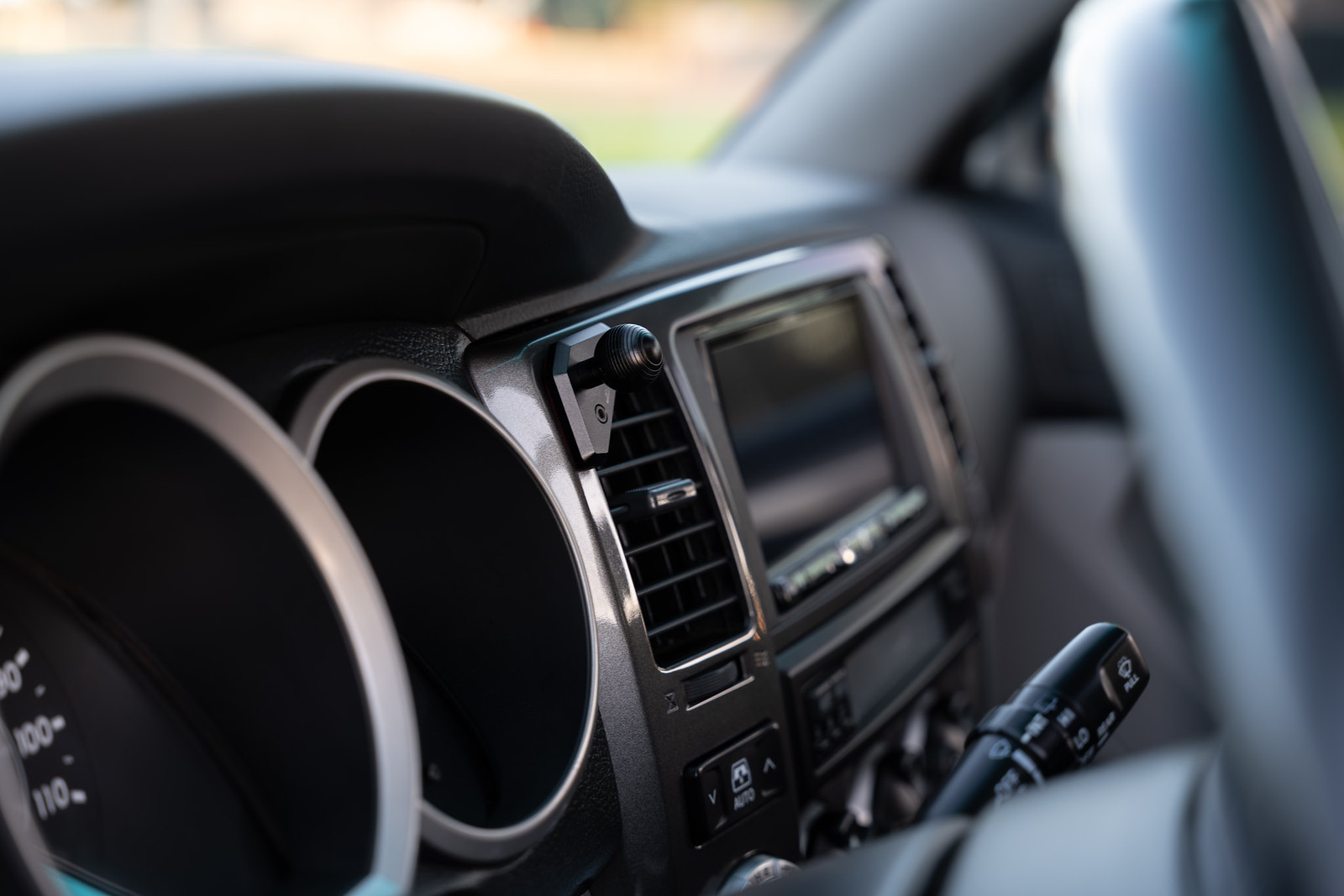

Recently added an Alpine iLX-507 headunit and OFFROAM's new 4th gen phone mount. So nice having CarPlay and all the additional vehicle information the headunit can now display. Combined with the phone mount it's really helped make the car feel more current technology wise and I love the clean uncluttered look.
Couldn’t agree more, CarPlay is one of my favorite things about my modern head unit!

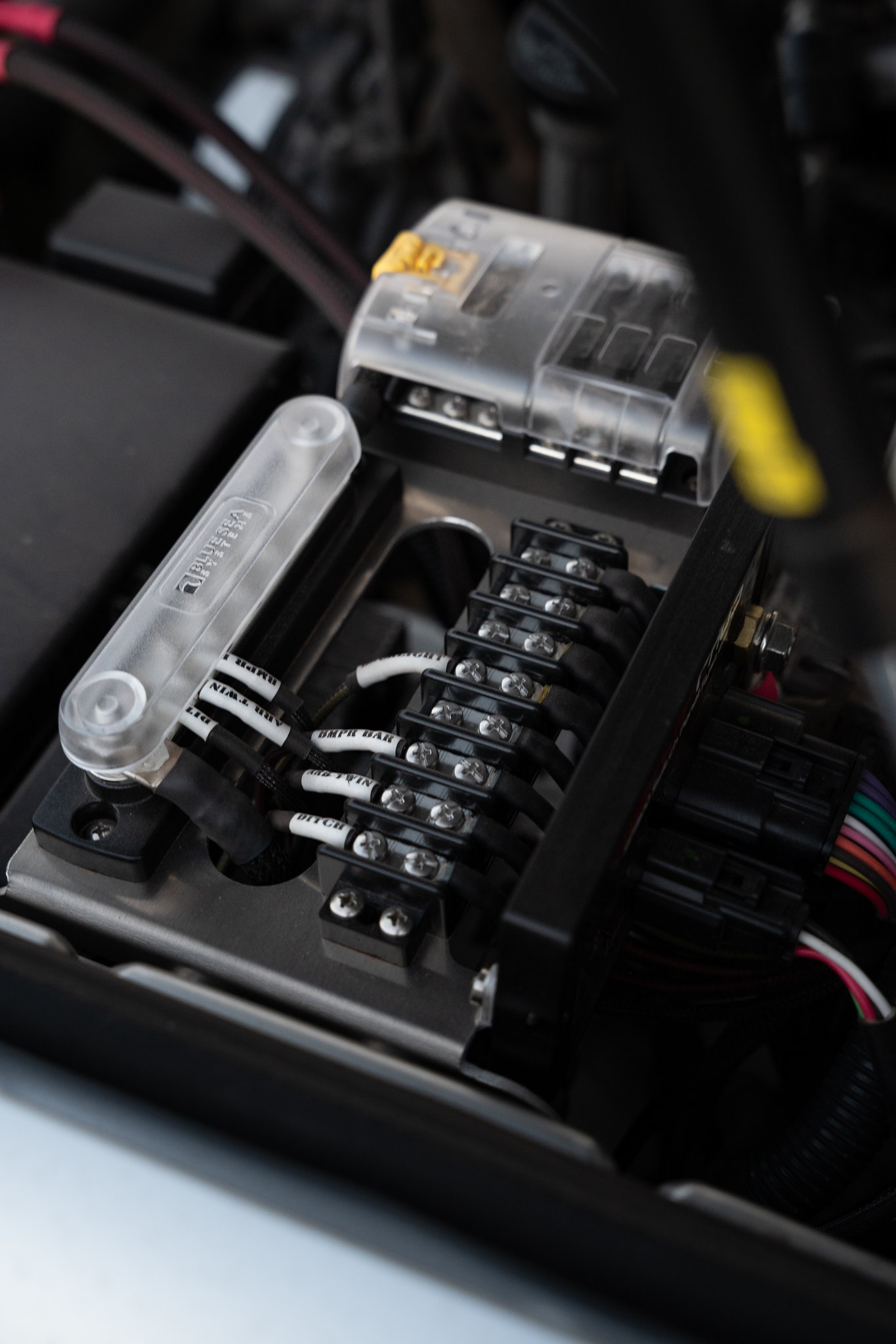

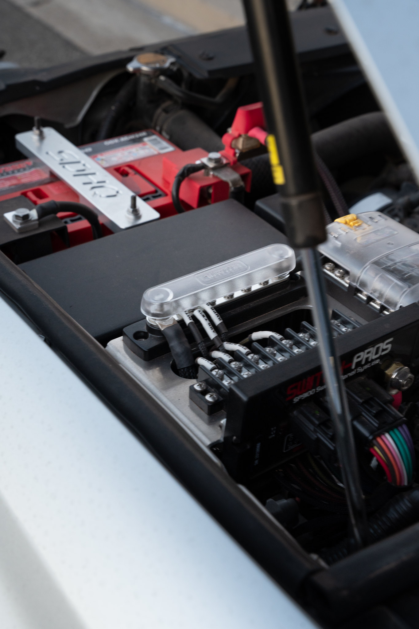

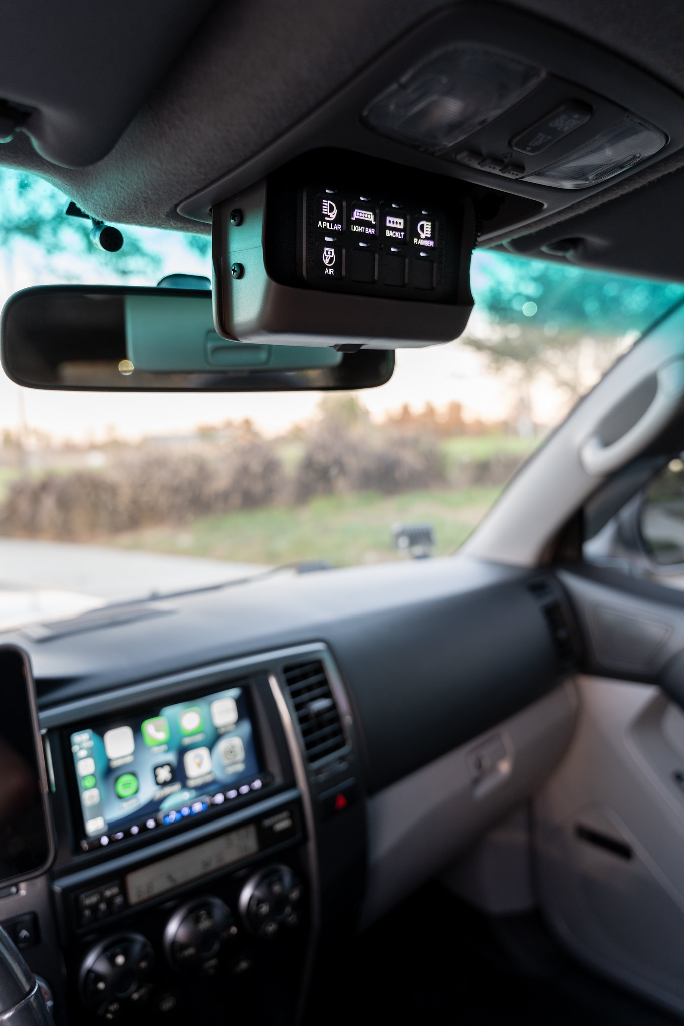

Upgraded & organized my accessory wiring to clean up the engine bay and get rid of the multiple harnesses going through the firewall into the cab. Went with the PowerTrays mount and Switch-Pros controller which were a breeze to install.

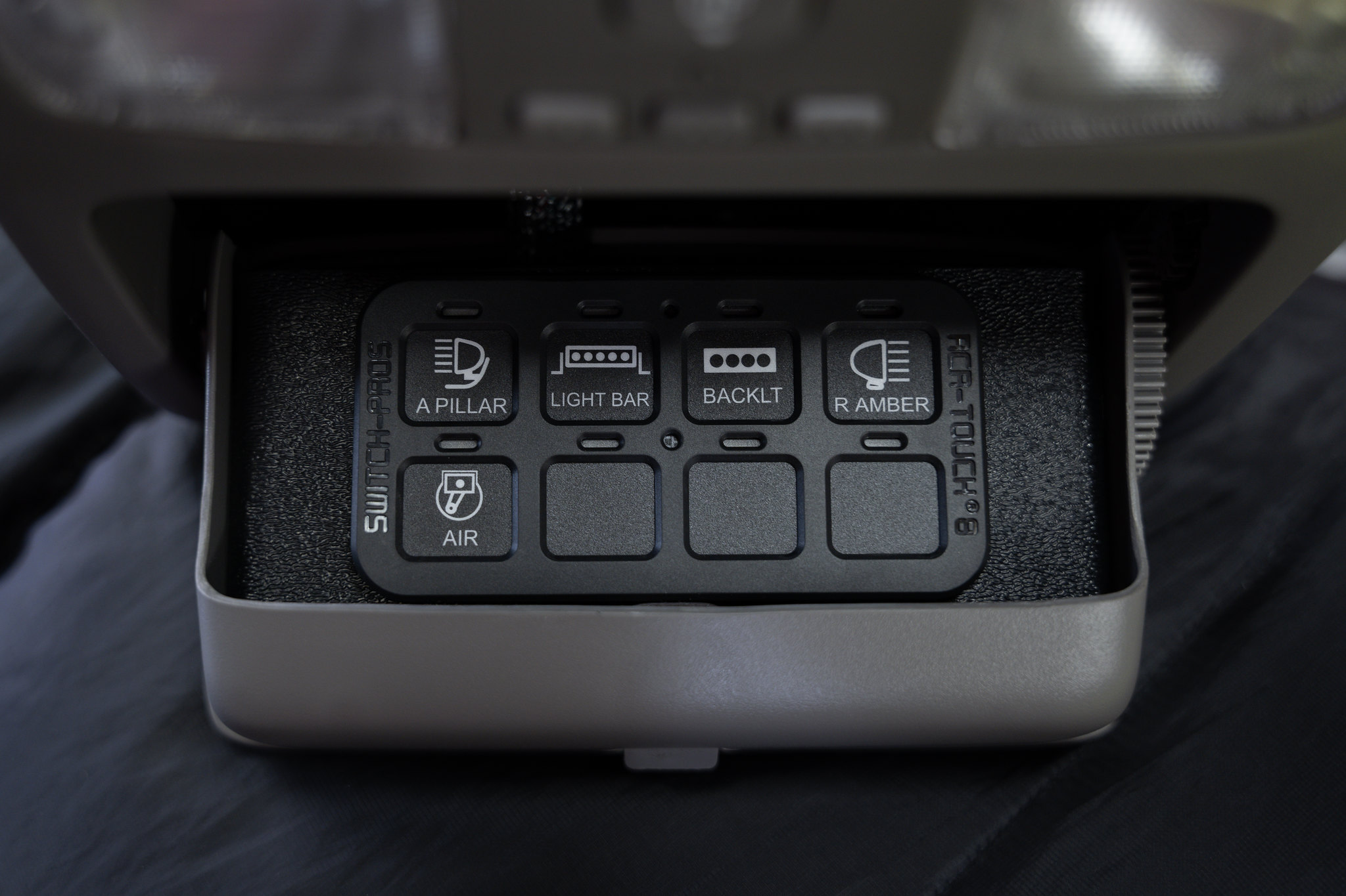

Decided to go with a stealth placement of the Switch-Pros panel and put it inside the overhead sunglass holder. My friend and I created a custom mount from ABS for the panel which came out better than I expected. Love this location as it's hidden when not being used, but also very easily reached when needed.
Happy with how clean everything turned out and should make adding additional accessories down the road much nicer.

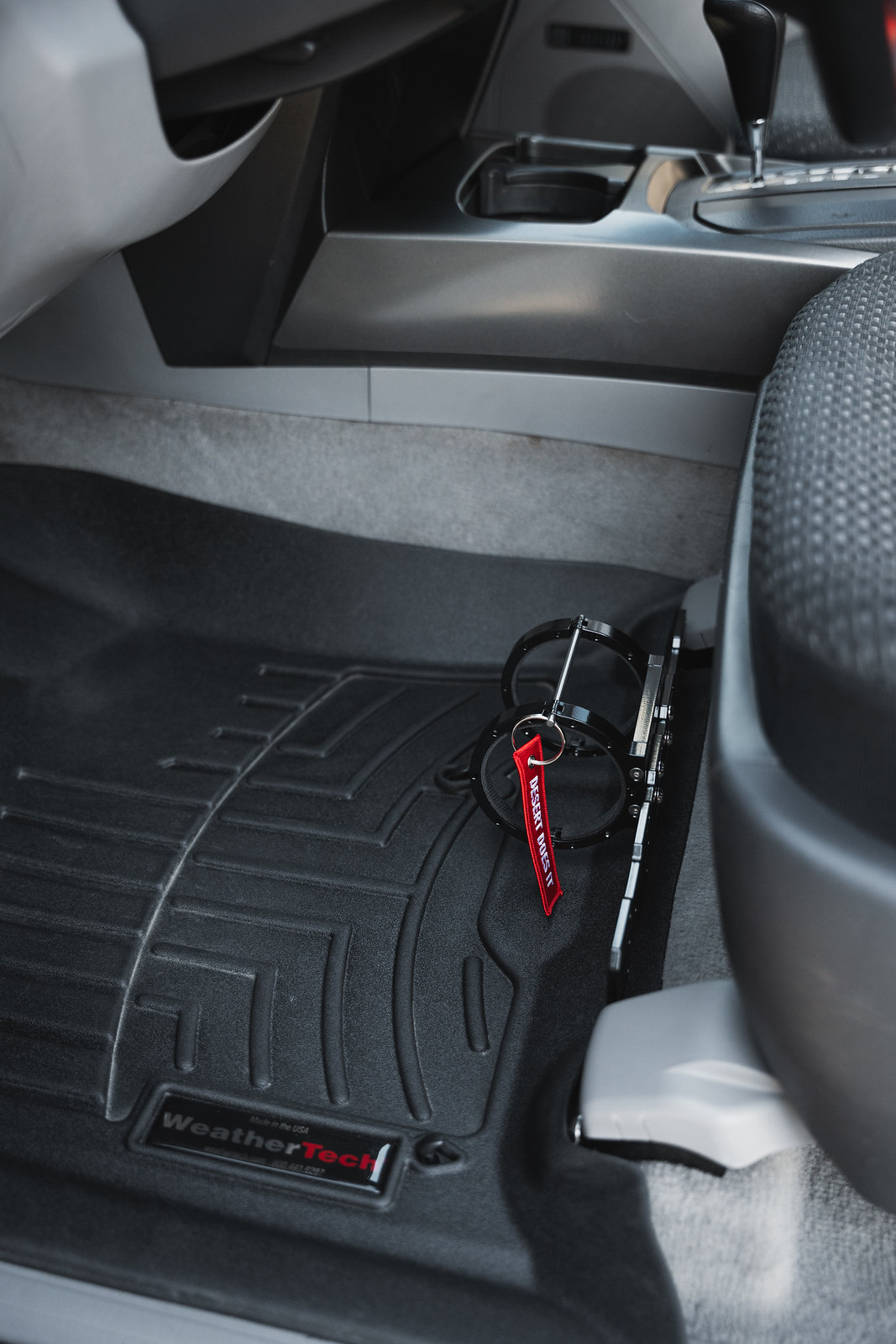

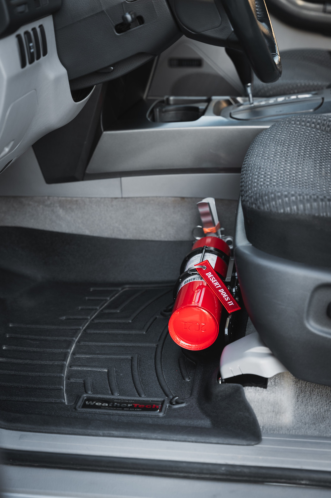

Put in the Desert Does It fire extinguisher mount since I already had their seat jackers. I was worried the footwell might feel cramped with it mounted there, but my feet haven't touched it once and I don't even notice it's there anymore.

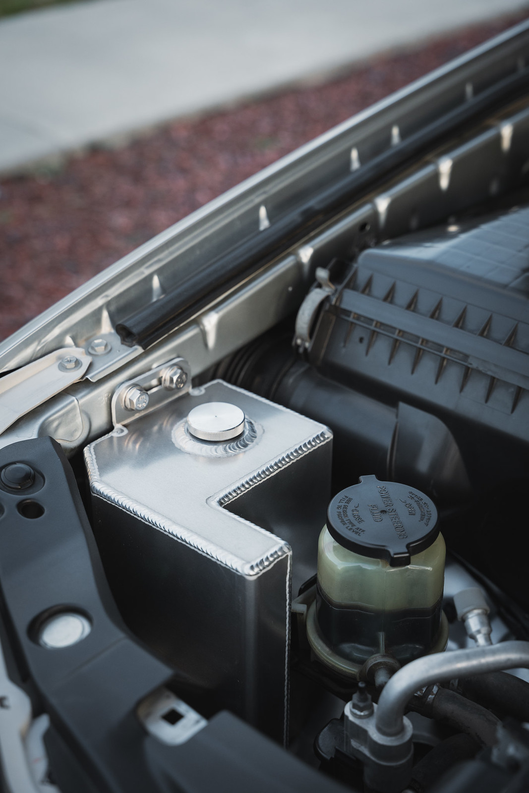

After that I threw in the Snowbound Customs windshield wiper fluid tank to. Held out on doing the fluid tank for a long time because the price is kind of crazy, but they ended up running a sale so I had to pull the trigger. The build quality and welds are top notch, and it holds a good amount of fluid compared to the smaller plastic tanks commonly used.
