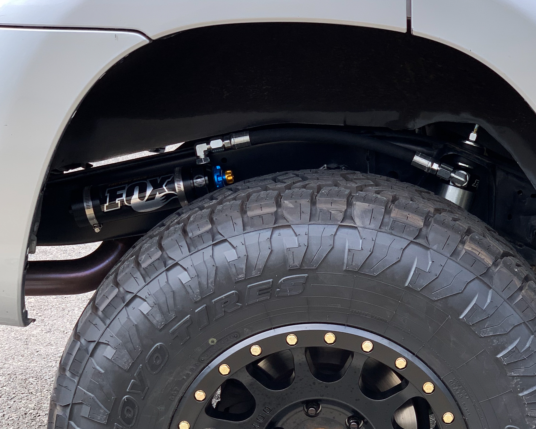

Fox 2.5 Ext. Travel Coilovers w/ DSC
Eibach 14" x 650lb Springs
Front Sway Bar Removed
Eimkeith Panhard Correction Kit
Fox 2.5 "Tundra Spec" Rear Shocks w/ DSC

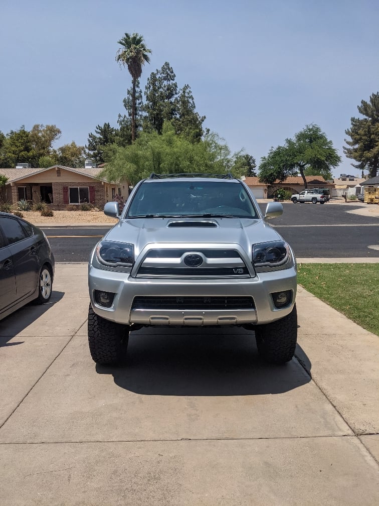

After what felt like it would be a never ending search, I finally found a 4th Gen that met the requirements I was looking for. I put up a WTB ad here as a last ditch effort and to my surprise it worked. Seller was in Arizona, so I jumped on a plane and drove it back to California. This is the first Toyota I've owned after many years of looking, and I'm definitely drinking the kool-aid now.
First photo after taking ownership. 2006 V8 Sport Edition 4WD with 99K on the clock.

Suspension, wheels, and tires on. After running into the typical unplanned stuff along the way, I decided to call it there for the weekend. This is before the Dobinsons rear coils went in and with almost no preload added to the coilovers.

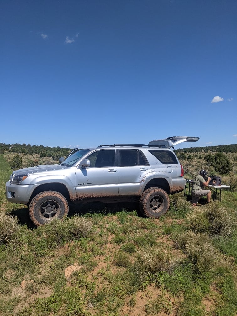

First shake down trip after the suspension install was Mojave Road. Got in some solid dirt miles over the course of a day and a half, and there were a lot of cool things to stop and check out along the way. I'd really like to run this route again to explore the area more... Next time I won't be detailing the undercarriage right before the trip though. Couple murky water crossings and some muddy streams quickly undid my work lol.
It was insanely windy the weekend we ran it, so between that and all the driving not many photos were taken unfortunately.
