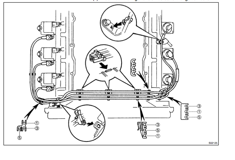

Sparkplugs and wires took longer than expected. I ripped the old wires off and threw them out. So when i did the plugs and was ready to put wires back on, i had no idea the order, but thanks to thegreenmonster we talked and figured out the setup (Pic attached), And boy is this thing quick now, i had a hesitation under load before doing the plugs due to trying to change only the plugs 4 months ago and not having the wires and the current wires breaking, so i was running on an occasional misfire, but now it is really nice and has really good acceleration.
From what i have gathered (dont hold me to it) the cylinder numbers are:
(dashboard)
5 6
3 4
1 2
(Radiator)
