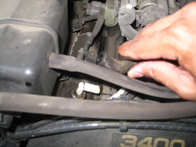

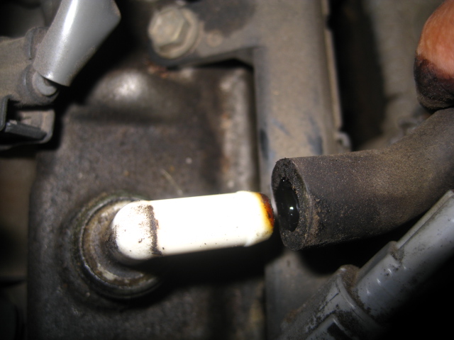

Just to make sure, is this the PCV hose?

Be sure to go slow with the seafoam, it can hydrolock the engine if you pour it in too fast. especially through the PCV.
Just pour slowly and have a buddy work the throttle if he needs to to keep it running. The chances aren't high, I think you should do it. Plugs and wires? Fuel filter?
