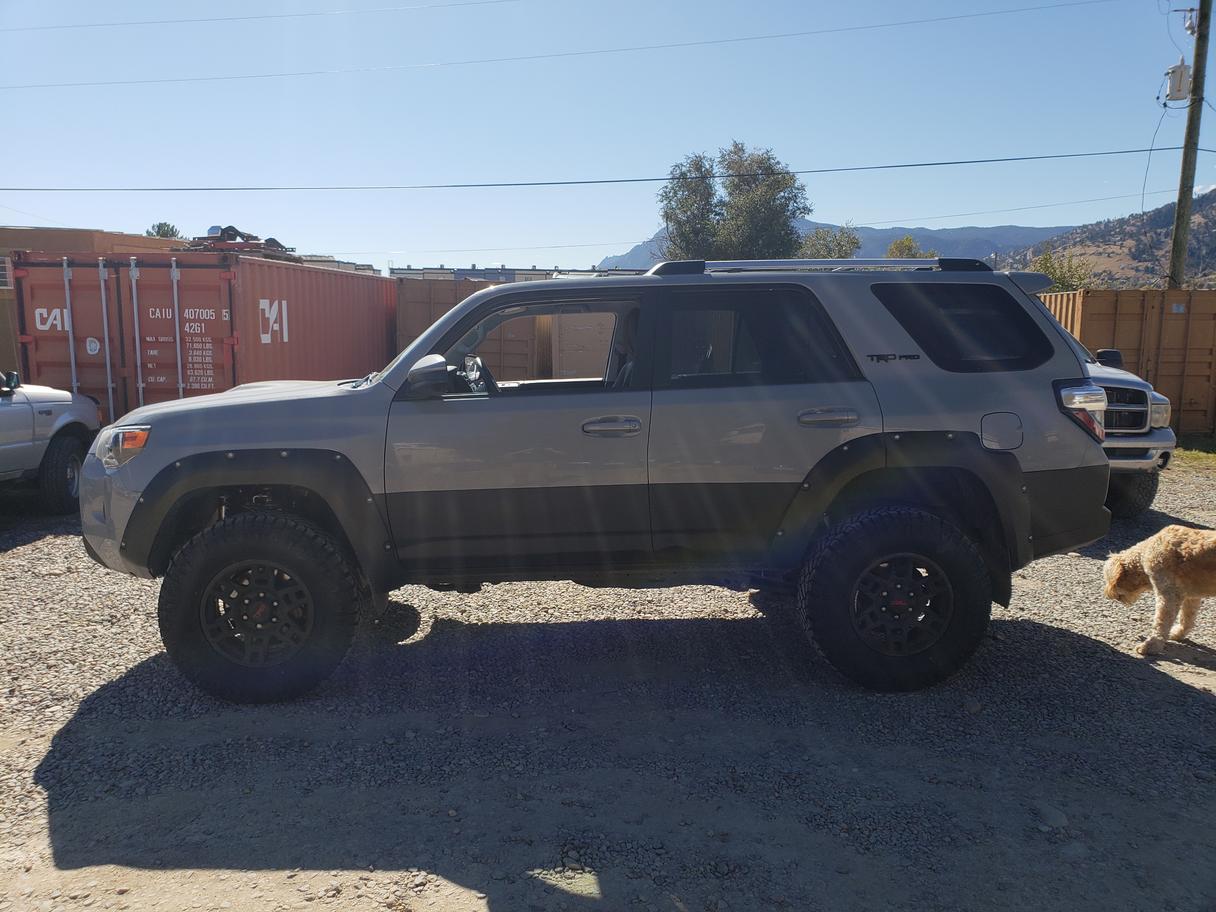

Here's 285 70 ridge grapplers with a 0-3 fox lift set to probably around 2.25". No rubbing but starts to get close to the sway bar...was thinking about 285 75 but pretty sure those would rub on the sway bar.

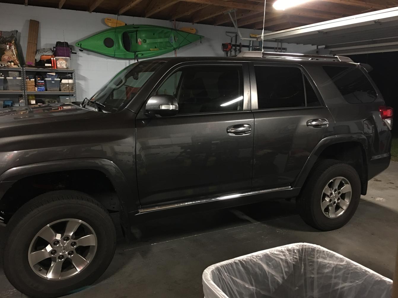

Here are some pics of my stance and height now.
I’ve done a lot reading through the stickies and other posted here as well as comparing the different tire sizes and wheel offsets with the online calculators. I’m leaning toward the 275s based on the comments here, but I think I’ll have someone drive it for me and move the steering through it’s ranfe of motion to make sure I don’t have more or less space than I think. I think the real question is how the new tires with full tread compares to the current ones and only trying them on will answer that. Maybe I’ll try 285s and take out the spacers if I can’t solve the rubbing. Thanks for all your ideas!
