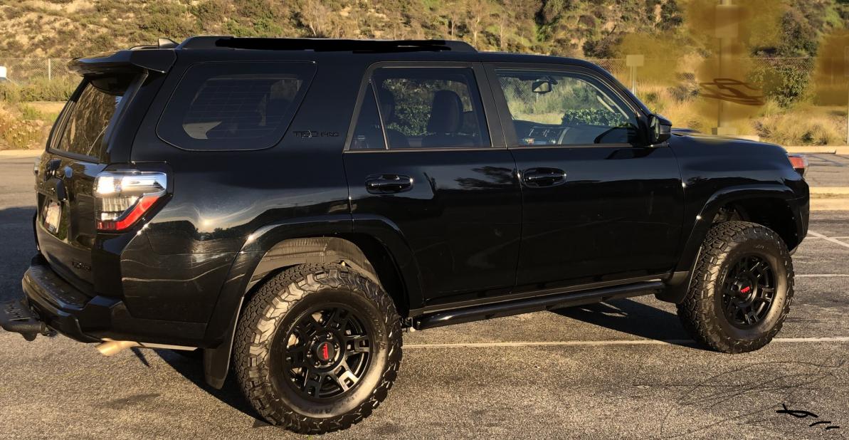

Just curious, are you on a dirt road and wearing a suit? That's impressive!
Good eye! It was a sport coat, but close enough! I work at a Toyota Dealership.
Not quite a dirt road, but a construction site in my neighborhood. I've use this spot a few times now to check clearances with the lift, bigger tires, and to do some front bumper trimming.
Took it to the same spot yesterday to do some more front bumper trimming, but not in a suit this time lol

Nice! I was going to say, I wish I had to go off-road to get to work.

I love the looks those tires and I am due for a new set pretty soon. Currently 285/70/17 RG- C load.
My 4R is not my DD, but I do drive long highway stretches (4+ hour each way) to get to my trails and camp spots. How loud are those things on road?

I've never had a MT before, so I don't have much to compare to except for buddies trucks in the past.
If I had to compare to the loudest tire I've heard and call that a volume level 10, and my Nitto Terra Grapp's I had being at a volume level 1, I'd rate these Geolandars at a 3 or a 4. You can for sure hear them, but they are not annoying. At 50 mph+, between the wind noise, exhaust, and the radio at a very low volume, you literally cant hear them at all.

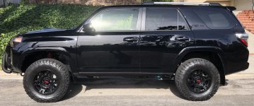

I have ‘18 TRD pro Bilstein, stock UCA, TRD wheels and 285’s ridge grapplers. Caster and stock was fine. I could not get back to Oem camber. I’m off a few degree +. But I plan to install JBA UCA soon. O always get an alignment after the CF spacers.
Lift measurements?

Sure no problem! I got my 275s put on yesterday so I'll try to get out there and measure them this weekend. You just want from the top of the tire to bottom of fender?

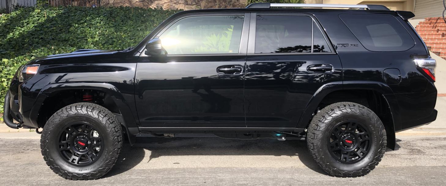

Honestly I wouldn't worry about it at all. I ran spacers on my 2006 SR5 for like 8 years and never had a single issue. However, on my 2006 SR5 I did notice that the ride got a lot stiffer, I had more body lean, etc. Overall I sacrificed ride quality but it looked a lot better so it was worth it to me. On my TRD Pro that is not the case whatsoever. I didn't notice a single change in ride quality, body lean, etc. It drives exactly the same so I wouldn't worry about it. However, I only did 1.5" in the front and 1" in the rear to give me a total of 2.5/1 because of the TRD Pro 1" already. My 2006 was 3/2 with a 1" body lift so the springs were compressed more which probably contributed to the change in ride quality. As long as you don't put huge spacers in there I wouldn't worry about the ride quality or issues with parts.
Here's an updated photo with 4 of the same sized tires lol. I love how this sits now!
