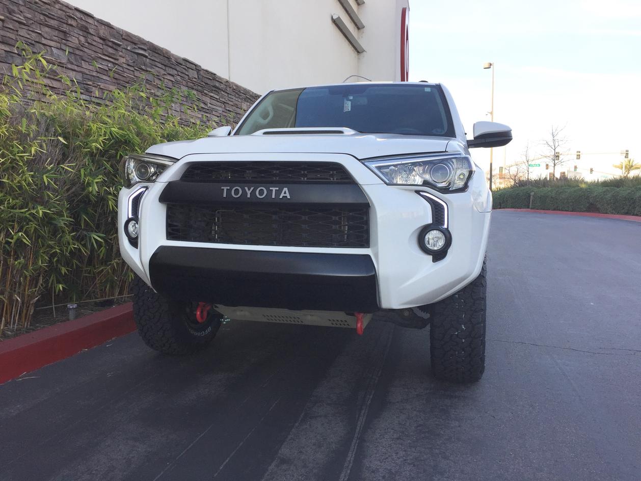

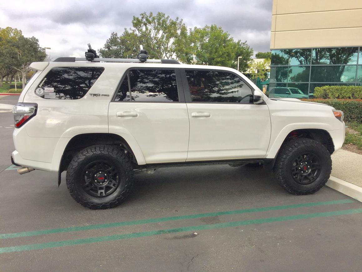

I know there's been a ton of talk about mild lift options for the TRD Pro without giving up the suspension. I did a lot of research and considered doing the 2/2, Toytec, etc. In the end I had Jason Burtman at Burtman Industries make a 1.5/1 spacer lift which I think turned out perfectly. I also threw on some 275/70/17 BFG AT KO2s. There isn't any rubbing and I didn't have to do fender liner mod, cutting or anything else to make them fit.
I think the truck now sits perfect for an everyday vehicle, looks much more aggressive than stock, and also gives me a bit better clearance/approach angles for when I'm out on the dirt.
There is absolutely no change in ride quality, body lean, etc. from the stock setup which was a concern of mine since I really do like how it drives stock. It's a tiny bit bumpier (I'm sure because they are now LT tires) but it's so minimal that it doesn't really make a difference. If you're on the fence about what to do, I think this is a great option.

I was wondering if someone was going to try some of Jasons other options for the TRDP. Thanks for posting up the pics, looks awesome and sounds like the ride is not compromised either. I'm still pondering the toytec 2" or a 2/1.5 from Jason. The C rated Nitto RG I want are 32.76" yours are 32.2" so not a huge difference. Now there is your setup to consider, I'm guessing you went 275 to eliminate the possibility of rubbing? Have you flexed this setup and checked clearances?
Thanks guys! I think with the extra 0.5" (1.5/1) in the front there is still a tiny bit of a rake but i wouldn't say it's noticeable unless you're hypercritical like all of us probably are. 2/1 would probably result in a reverse rake and I think just an all around 2 would still have it. The 2/1.5 would probably work great for your tire setup.
It was just done yesterday so I haven't had a chance to check clearance and flexing yet. I'll update once I get the chance to!

What were the physical sizes of your spacers? .75"F and 1"R?

I personally like a little bit of rake like your setup has
I didn't actually measure them but I think that's correct.

Thanks! I like it too. It's pretty subtle and is pretty close to level so I'm happy with the spacer sizes I chose.
