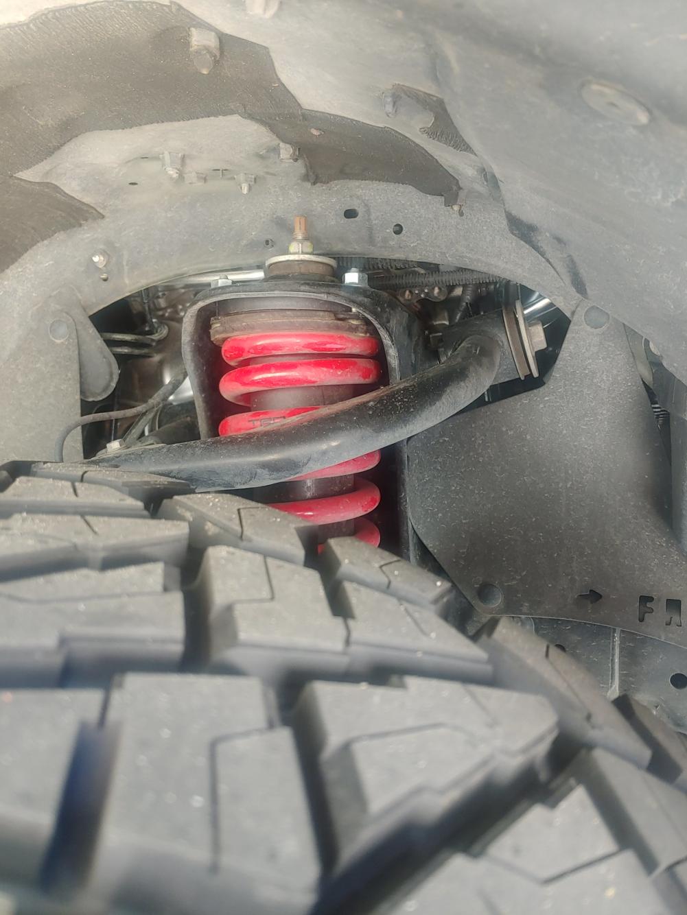

yes. you'll need to exclude the rubber spring pad as i did in this picture :)
Yes I did the same.
Question though..... What if we left this rubber insulator was left on? What would it hurt?
I notice I can feel a little more feedback in the steering wheel from small imperfections in the road now that the rubber is removed and spacers are installed. Not bad, but noticeable.
Just curious is all
I’m not sure if would hurt anything. If anything, it would just get smashed between the spring and spacer. I believe it’s initial purpose was to dampen any spring to top hat metal to metal noise. But since the spacer is a like plastic material, there would be no metal to metal contact. But according to Jason, the CF spacers were designed without that rubber piece in place.
Correct. It really won't hurt anything if you leave it in, but it can kinda look like a used condom :) I didn't say that, a customer did that forget to remove it when installed the spacers, lol. The spacers are designed to make up for the space of that isolator. It's not longer needed with the lift kit install :)
