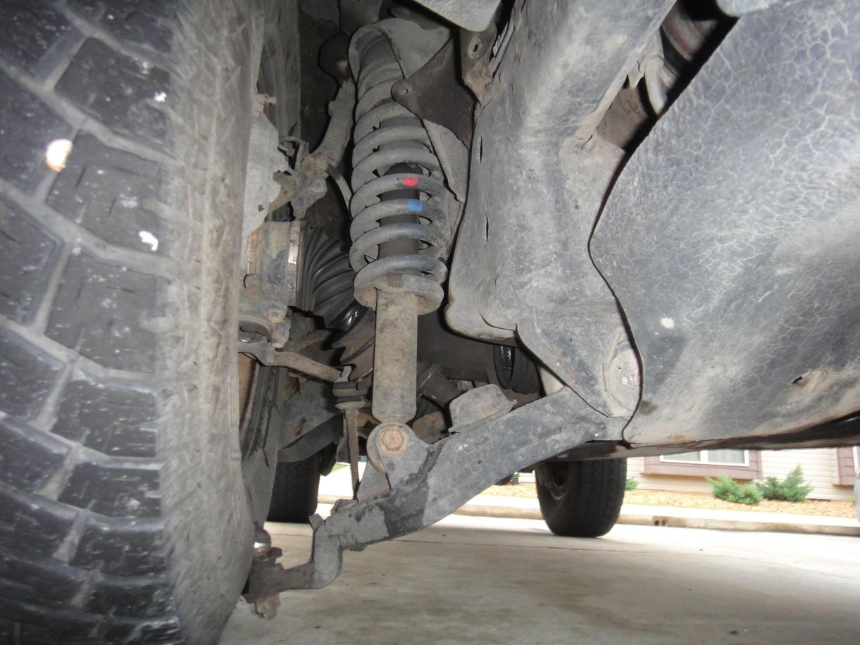

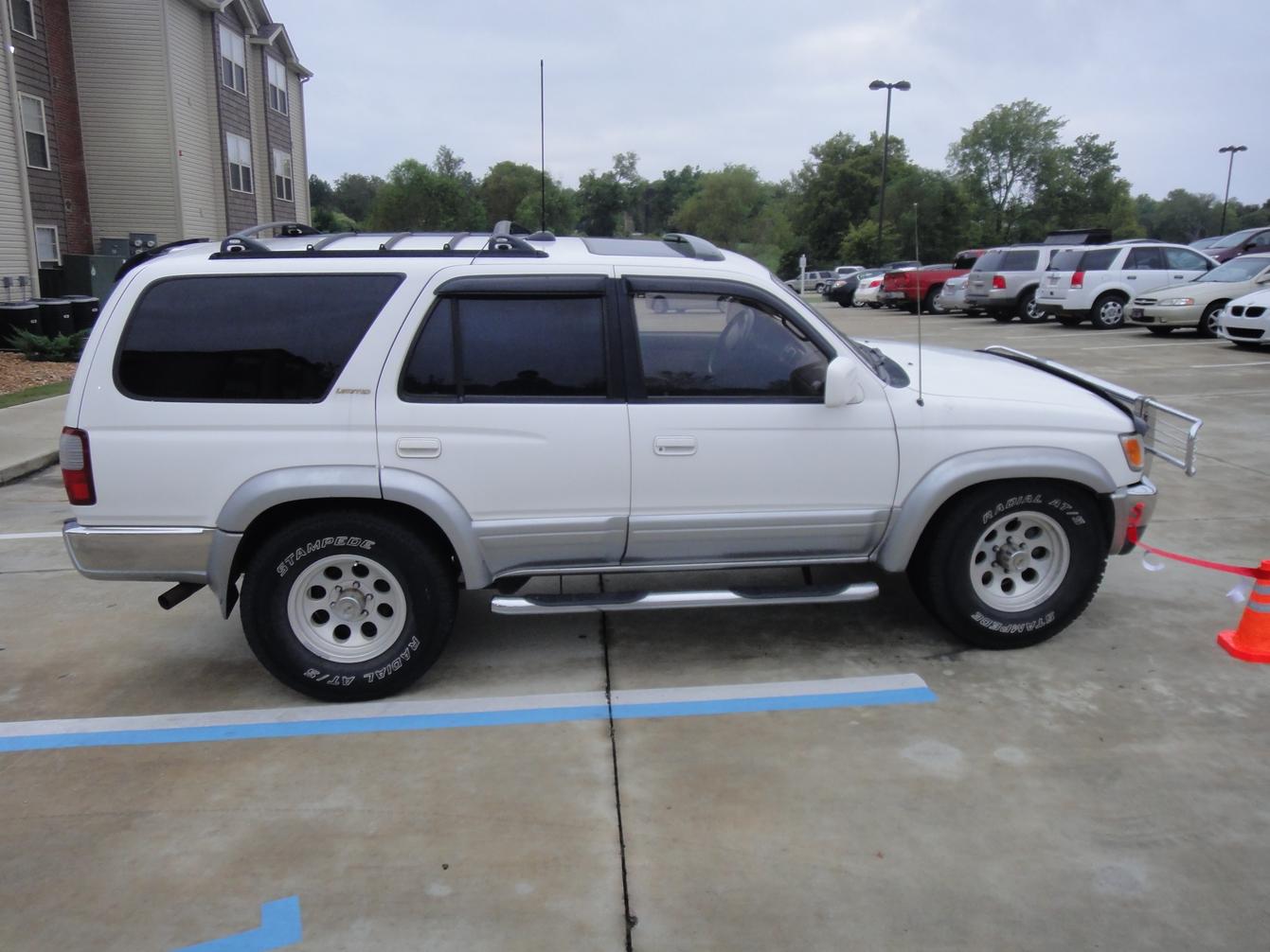

So a little over a week ago I am backing into a parking space at my apartment after a full day of Engineering class followed by work. As I am easing back I hear this clunk and the passenger side of my '96 T4R drops. Immediately stood on the brakes, threw the truck in park, and set the parking brake. Got out and this is what greeted me when I got around to the passenger side.
I got really lucky that it didn't fail as I was driving, because the road I have to drive from School to my apartment is not very level and has no shoulders. So I probably would have rolled the T4R if I had been on that road.
Now, all of the shops in town close at 5:30pm and I didn't finish assessing the damage until 5:35pm, so no chance of getting it in the shop that night. Since there are a couple of real yahoos that live in the same apartment complex and my truck is not actually all the way in the parking space. So, when my roommate got home I bummed a ride to the store to get a couple of cones and some reflective tape in a effort to make my truck more visible.
Next day I had class until noon so I wasn't able to call AAA for a wrecker until after I got out of class. One and a half hours later the wrecker shows up, driver gets out, takes one look at the truck. Looks at me and says "They didn't tell me it was a broken ball joint." I replied "I don't know why not, I told them it was a broken ball joint." His reply was "Well, my truck can't tow a vehicle with a broken ball joint, I don't have the equipment."
So he left. AAA called back about 30 minutes later to tell me another tow truck was on it's way. Tow truck arrives, driver gets out and says "They didn't tell me it was a broken ball joint." My reply was "Well I told them it was a broken ball joint, and you're the second person they haven't told." Luckily he had a flatbed so we were able to load it and get it to the shop, after about an hour or two of lining up the T4R and the tow truck.
Shop response:
Replace ball joints
Replace CV Axles (broke when the ball joint failed)
Replace tie rods (bent when ball joint failed)
Replace rack & pinion bushings (looks like you tear these up replacing the tie rods)
Replace struts (apparently the struts were installed by Toyota at the factory. aka: Original parts. wow)
Est. Cost: about $2400
I'll have to see how close the estimate was to actual cost.

Prices from dealership....
Lower Ball Joints: $150/piece
CV Axles: $100/piece
Inner Tie Rods: $80/piece
Outer Tie Rods: $180/piece
Rack & Pinion Bushings: $25 kit
Struts: up to you
Est. Cost: Under $1500 depending on your front struts and if you do by yourself. That's both sides. Cut it in half for only one side.
Sure beats the hell out of $2400. If you claim it under insurance though you might just have to pay a deductible. But then it goes on the insurance and you pay for it in the long run anyways.

Shop called to tell me they were finished. Final cost was just a touch under $2200. First time I've ever had a repair cost less than the estimate, but I'm not complaining.
It's still going to strain my finances a lot, just not quite as much as I was expecting. Here's hoping nothing else breaks
