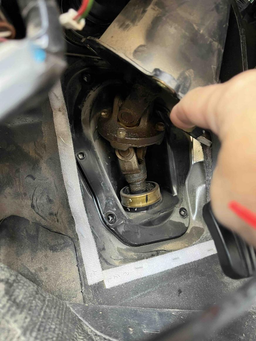

So after years of looking for answers on why my steering was stiff. people all just recommend cleaning the PS screen or replacing ball joints/tie rods ive never seen anyone mentioned this fix.
The knuckle behind the peddles that's covered by a plastic cover. I honestly didn't even know something was back there and ive replaced the rack and everything. Just somehow slipped my mind. I first sprayed something on it to test and when that worked I added bunch of synthetic grease.
Well it's 100% better than it was, no more hesitation or stiffer when I turn right it's just smooth across the whole wheel turn. There is no Zerks that I could find so just used fingers and small flat head to get the greese in and Turing the wheel over and over worked it inside.

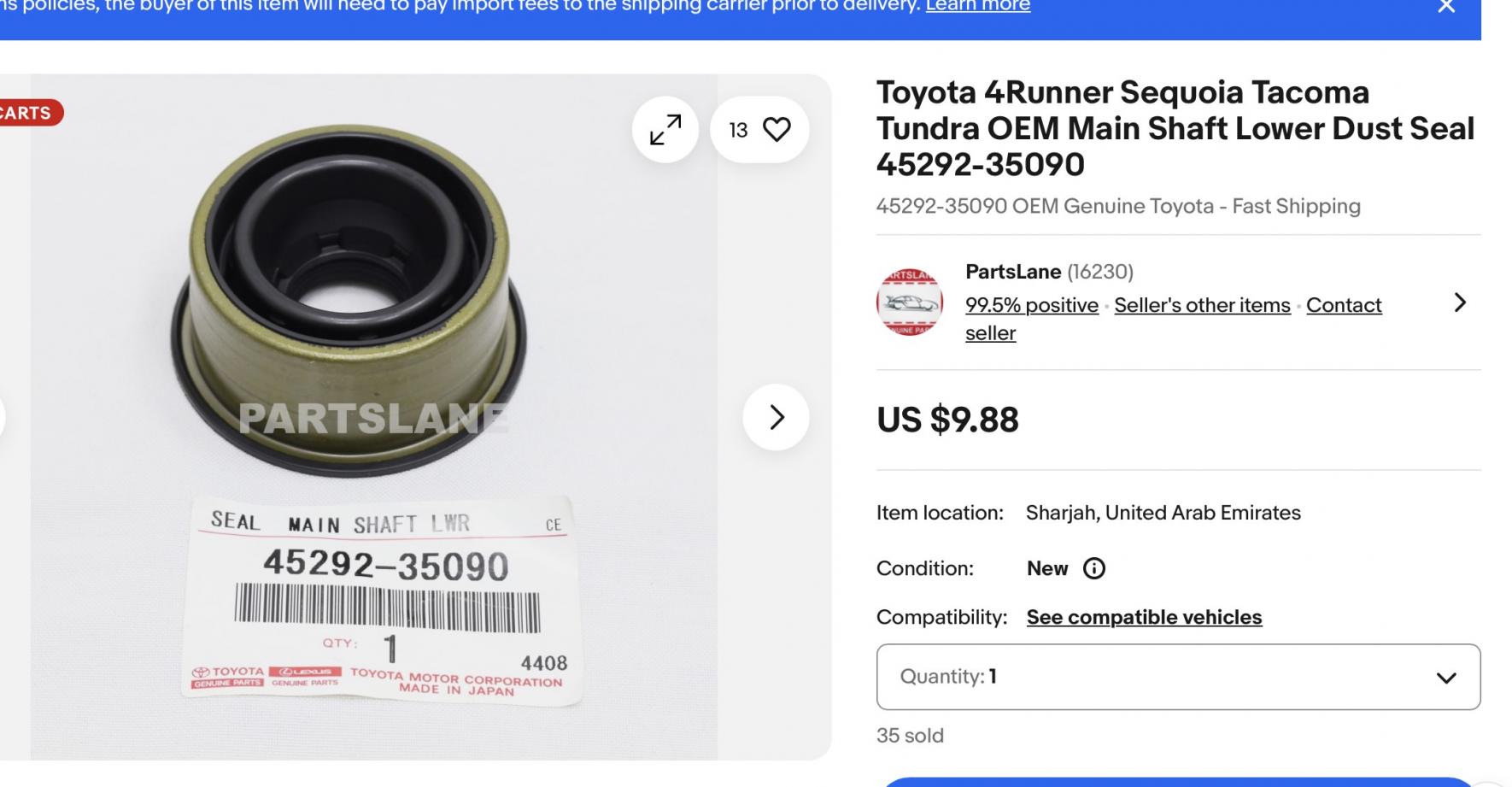

Also it appears there is supposed to be some kinda dust seal below this knuckle. Looks like this is the part. Will be kinda a pain to replace since Id have to remove the shaft but I'll order one for when I get around to it.

There's an internal swivel joint between the two U joints. Ideally due to the age of these trucks, it should be disassembled and greased. Apparently there is a replacement U joint off a Kawasaki quad or similar that is a replacement part. It is also greasable. I'm currently replacing my existing unit with a used one as it is completely shot and causing serious clunking over bumps.
