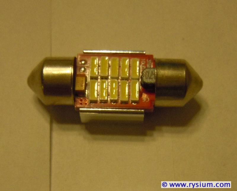

Dome light is quite tricky: I wanted to go with the large light output as I could, but to much light is actually not good for driving at night when someone on the back sit decide to turn the dome light on. So I decided to go for 3110-W10-CB from superbrightleds.
Actually it is very well designed and made bulb. I has "buck" type driver powering ten high efficiency 4014 Luxeon LEDs. It has CANBUS resistor (which I don't care about anyway) and aluminum heat sink to get rid of some heat. The light output is about 100 lumens which looks OK inside the cab. I wish they could have the version without the CANBUS resistor.

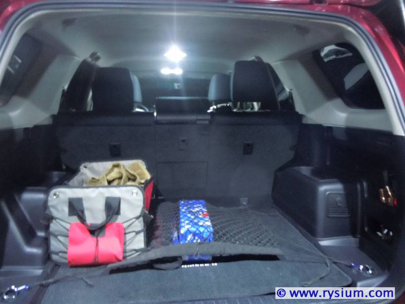

On the other hand the tailgate lights should be as bright as possible. Original incandescent bulbs don't light much inside the cargo space, so here I went "bananas". I bought quite expensive "9w Cree LED 31mm Canbus No Error Festoon License Plate Interior Map White Lights" by SiriusLED on Amazon. Here is the picture of this bulb
I have decided to spend 9 dollars per bulb because they used high output LEDs rated at 3W each (max at 1A). However the bulb circuit design i very poor. It contains 47 ohm resistor in series with 3 LEDs and one diode (reverse current protection). The actual power run through LEDS was about 0.5W (not 9W) and the true light output is only 80 lumens. Not much for 9 dollars bulb. But I knew I could do much better. I bought NSI50350AST3G (350mA constant current driver) for 60 cents from DigiKey and installed it instead of 47 ohm resistor. I have removed also CANBUS resistors to make room for this IC. I have also removed plastic from each end of the bulb (it was melting from the heat) and replaced it with epoxy. This is how it looks the "big ass DE3175" bulb (Picture taken before replacing plastic ends):
Now I have true 3W bulb with light output 480 lumens - that is equivalent of 30W incandescent bulb. Big improvement from the original 5W bulb. Now the cargo space is well lit just by tailgate lights alone.

Cargo light is easy, just need know how to operate soldering iron (or know someone who has this skill :dance:).
1. Get pair of "9w Cree LED 31mm Canbus No Error Festoon License Plate Interior Map White Lights" by SiriusLED for 18 bucks for two on Amazon (I am not affiliated and if you find this thing cheaper let us 4Runners know) and two NSI50350AST3G (60 cents each on Digikey for example) and a piece of insulated wire (high temp insulation preferred).
2. Heat both contacts with soldering iron, remove the contacts and plastic tubes holding the metal in place (this piece needs to be replaced as it becomes very soft when LED is hot and can cause a short).
3. Desolder both CANBUS resistors (on the opposite side of the LED) and current limiting resistor (next to LEDs).
4. Cut one track on the opposite side of LED (you can see which one on my pictures).
5. Solder NSI50350AST3G in place of removed CANBUS resistors
6. Solder connecting piece of wire between both sides of the board (as shown on my pictures)
7. Solder back both contacts (removed in step 2) and fill both caps with few drops of epoxy or high temperature silicon (gasket maker for example).
All takes less than 30 minutes and less than 10 dollars per bulb. I wish the original factory in China designed this bulb in the first place so everybody could enjoy it.
