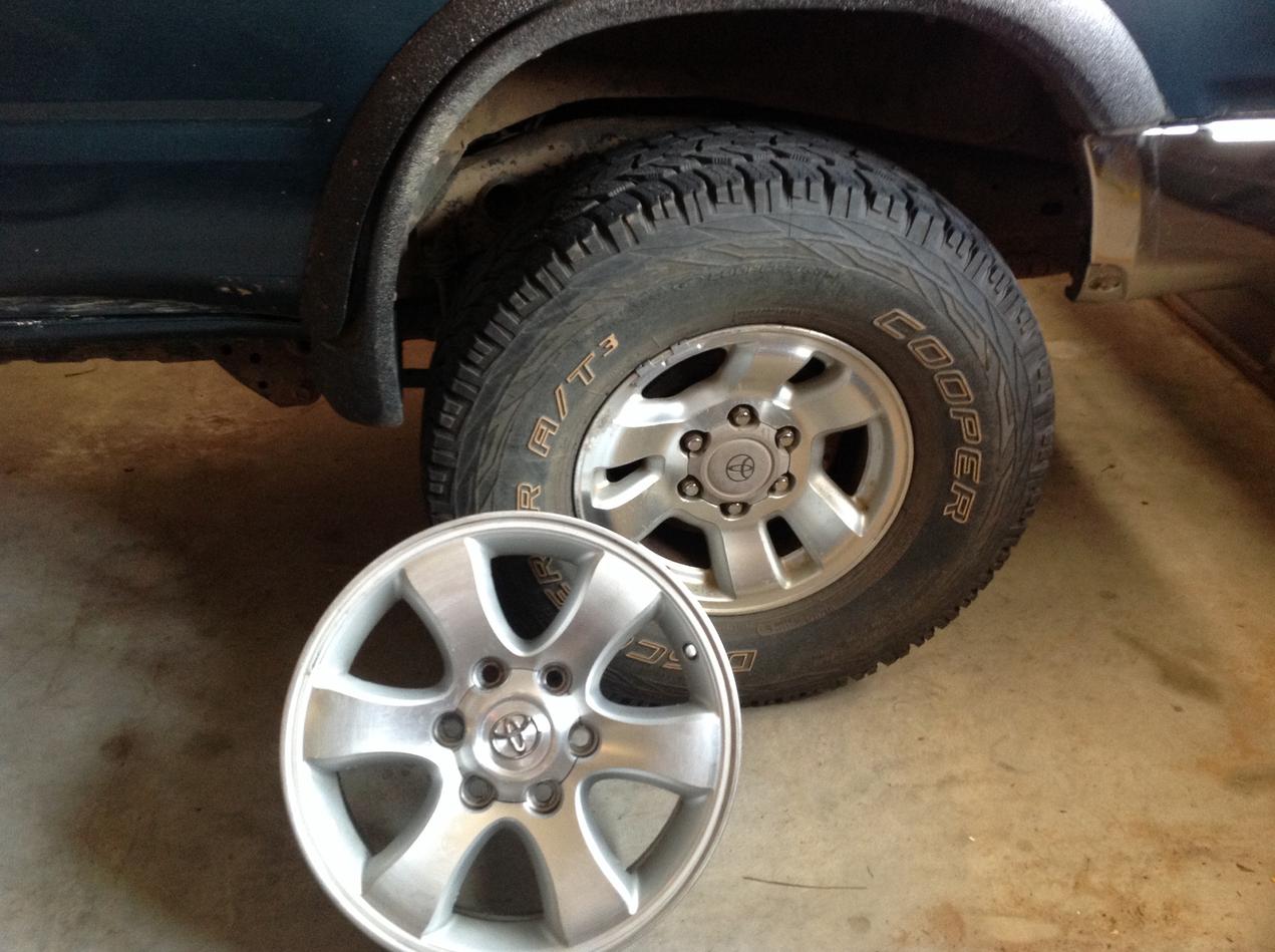

Currently I have the original 16" wheels on my runner . I was practically giving 5 4th gen 17" sport wheels not too long ago and was considering having them powder coated black. Now here's my issue, I will have to run spacers on these to stop them from rubbing due to the backspacing being 5.5, so that adds another $50 per wheel, plus thethe $60 each in powered coating. So that's $110 invested in each wheel. Would you take this route or find an aftermarket wheel within that price range? I like the wheels, and think they would look good, but when I started adding it all up, I don't think I'm saving much $ on my practically free wheels.

I like the 3rd gens better plus don't you have to invest in 17" tires also? I think you'd be better of with aftermarket. You'd probably find the exact style you want. Then sell both sets of old rims and make some money back.

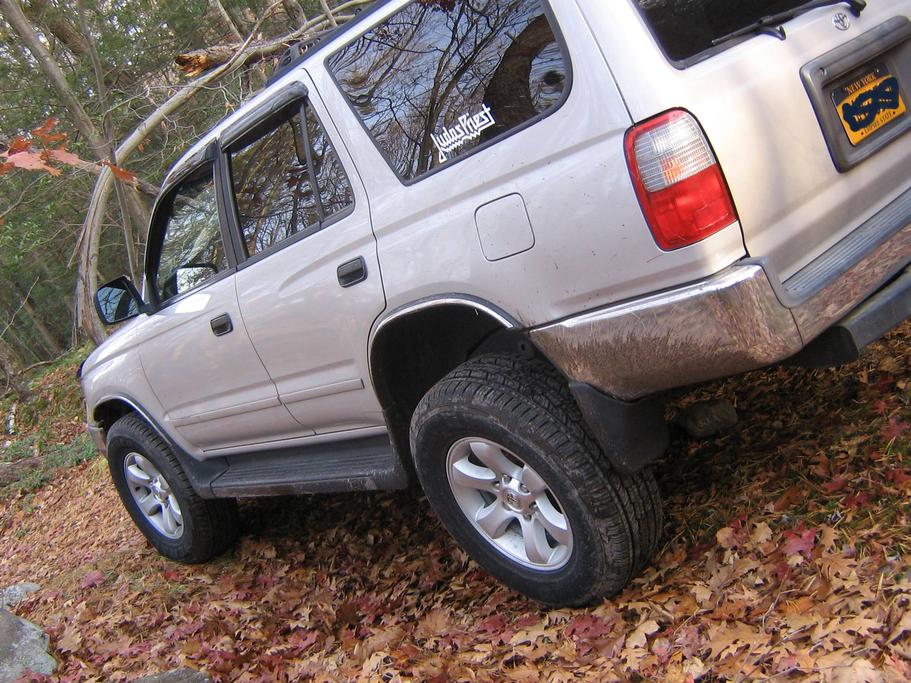

Those wheels are hot, keep them silver. I had to run spacers & added longer wheel studs because our front ones are short. You got to pay to play.
This is an old pic before my lift.

[MENTION=7105]Scramble[/MENTION] - Can you give us some details on the longer studs you went with? I'm thinking about that. Did you swap in studs from the rear of the 4Runner (I've heard they are long enough for a small spacer), or did you buy aftermarket? Which ones and how much longer? How large of a spacer?
Also, what did you need to do to swap out the studs? Just bring it to a shop or...?

I bought the ARP wheel studs for Lexus. They're expensive but they're the best. They only come in one length so I cut mine down. You can use open ended lug nuts if you want but these are really long.
Amazon.com: ARP 1007715 Wheel Stud Kit for Lexus: Automotive
The rear studs don't fit, the knurl dia. is different ( i know efn retarded)
My mechanic put them in while I was getting my wheels mounted & balanced. An air chisel will get them out & you can pull the new ones in with some washers & a lug nut. He cut the new studs to length on a band saw. This was labor that I had no problem paying for! LOL
I bought 1.5" spacers from Sixity on e-bay, same 6011 Alum as Spidertrax.

It is up to you, but if I were in your situation, I would sell them and get wheels that I loved in the size I wanted with the correct backspacing so that I wouldn't have to use spacers. But I am running 265/75/16s so I can get away with using stock without rubbing issues.
